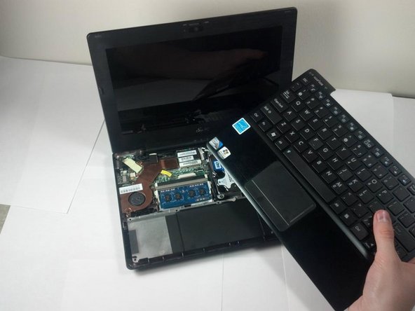

Add Note Edit Step 9  ¶
  • The keyboard can now be removed from the main body of the Asus Eee PC 1018P.
Image #1

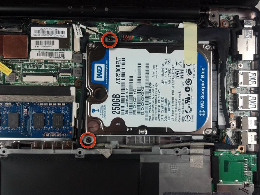

Add Note Edit Step 10 — Hard Drive  ¶
  • Remove the two 4.52 mm Phillips head screws securing the hard drive case to the laptop.

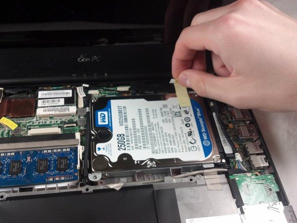

Image #1
Add Note Edit Step 11  ¶
  • Carefully peel off the tape that adheres the black cables to the hard drive. Do not discard the tape.

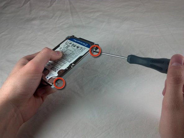

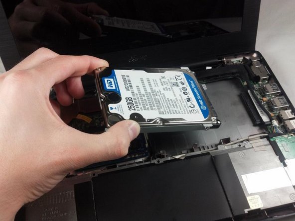

Image #1 Image #2 Image #3

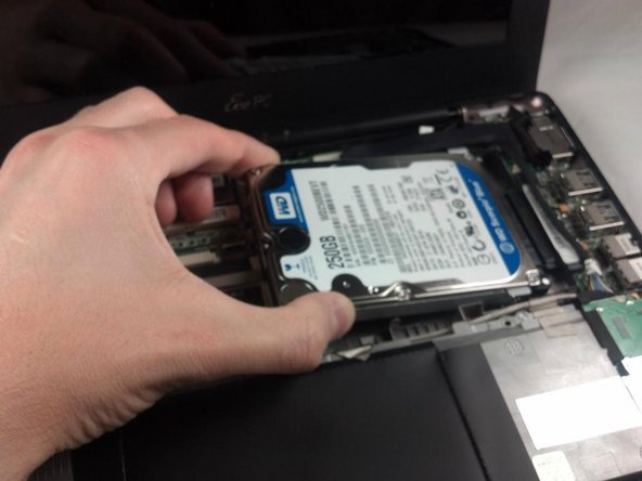

Add Note Edit Step 12  ¶
  • Lift the left side of the hard drive slightly. Gently pull the hard drive to the left in order to free it from the pin connection on the right side.
  • Continue pulling the hard drive until it comes entirely free from the rest of the laptop.
  • Removing the hard drive at too great or too small an angle can cause damage to both the hard drive and the connector to the motherboard.

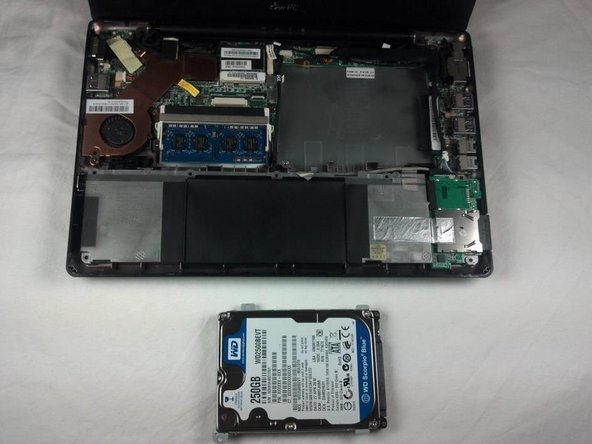

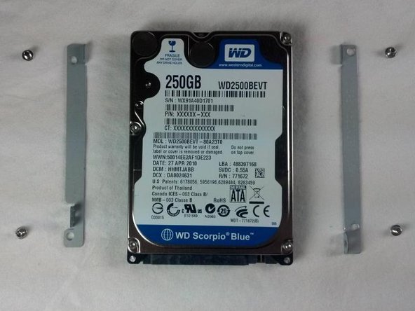

Image #1
Add Note Edit Step 13  ¶
  • Remove the four 3.68 mm screws securing the hard drive case to the hard drive. There are two on each side of the hard drive case.
Image #1
Add Note Edit Step 14  ¶
  • The hard drive is now fully removed and ready to be replaced.
