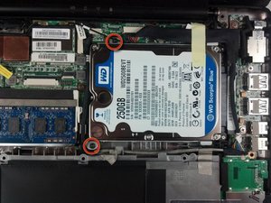

Add Note Edit Step 10 — Hard Drive  ¶
  • Remove the two 4.52 mm Phillips head screws securing the hard drive case to the laptop.
