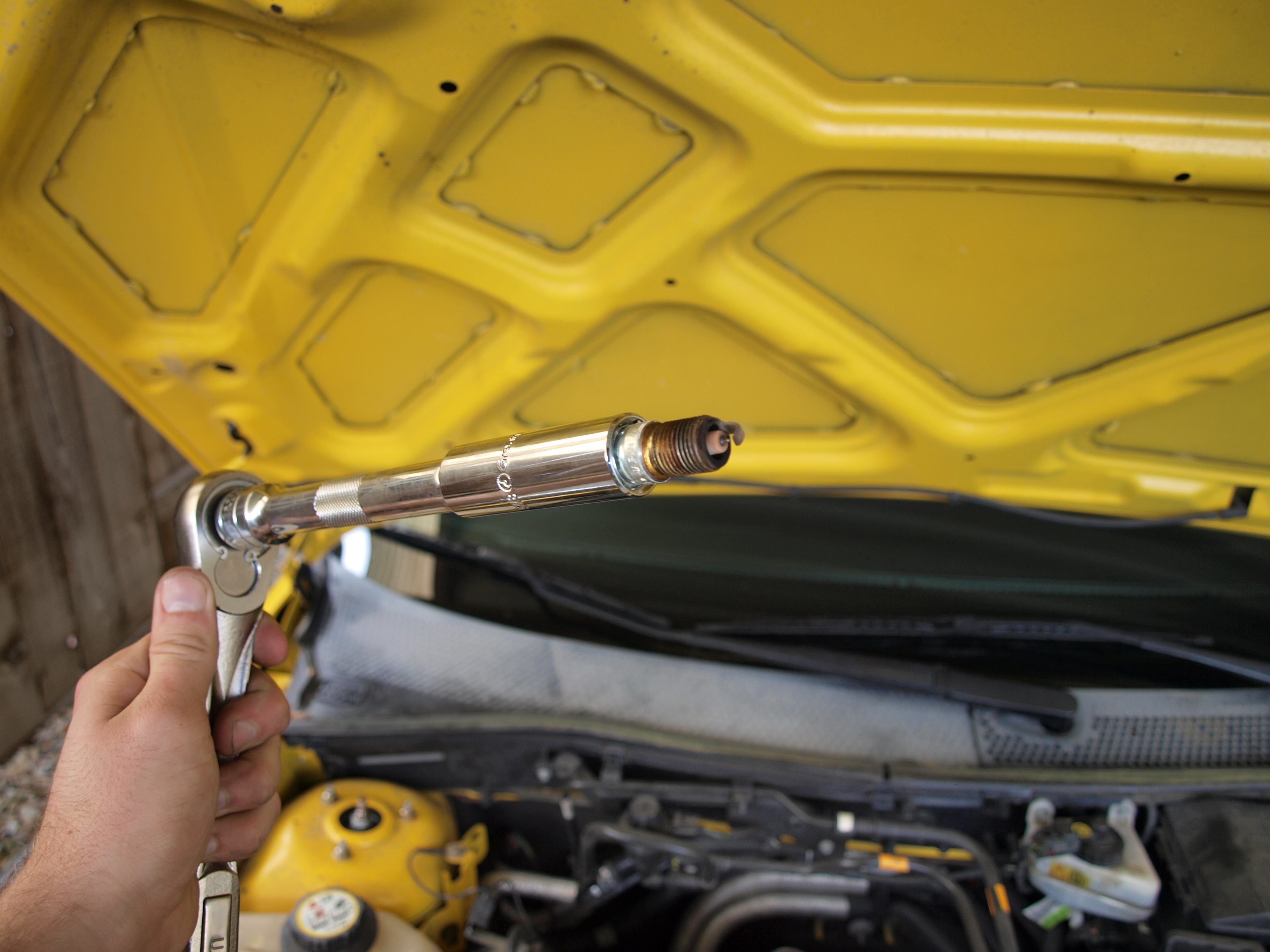

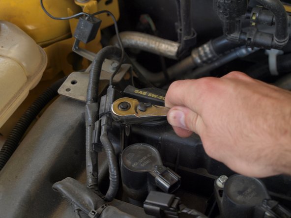

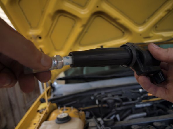

The following guide outlines the procedure for replacing the spark plugs in the 2.0 and 2.3 liter Duratec engines found in 2004-2007 Focus models. Replacement for OEM spark plugs is suggested every 60,000 miles.
For spark plugs that have an adjustable gap between the electrodes, the suggested gap is 0.050". OEM Motorcraft double platinum spark plugs, which are used in this guide, come pre-gapped and cannot be altered.
Use compressed air to clear any debris from the area around the ignition coils on top of the engine.
