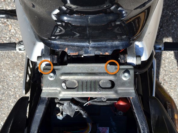

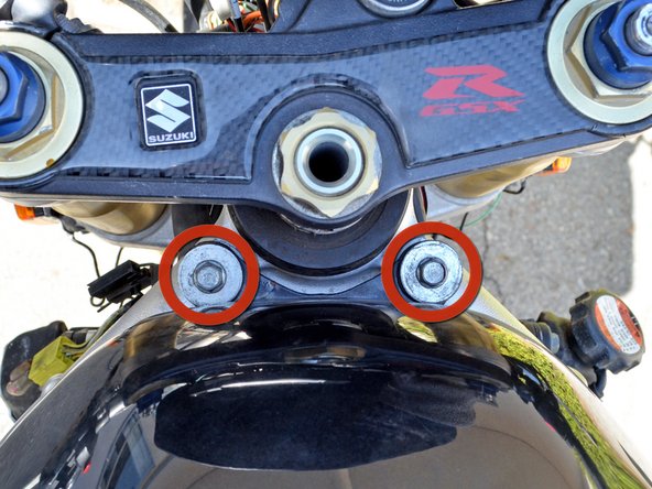

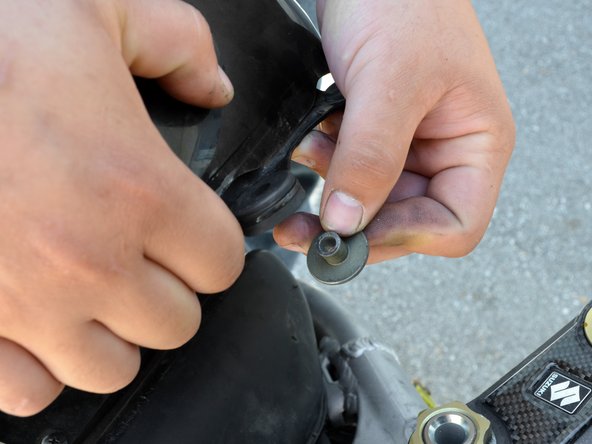

Add Note Edit Step 2 — Tank  ¶
  • Turn the two 4mm allen bolts in the front tank mounts counter-clockwise with an allen wrench until they come out.
    • The bolts shown in the picture are not stock.
  • Turn the two 12mm hex bolts in the tank's hinge base counter-clockwise with a socket wrench or box end wrench until they come out.

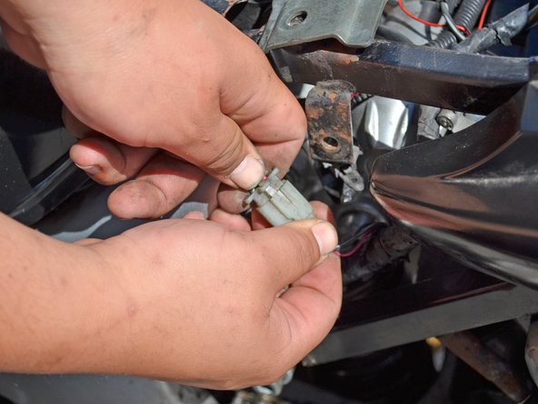

Add Note Edit Step 3  ¶
  • Disconnect the fuel level sensor connector, located near the tank hinge base. It will be a three wire connector and one side of the wire will be traceable to the underside of the tank.
  • Carefully lift the front of the tank to gain access to the hoses attached to the tank.
    • Do not lift the tank too much, or you risk damaging fuel lines, vacuum lines and spilling fuel.
    • There are small metal inserts that go into the front tank mounts. Make sure these do not fall out and get lost while working with the tank.

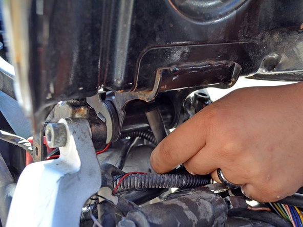

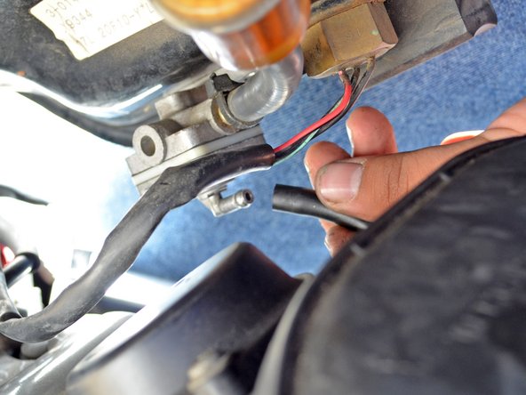

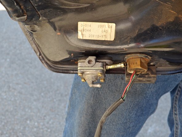

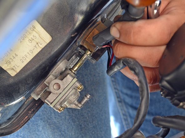

Add Note Edit Step 4  ¶
  • Locate the petcock on the left underside of the tank. It hill have 2 hoses attached to it and will be next to the fuel level sensor.
  • Disconnect the vacuum hose from the petcock.
    • It is advisable to always remove this hose first to reduce the amount of fuel spilled.
  • Disconnect the fuel hose from the petcock
  • Disconnect the tank breather hose from the base of the tank.

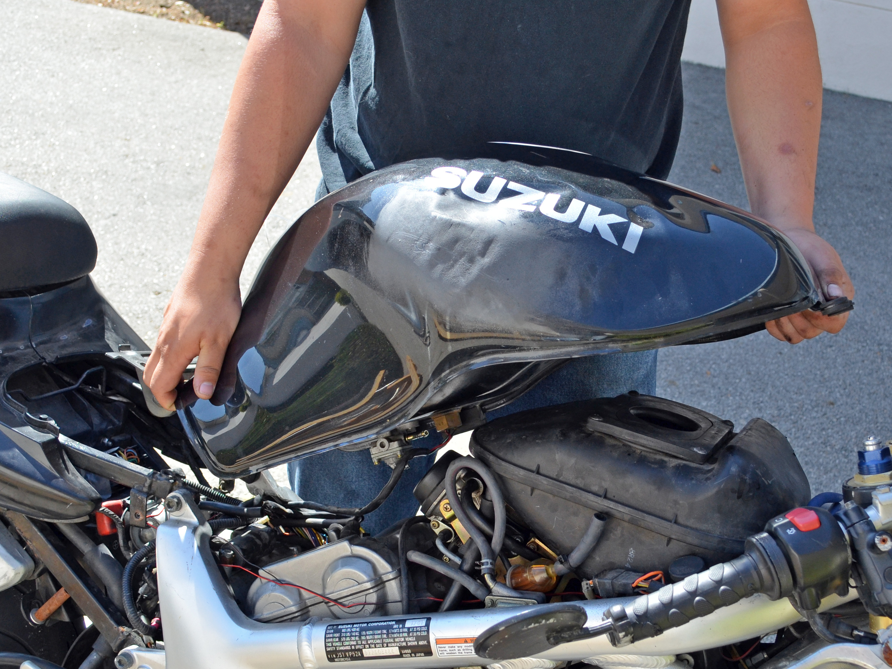

Add Note Edit Step 5  ¶
  • Carefully lift the tank up and off the frame of the bike, being sure that the fuel level sensor wire does not get caught in the frame.
  • When you set your tank aside, be mindful of the petcock hose fittings, especially the vacuum fitting on the bottom. These fittings can easily be broken by the weight of the tank and are costly to replace.
