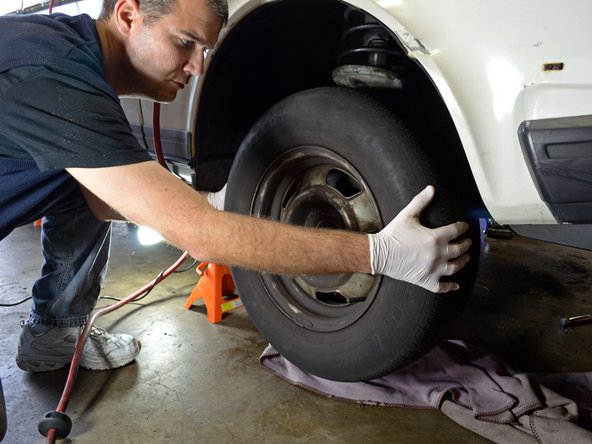

  • Jack up the front of the car and place it on jack stands.
    • Never work on or underneath a car that is only supported by a jack. The jack may slip or fail, resulting in serious injury or even death.

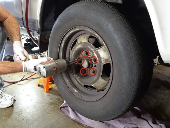

  • Use an impact wrench or lug wrench to remove the five 19 mm lug nuts from the front wheel.
    • The wheel lug nuts should be torqued to 85 ft-lbs when the wheels are put back on the car.
  • Pull the front wheel off the wheel lugs and set it aside.

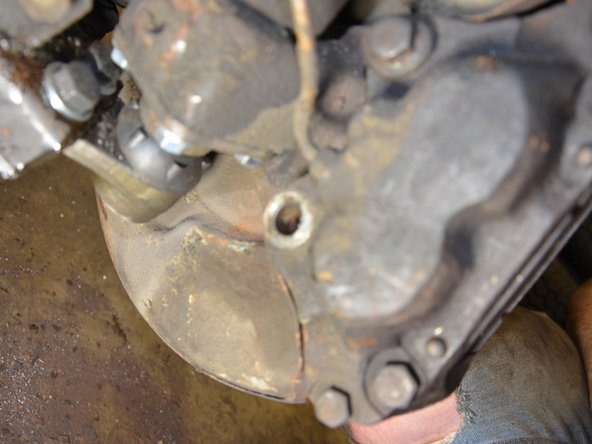

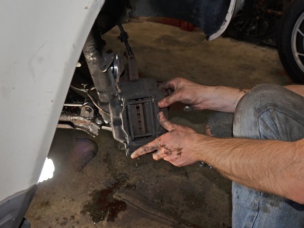

Add Note Edit Step 2 — Front Brake Calipers  ¶
  • Use a 15 mm box end wrench to remove the two bolts on the back of the brake caliper.
Image #1 Image #2

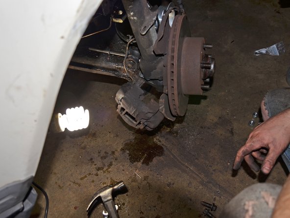

Add Note Edit Step 3  ¶
  • Lift the brake caliper off the rotor and set it aside.
  • Place the caliper on some type of support so that you do not put too much strain on the brake hose.
Image #1

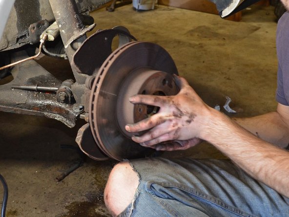

Add Note Edit Step 4 — Front Brake Rotors  ¶
  • Pull the brake rotor straight off the wheel lugs to remove it.

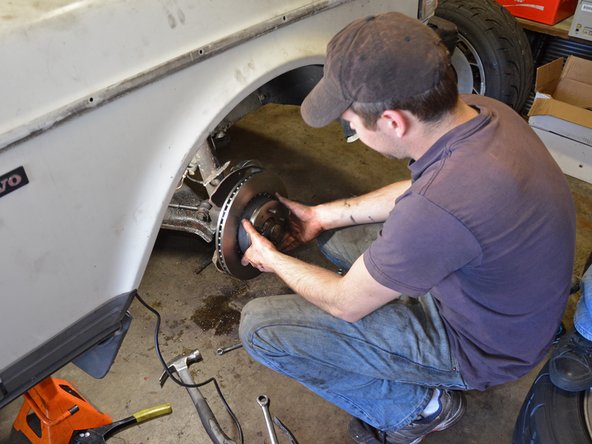

Add Note Edit Step 5  ¶
  • Place the new brake rotor over the wheel lugs.
  • Most new brake rotors can be installed without any additional work, but if your rotors are out of round they will need to be turned.
