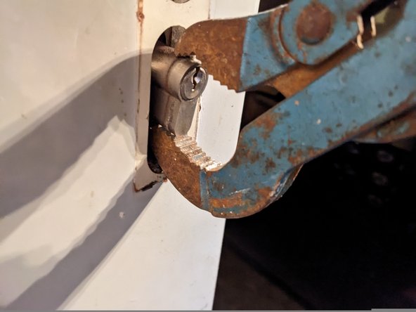

  3. How to crack a Euro Cylinder, Break the Cylinder: step 3, image 1 of 2 How to crack a Euro Cylinder, Break the Cylinder: step 3, image 2 of 2
    • Grip the cylinder with a pipe wrench.
    • You may do it vertically, as shown in the picture, or horizontally.
    • Wiggle the cylinder up, down, left and right until you feel the core come loose with a snap.
    • You don't need any large movements, so you can keep them to a minimum to not damage the faceplate, if you still have it attached.
  4. How to crack a Euro Cylinder, Remove the Core: step 4, image 1 of 1
    • Pull out the detached core half.
