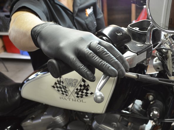

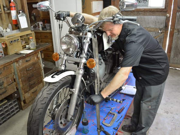

  • When working with the brake lines, we strongly recommend using a bike stand or similar apparatus to stand the bike upright and lock the front tire in place.
Image #1 Image #2 Image #3

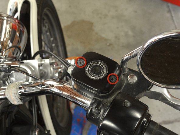

Add Note Edit Step 2 — Opening the brake line  ¶

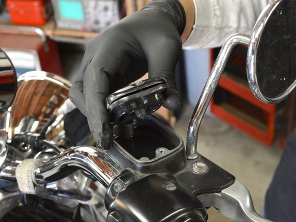

  • Using a Phillips #2 screwdriver, remove the two screws securing the lid on the master brake fluid cylinder.
  • Remove the lid from the master cylinder, and set it aside.
    • Brake fluid is very caustic, and will easily strip paint and discolor chrome. Do your best to not spill any, and be ready with a damp rag in the event of a spill.

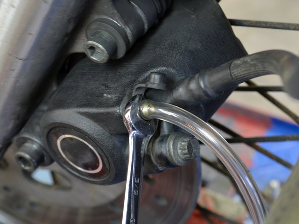

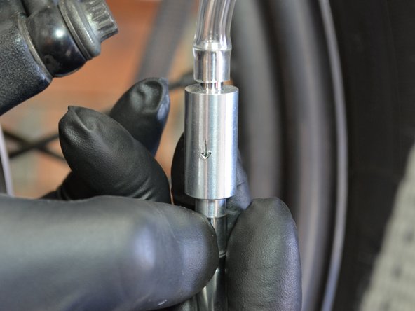

  • Locate the brake fluid bleed valve on the top of the front brake assembly, and flip up the rubber cap covering it.
  • Slide a 3/8" brake bleeder hose over the bleed valve.
    • If you are using a stop valve for bleeding the brake lines, make sure that the arrow on the valve is pointing away from the brake assembly (along the direction of flow).

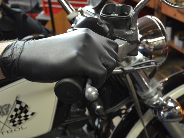

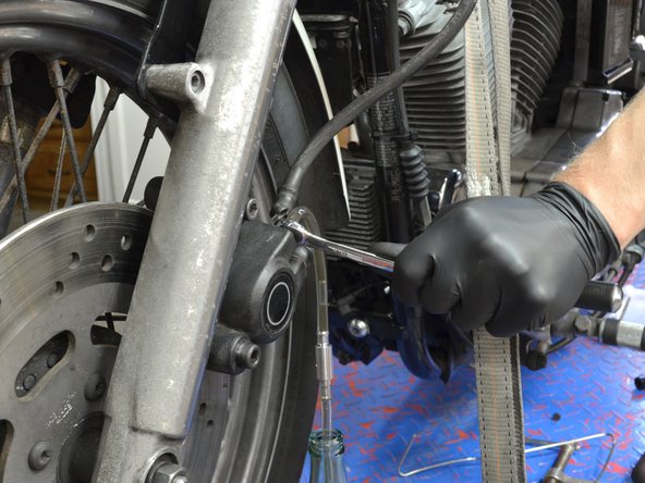

  • Make sure that the free end of the bleed tube is safely pointed at some kind of reservoir. A glass bottle works great.

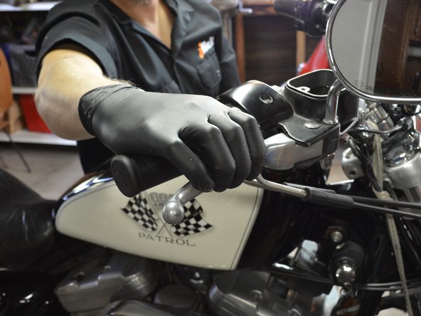

  • Bleeding the brake lines is a whole-body effort. You will need to use one hand to pump the brake handle and one hand to maneuver a wrench on the brake bleed valve.
    • You may need to raise or lower your bike stand to be able to reach all the way across the bike.

  • Carefully pump the brake lever a few times to build up pressure in the brake lines.
  • In the next step, you will release the fluid from the brake lines by opening the bleed valve at the bottom of the lines and simultaneously squeezing the brake lever.

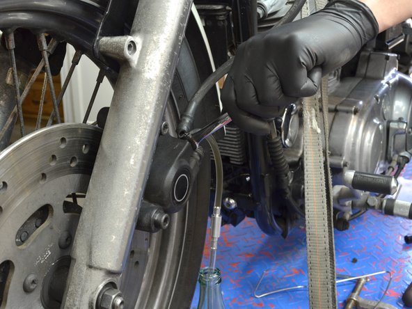

  • Using a 3/8" wrench with your left hand, open the bleed valve on the front brake cylinder.
    • The built-up pressure in the lines will force some of the brake fluid out of the lines.
  • Continue to force more brake fluid out of the brake lines by depressing the front brake lever with your right hand.
    • While bleeding the brakes, focus on the bleeder hose. If you see an air bubble traveling up the bleed hose, close the bleed valve immediately, and begin the process again.
  • Once the brake lever is completely depressed, quickly close the bleed valve, making sure that no air bubbles enter into the brake lines.

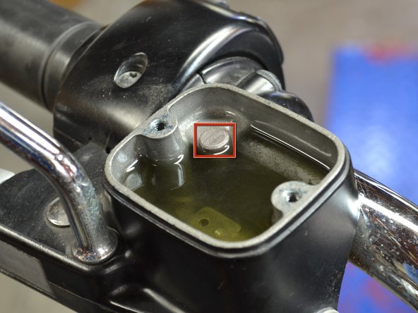

  • Repeat the process outlined in step five and six until the amount of brake fluid in the master cylinder is getting low.
    • Make sure to not remove so much brake fluid that air gets into the brake lines.
  • Refill the master cylinder with fresh brake fluid until the level of fluid is even with the metal protrusion in the rear right corner of the master cylinder.

  • Continue flushing the brake lines as described above until you see the new brake fluid coming through the bleed tube.
    • The new brake fluid will be a lighter color than the old, discolored brake fluid.
  • Keep an eye on the master cylinder. If the fluid level gets too low again, be sure to add more fluid.
  • When you are seeing new brake fluid coming through the bleed hose, stop the flushing process and firmly close the bleed valve.
  • Gently pull the bleed tube off of the bleed valve and re-cover the valve with the little rubber cap.
