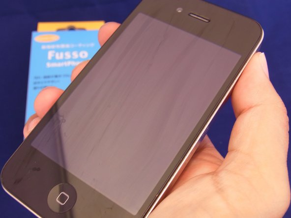

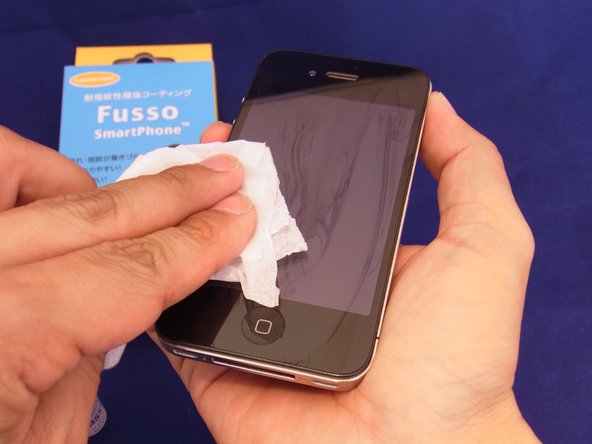

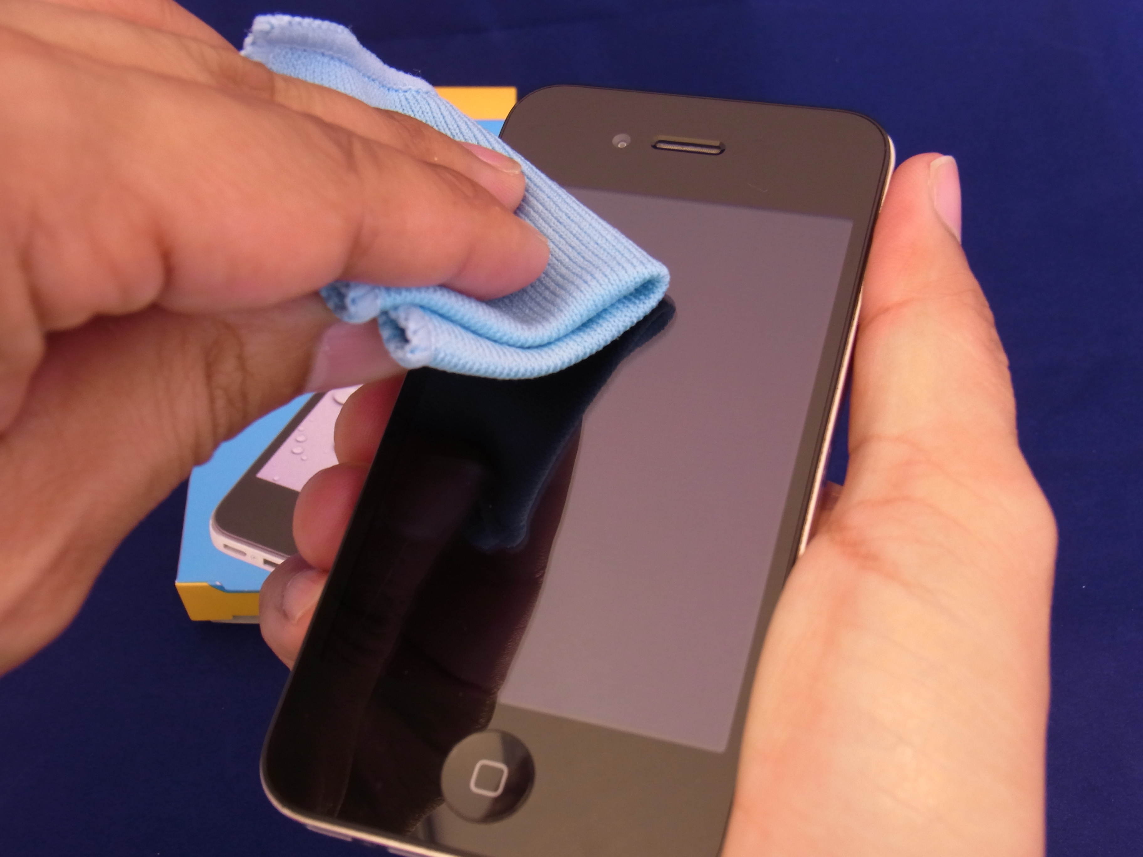

    • Use isopropyl alcohol to thoroughly clean the surface you are planning to apply the coating to.
    • Wipe the screen dry with a clean microfiber cloth.

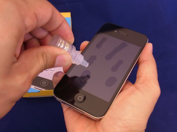

    • Apply 10-15 drops of the oleophobic coating liquid onto the surface.
    • If you are coating a large surface such as a large phone or tablet, apply ten drops to a portion of the screen, and work on one portion at a time.

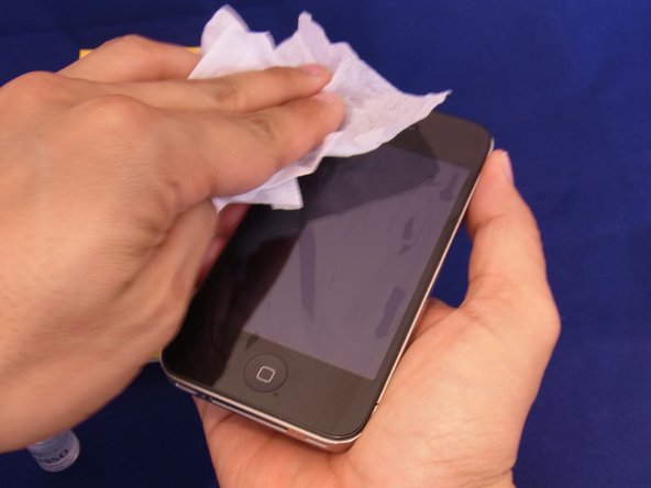

    • Wipe your plastic-covered finger over the surface with quick, light swipes until the liquid evaporates.
    • You don't need to rub very hard—you're just spreading out the coating molecules onto the surface before the solvent evaporates.
    • If you applied the liquid to only a portion of the surface, repeat the liquid application and rubbing procedure to the remaining surface.
