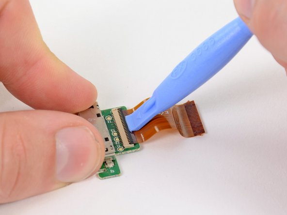

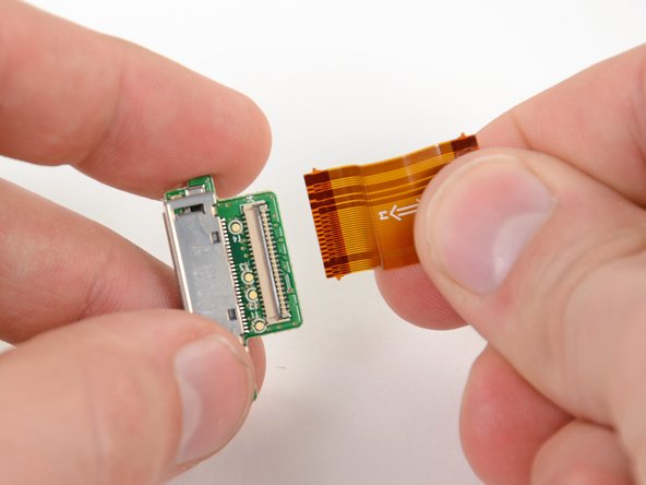

Add Note Edit Step 12 — SD Board Replacement  ¶
  • Use a plastic opening tool or your fingernail to flip up the locking tab on the SD board ribbon cable ZIF connector.
    • Be careful that you are prying up on the locking tab and not the connector itself.
  • Remove the SD board ribbon cable.
