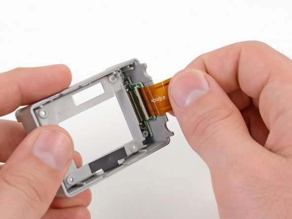

  • Remove the two 5.8 mm Phillips #00 screws securing the SD board cover to the rear case.
Image #1 Image #2 Image #3

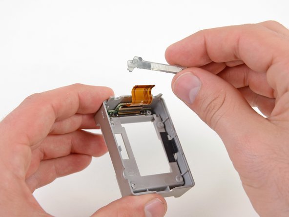

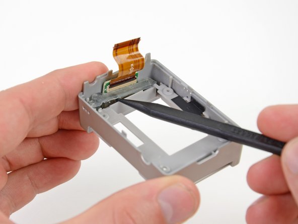

  • Turn the rear case over so that the SD card slot is facing you.
  • Use the tip of a spudger to push the bottom of the SD board cover up and out of the rear case.
  • Turn the rear case back over.
  • Lift the SD board cover out of the rear case with the tip of a spudger and remove it.
Image #1 Image #2

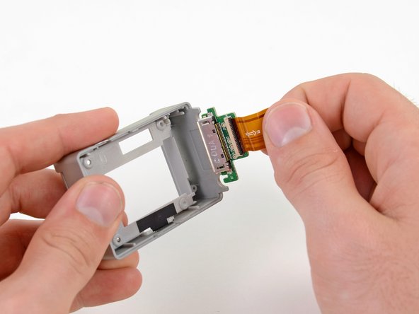

Add Note Edit Step 11  ¶
  • Grasp the SD board ribbon cable gently and pull the SD board out of the rear case.
Image #1

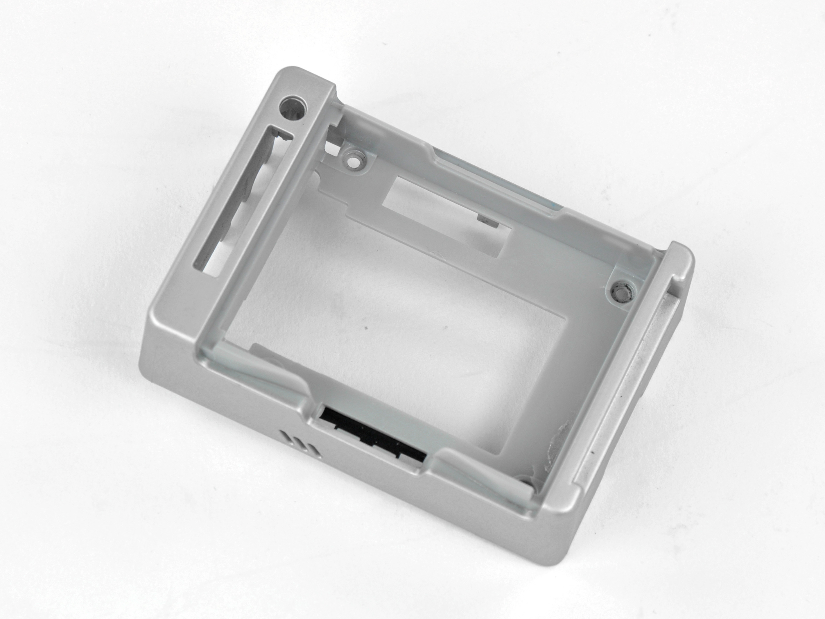

Add Note Edit Step 12 — Rear Case Replacement  ¶
  • The rear case remains.
