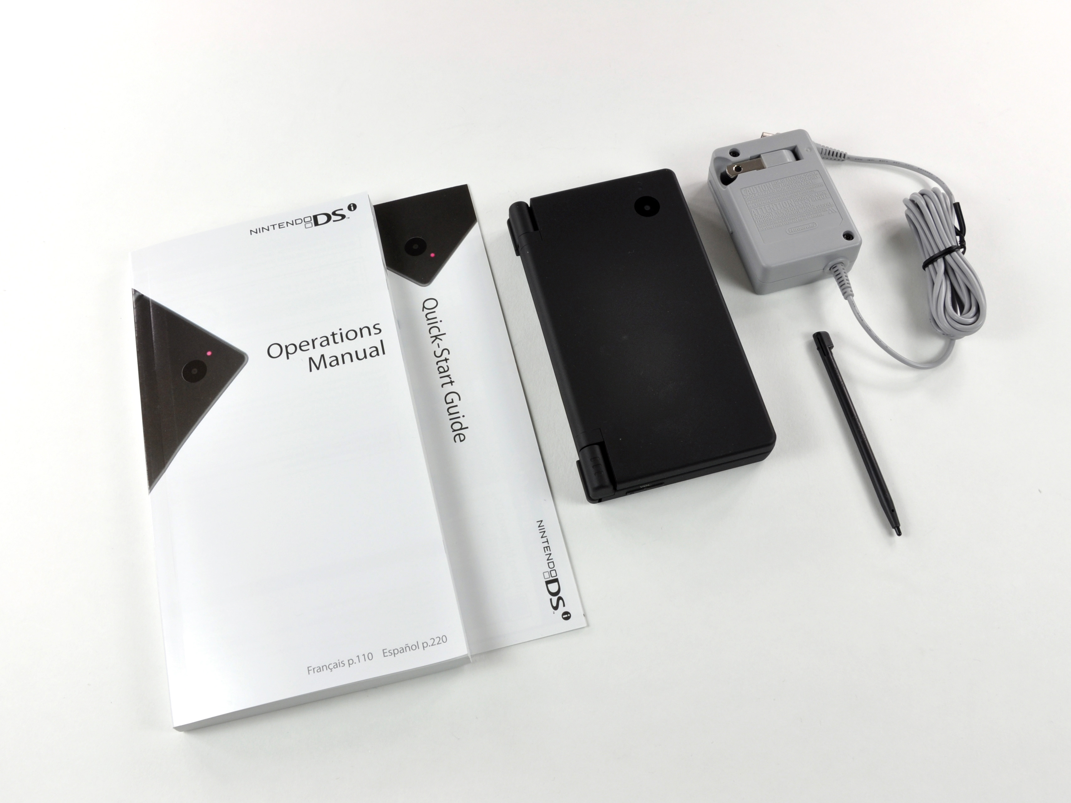

  1. Nintendo DSi Teardown, Nintendo DSi Teardown: step 1, image 1 of 2 Nintendo DSi Teardown, Nintendo DSi Teardown: step 1, image 2 of 2
    • It's here! It's here! Whoopee!
    • Contents of the box:
    • Nintendo DSi
    • Operation Manual
    • Quick Start Guide
    • AC Adapter
    • Extra Stylus
    • An invitation from Mario's hat to join Club Nintendo.
