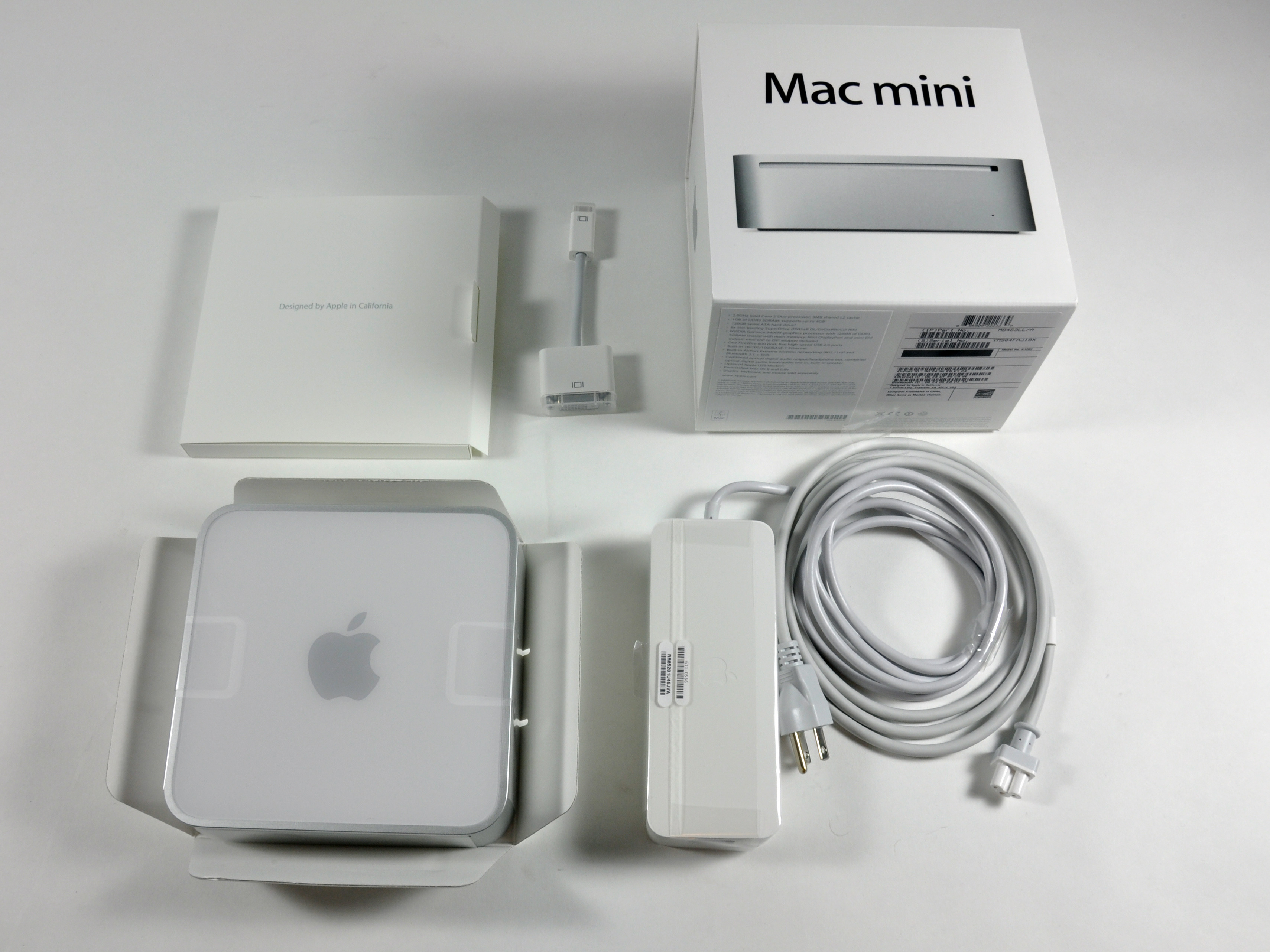

    • Ladies and gentlemen, without further ado, allow us to introduce the new and improved Mac mini!
    • We immediately tried to open the mini using our iMac opening tool, used in yesterday's iMac First Look.
    • It did not work.
    • We also posted a guide for installing a second hard drive in the Mac mini.
