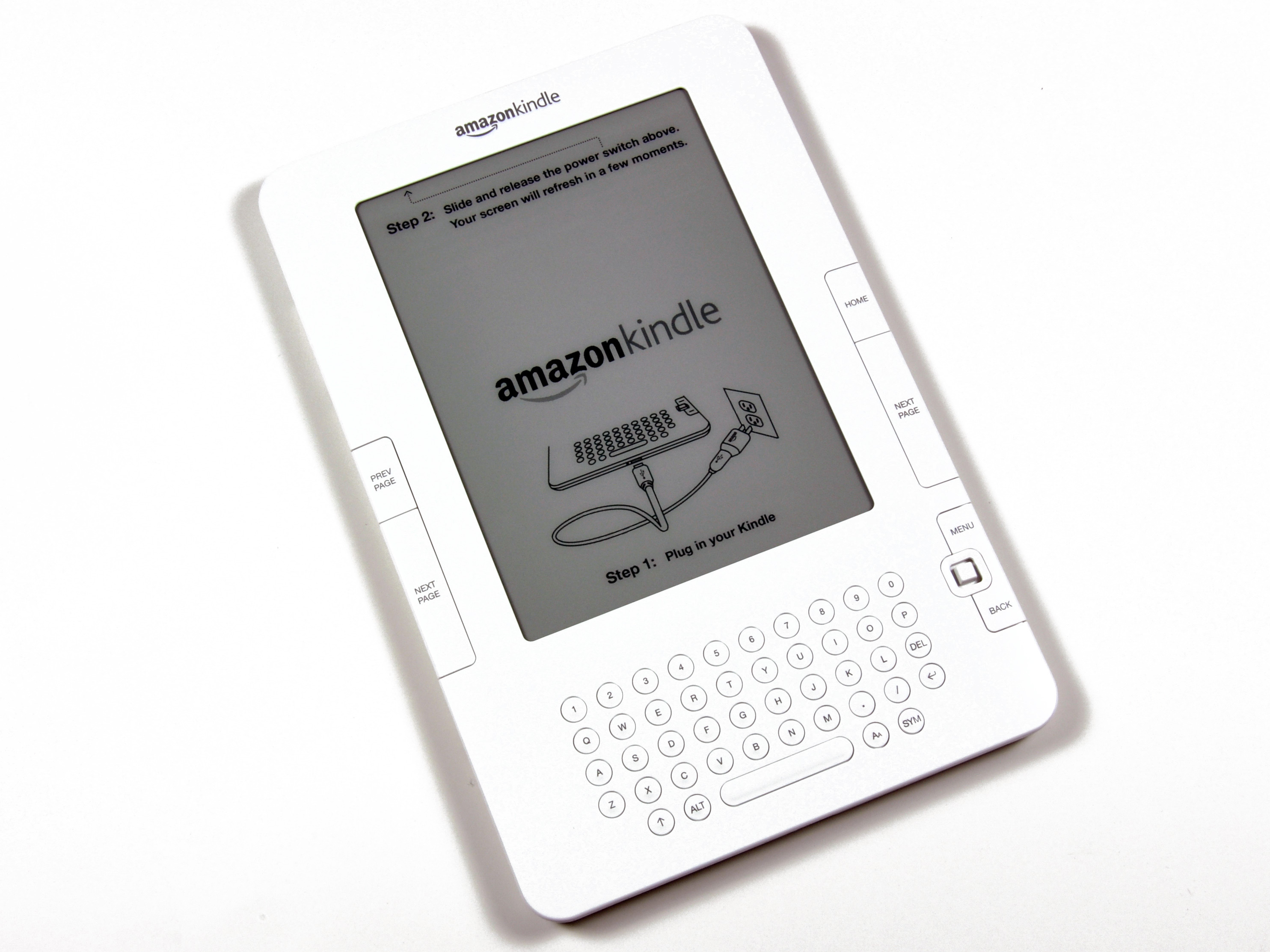

    • It's here!
    • Thanks to the magic of E-Ink, the Kindle comes with setup instructions displayed on the screen itself. No plugging in is required.

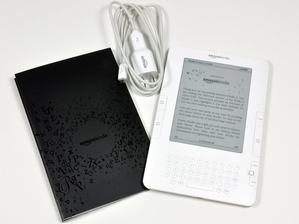

  2. Kindle 2 Teardown: step 2, image 1 of 1
    • What comes in the box:
    • A quick start guide, complete with embossed letters
    • An AC adapter
    • The Kindle 2
    • Conveniently, the AC adapter can be used with either a wall outlet or a USB port.
  3. Kindle 2 Teardown: step 3, image 1 of 1
    • Size comparison: Definitely not as big as a 17" MacBook Pro Unibody.
    • The Kindle 2 weighs only 10.2 ounces. Per pound, that makes the Kindle 2 even more expensive than the $2,799 MacBook Pro 17" Unibody we took apart last week.

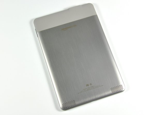

  4. Kindle 2 Teardown: step 4, image 1 of 1
    • The back. Nothing special about it.
    • Note the speaker holes on the bottom. We briefly tried the Text-to-Speech feature and were very impressed by the Kindle 2's ability to read the text displayed on-screen. But the honeymoon was quickly over and we started tearing into it.
    • Hopefully the insides will be more exciting... We'll let you know as soon as we can!

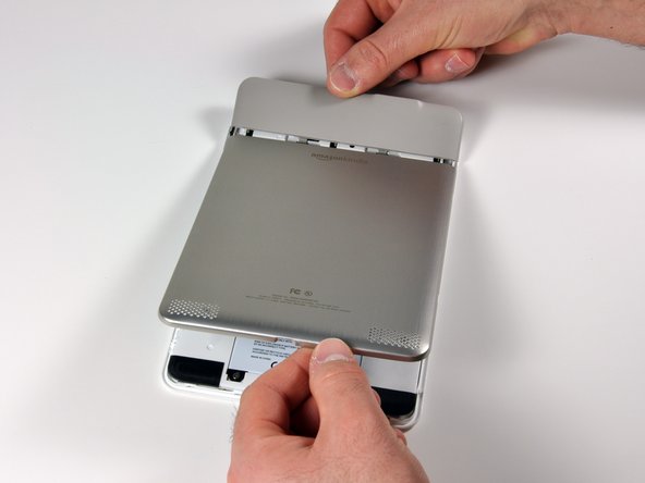

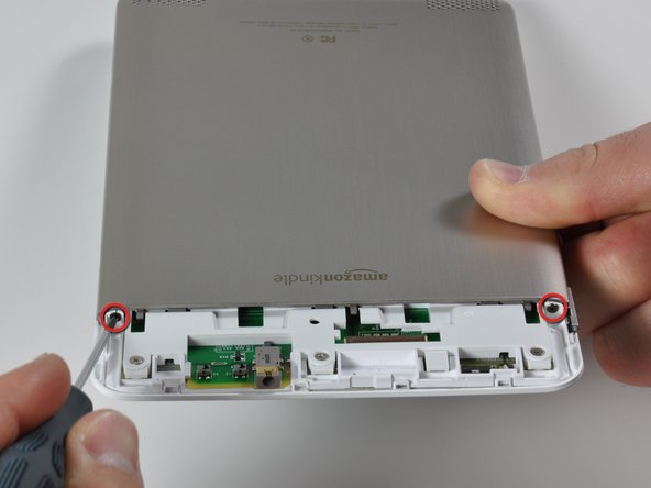

    • Prying the back off...
    • Getting inside is easy once you know how. We used some plastic opening tools and a metal spudger, and finally managed to get in.
    • The matte-gray top cover comes off first.
    • There are two Phillips screws to remove before the Aluminum back can be removed entirely.

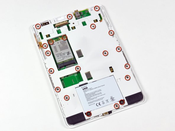

  6. Kindle 2 Teardown: step 6, image 1 of 1
    • We're in!
    • It's still not very pretty; just more white plastic.
    • Twenty Phillips screws hold the white plastic paneling in place.
    • Interestingly, nothing was attached to the large white and brown connector near the top of the board.
  7. Kindle 2 Teardown: step 7, image 1 of 3 Kindle 2 Teardown: step 7, image 2 of 3 Kindle 2 Teardown: step 7, image 3 of 3

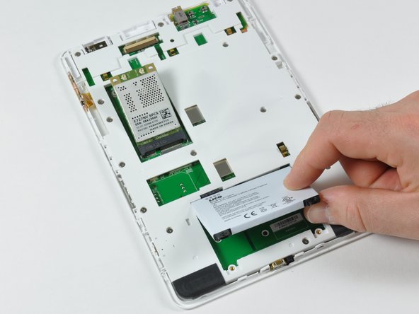

    • Remove two Phillips screws and the battery lifts out easily.
    • The battery is Model No. S11S01A. It's a 3.7 V, 1530 mAh lithium polymer battery. The battery weighs in at 31 grams, just over 10% of the Kindle's total weight.
    • The wireless card is also easily removable by removing two Phillips screws.
    • There are two antenna ports on the wireless card, but there was nothing connected to the AUX port in our Kindle.

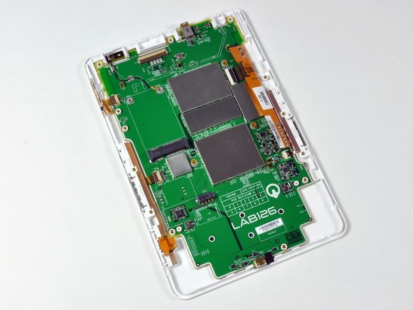

  8. Kindle 2 Teardown: step 8, image 1 of 1
    • After removing sixteen more screws, we've made it to the main PCB.
    • Everything exciting is still beneath silver EMI shields.
    • The Kindle was designed by Lab126, a secretive Amazon subsidiary based in Cupertino that designs consumer devices. Thus far, they have only released the Kindle 1 and 2.
