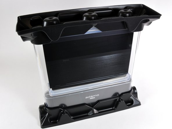

  2. Dell Adamo Teardown: step 2, image 1 of 2 Dell Adamo Teardown: step 2, image 2 of 2
    • Ladies and gentlemen, Adamo has left the building box.

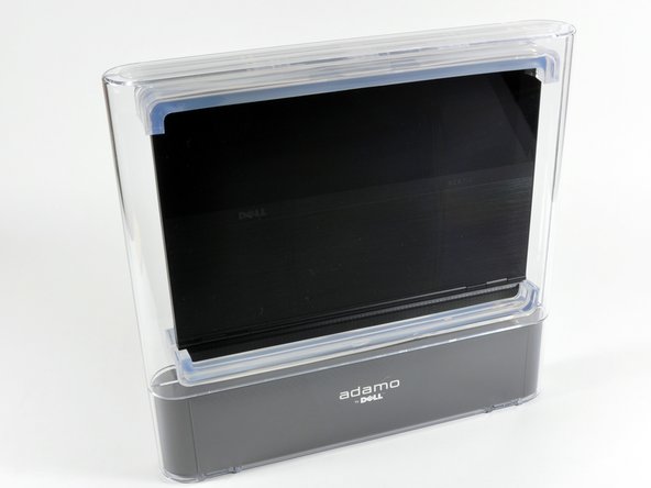

    • Now we know why the the box was so large: the Adamo is encased in a "time-capsule" plastic casing, which in turn is protected during shipping via black plastic shipping caps.
    • MacBook Air packaging requires less effort to remove.

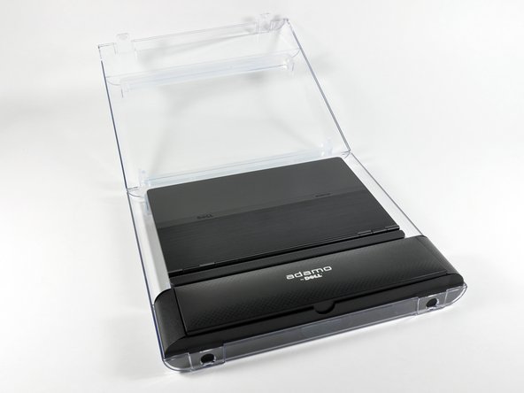

  3. Dell Adamo Teardown: step 3, image 1 of 2 Dell Adamo Teardown: step 3, image 2 of 2
    • The Adamo's time-capsule cryo-chamber protection system ensures a safe voyage through spacetime for all components on board.
    • We were kind of expecting a high pressure hiss and a dense fog to roll out as the container automatically opened itself. Didn't happen. There are two plastic tabs on the bottom of the case that had to be pushed quite firmly in order to release the Adamo from its clear sarcophagus.
    • Lenin would be jealous.

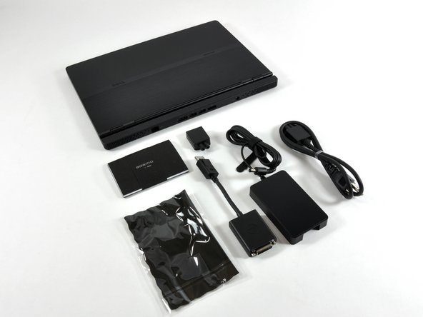

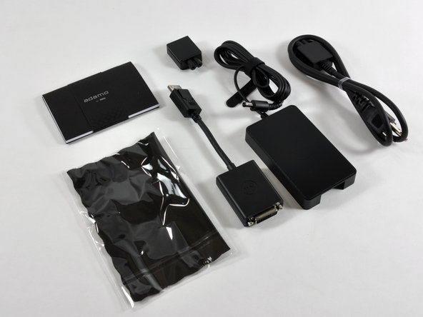

    • The Adamo and the accessories. All our accessories were black, matching nicely with our "onyx" Adamo. We assume (given the price tag) your accessories will be white if you purchase the "pearl" version.
    • The AC adapter is 45 watts, just like the MacBook Air's. The power brick design is elegant, but the actual plug isn't nearly as slick as the Air's MagSafe connector.

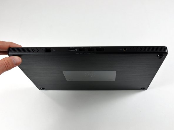

    • The rear ports of the Adamo, from left to right:
    • RJ45 Ethernet
    • eSATA USB
    • 2x USB
    • DisplayPort
    • AC Adapter
    • The right side of the Adamo houses a SIM card slot and an audio out/headphone jack.
    • You get a total of six ports with your Adamo, double that of the MacBook Air. It's a shame that they couldn't just put a DVI display port on the computer itself, and instead chose to include a bulky adapter.

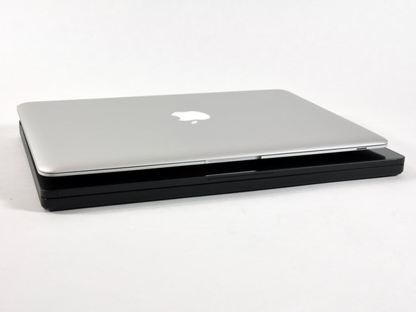

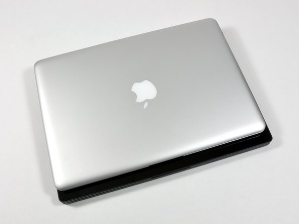

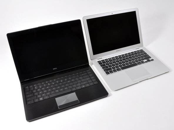

    • Adamo, meet Air. Now that you're acquainted...
    • The Adamo's dimensions, as compared to the MacBook Air:
    • Width: 0.23" larger
    • Depth: 0.56" larger
    • Height: 0.11" thinner
    • It's interesting how the Air plays tricks with height. It certainly looks thinner than the Adamo...
    • Both the Adamo and Air have very high torsional rigidity. This is largely due to their unibody constructions. It's hard to say which is more rigid, but the Adamo is heavier so it feels more solid.

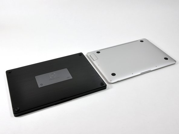

  7. Dell Adamo Teardown: step 7, image 1 of 3 Dell Adamo Teardown: step 7, image 2 of 3 Dell Adamo Teardown: step 7, image 3 of 3
    • The Adamo's elegance clearly beats the Air from this angle.

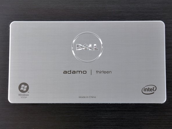

    • The Intel and Windows logos are not the typical stickers; they're painted into the case.

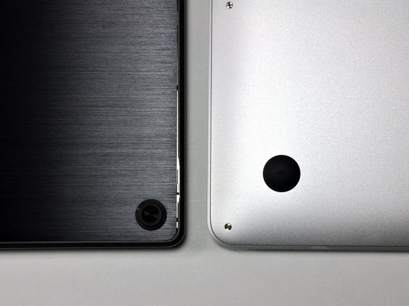

    • Unlike the Air, there are no visible screws on the bottom of the Adamo. However, the gaps between case bottom and frame are significantly larger than the Air's.
    • Getting inside may require some ingenuity...

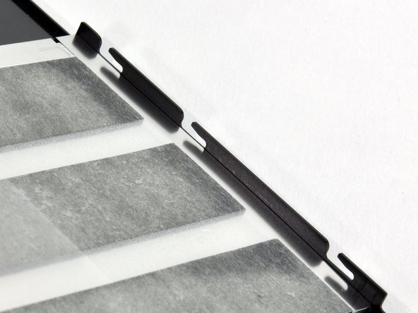

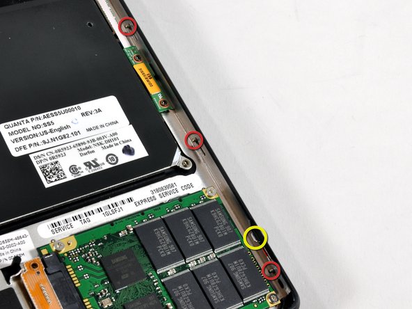

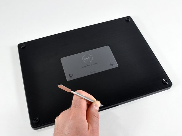

    • It's time to use a metal spudger.
    • The Adamo uses a very slick locking system to hold the bottom panel in place.
    • The locking system utilizes three tracks of pins that span the inner left, right, and front edges of the computer. The pins lock into slots machined into the bottom panel, creating a very tight and secure connection.
    • The bottom panel is removed by simply sliding the metal ear (shown in yellow) connected to each set of pins (shown in red) to the right using a thin metal spudger.
  9. Dell Adamo Teardown: step 9, image 1 of 2 Dell Adamo Teardown: step 9, image 2 of 2

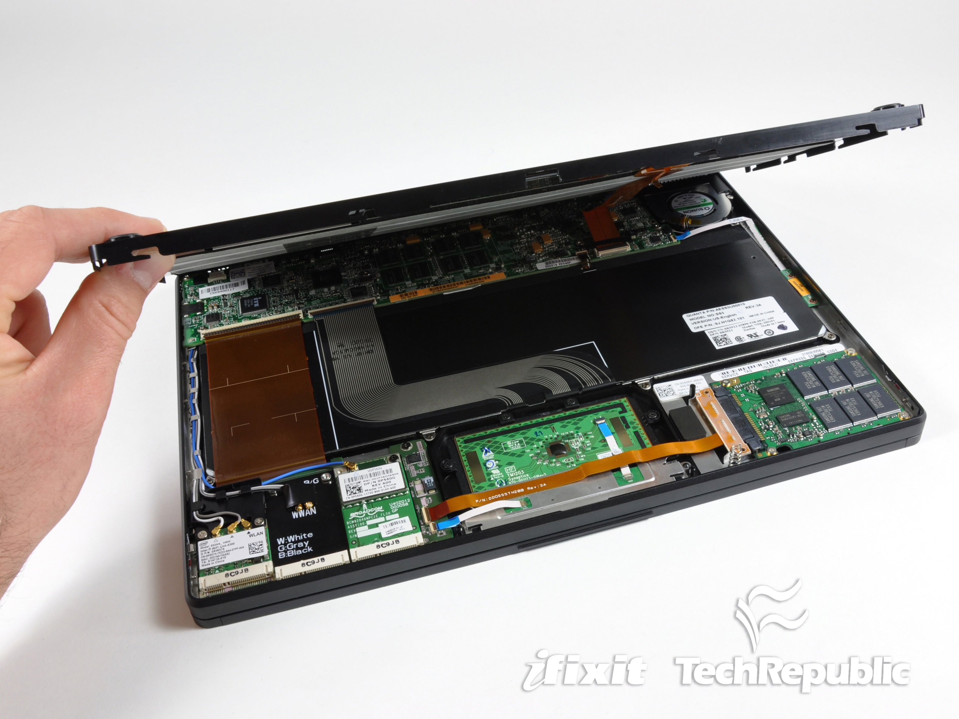

    • Once the pins are released, the bottom panel simply lifts up.
    • The battery connects to the motherboard with an orange ribbon cable. This cable should be disconnected before entirely removing the bottom panel.
  10. Dell Adamo Teardown: step 10, image 1 of 1
    • The Adamo and Air with bottom panels removed.
    • The MacBook Air we're using in this guide is the original model (released over a year ago). Despite its age, the Air still packs a 1.6 GHz Core 2 Duo processor, 33% faster than our Adamo's 1.2 GHz processor.
    • To its credit, the high-end Adamo does include 4 GB of built-in RAM, double that of the Air.
    • Dell labels a lot more parts than Apple. This definitely makes our job easier, even though it's not quite as photogenic.
