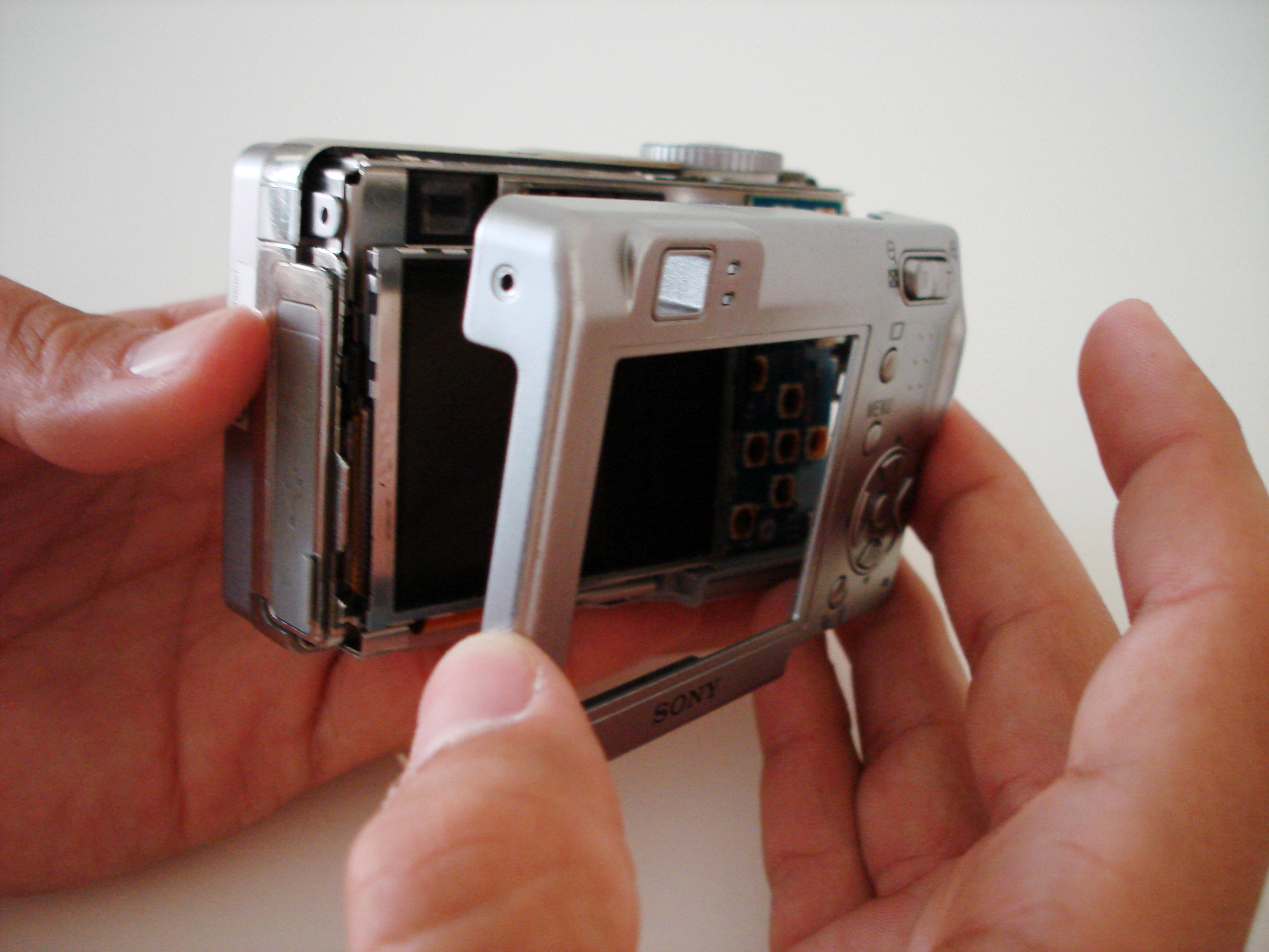

We will be taking off the back cover, or case, of the camera to gain access to the internal components including the speaker, LCD screen, lens, and motherboard.

Add Note Edit Step 3  ¶
  • Gently remove the back cover from the camera.
  • The first time the case is removed, it will be stiff. Be patient and gently rock the cover back and forth until it slides free.
