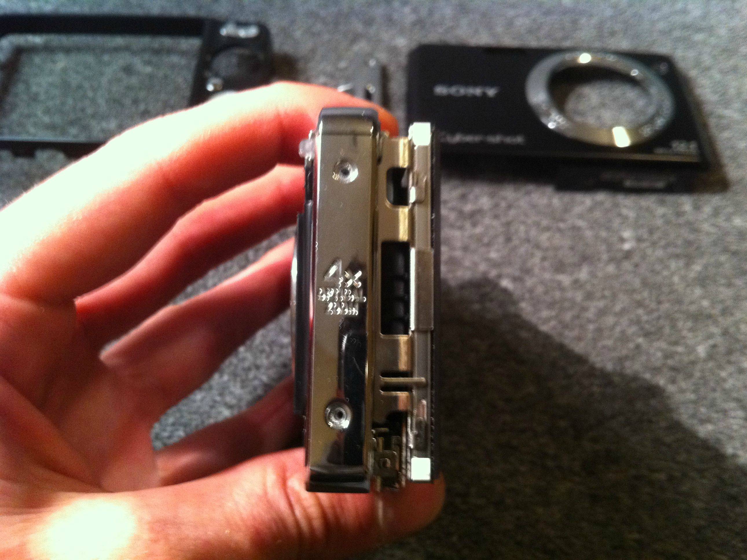

  • Align the camera so that the side with "4x Optical Zoom" is facing toward you.
  • Gently twist the bottom corner clockwise until you feel the side panel unlock.
  • Lift off the side panel and set aside.

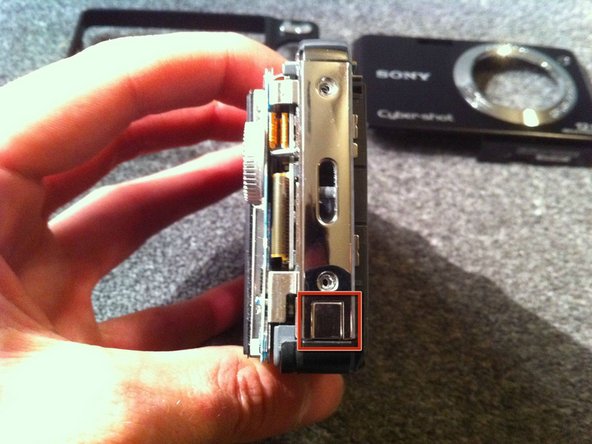

  • Rotate the camera 180 degrees to face the side panel with the lanyard loop on it.
  • Gently lift the panel vertically until it lifts off
  • Take care to not lose the small rectangular portion on the bottom of the panel.
