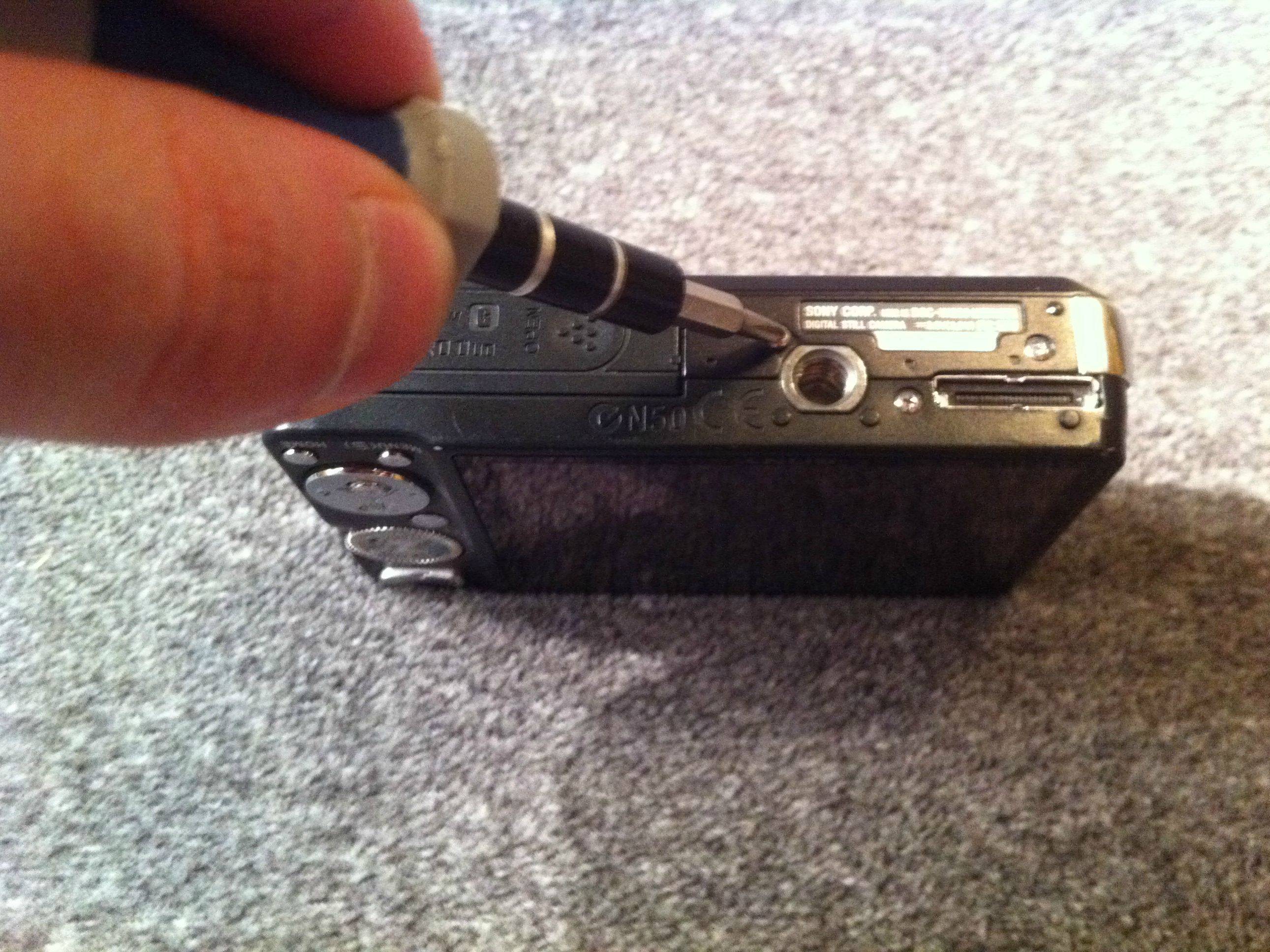

This guide will explain how to take off the camera's exterior case.
Image #1
Add Note Edit Step 1 — Exterior Case  ¶
  • Begin by placing the camera upside down and removing the three small center screws.
  • All screws are the same size and length and can be used interchangably.
Image #1 Image #2
Add Note Edit Step 2  ¶
  • Turn the camera on its side (Counterclockwise). Remove the two small screws on either side of the silver panel.
  • Turn the camera 180 degrees onto its other side and remove the two small screws on either side of the silver panel.
Image #1 Image #2 Image #3
Add Note Edit Step 3  ¶
  • Locate the camera's tripod mount located on the bottom of the camera.
  • Carefully remove the camera's tripod mount and place it aside.
  • Be careful not to lose this piece.
  • Rotate the silver panel labeled 4x clockwise.
