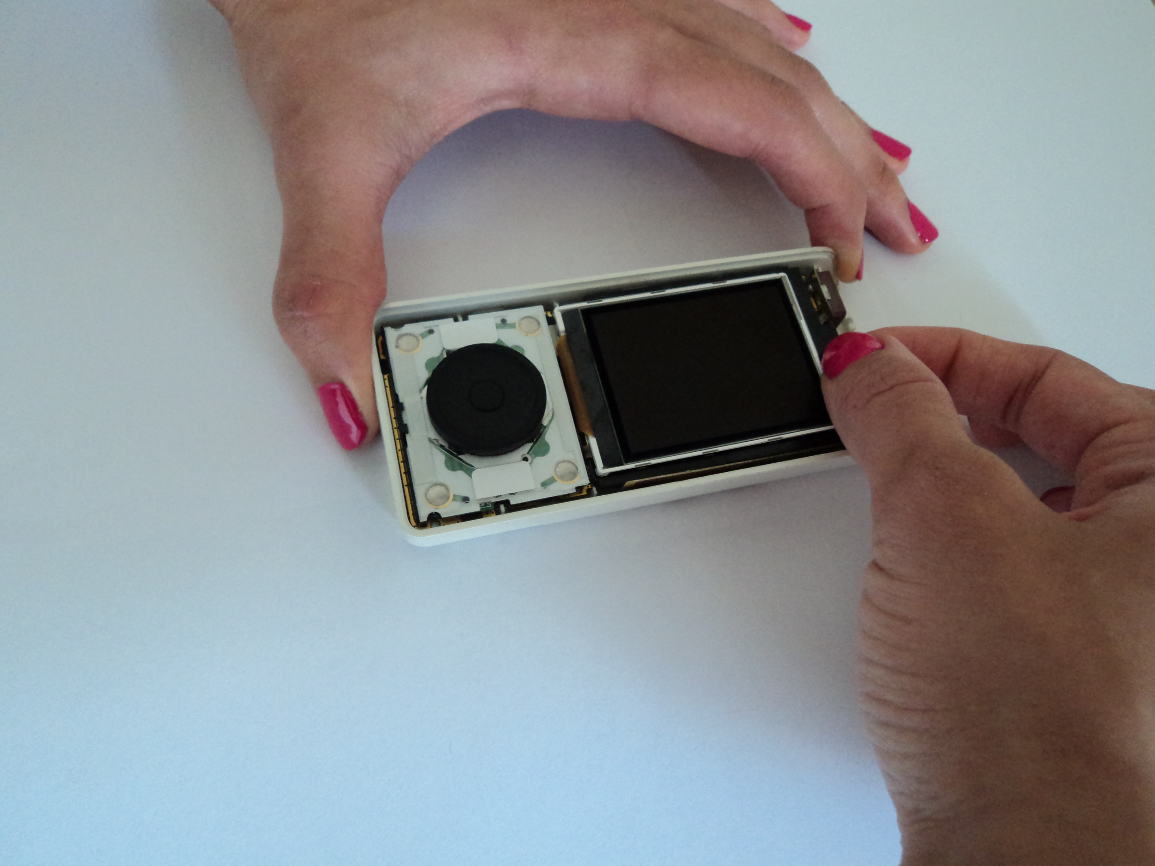

Add Note Edit Step 4 — Circuit Board  ¶
  • While looking down at the device, place your index finger at the top of the circuit board and your thumb on the device screen.
Image #1 Image #2
Add Note Edit Step 5  ¶
  • Using your fingers, gently pull the top of the circuit board up toward you while also sliding the bottom of the circuit board away from the bottom of the Sirius Stiletto 100 back cover.
Image #1
Add Note Edit Step 6  ¶
  • Congratulations! You have successfully removed the internal circuit board from the Sirius Stiletto 100 back cover.
