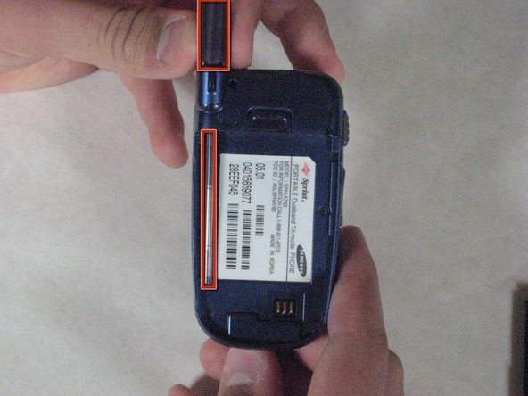

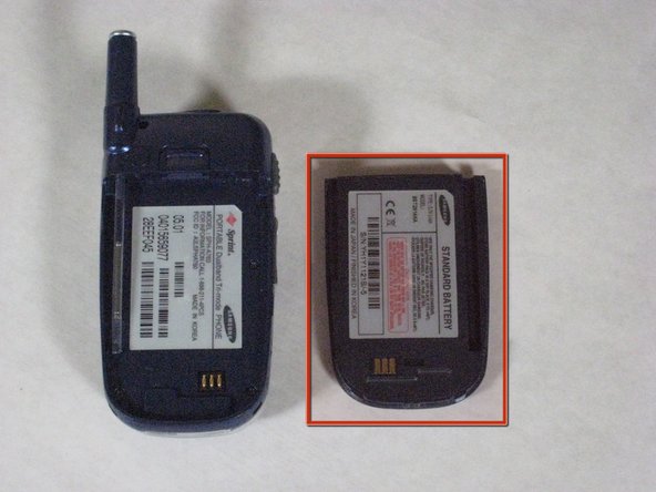

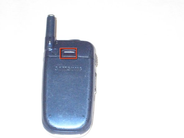

  • Push open the latch and remove the battery.

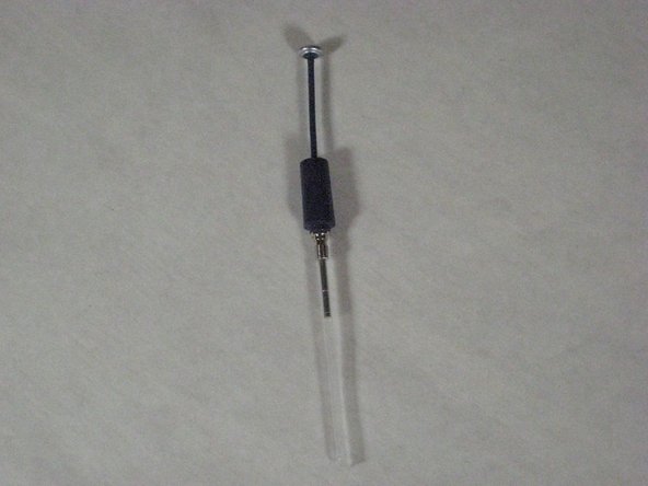

Add Note Edit Step 2 — Antenna  ¶
  • Twist off the antenna.
  • Pop off the transparent cylinder.

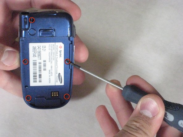

Add Note Edit Step 3 — Logic Board  ¶
  • Remove the five screws as shown.
Image #1

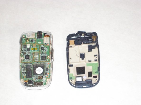

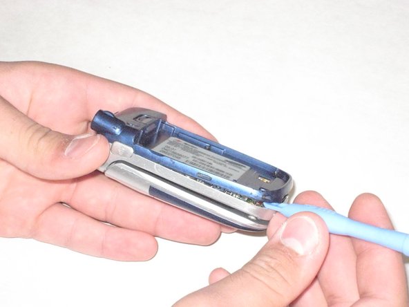

Add Note Edit Step 4  ¶
  • Carefully pry the back plate off.
Image #1 Image #2

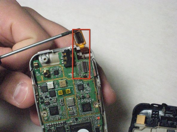

Add Note Edit Step 5  ¶

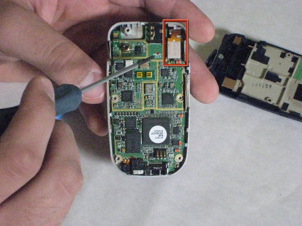

  • Carefully detach golden screen connector.
Image #1 Image #2

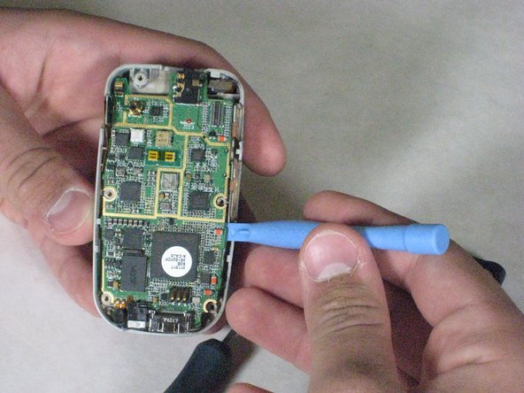

Add Note Edit Step 6  ¶
  • Pop out the logic board with spudger.
  • Caution: Do not touch with bare hands, use tweezers or wash hands before contact.
Image #1 Image #2

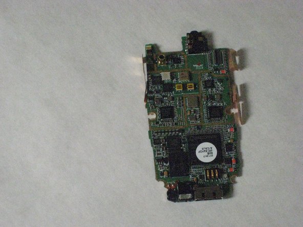

Add Note Edit Step 7  ¶
  • Place the logic board on a clean tray.
Image #1

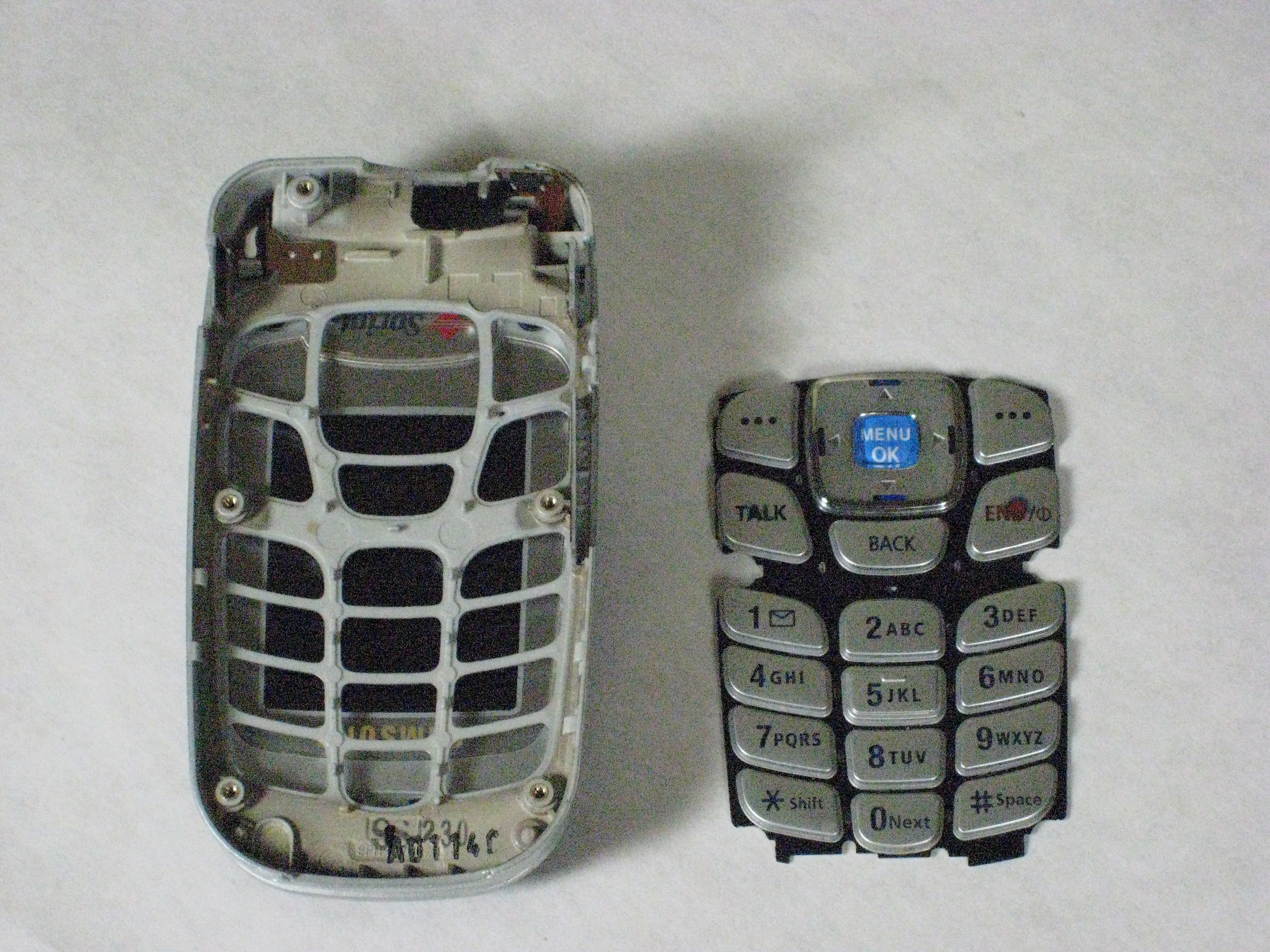

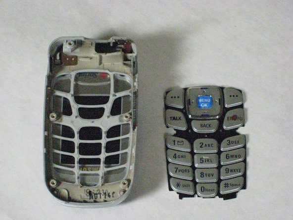

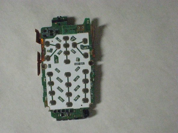

Add Note Edit Step 8 — Keyboard  ¶
  • Peel off the keyboard.
