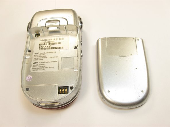

  • Slide the the battery release tab upwards while simultaneously lifting the back cover straight up.
Image #1
Add Note Edit Step 2  ¶
  • Battery remains.

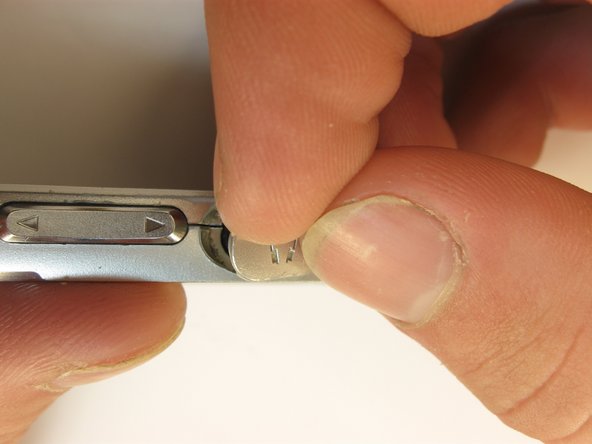

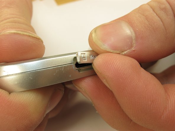

  • Pull open the earphone tab and the Trans Flash tab using your fingers.

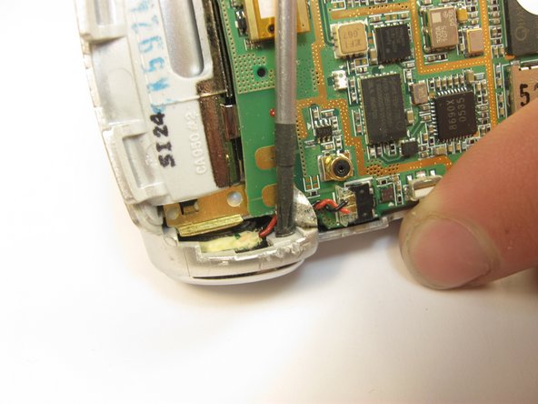

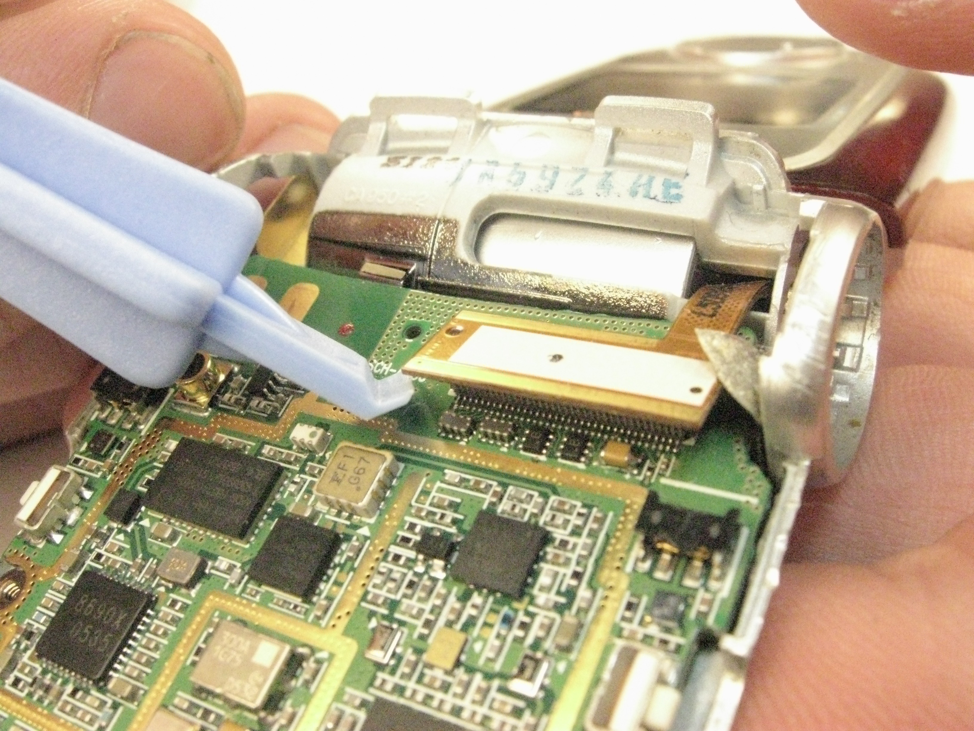

  • Using a spudger, pry off the phone casing near the speakers as shown. Tabs located on the inside of the phone may make this difficult and some force may be required.
  • Slide the casing slightly forward towards the top of the phone to remove.
