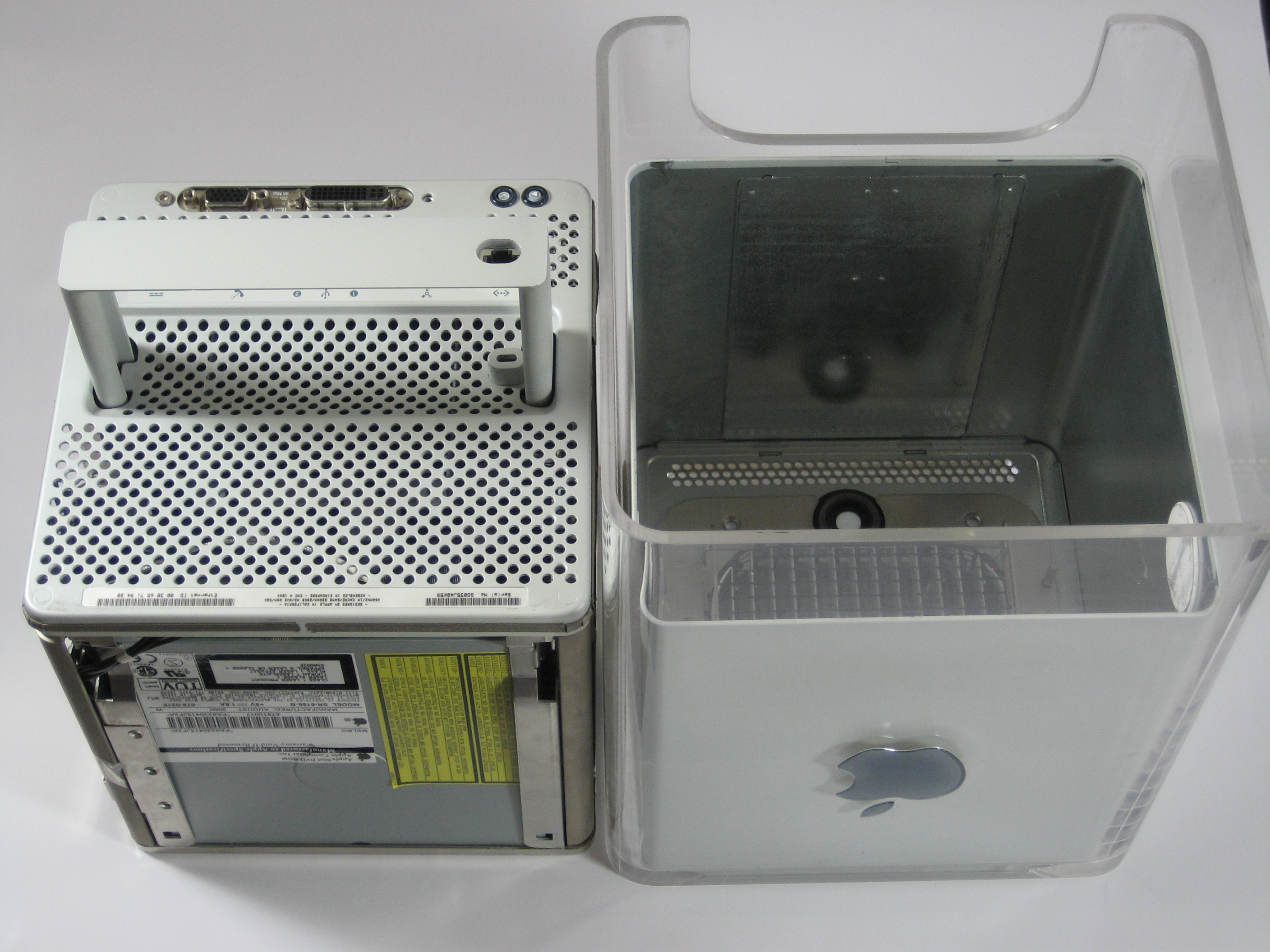

  1. Disassembling Power Mac G4 Cube Outer Case, Outer Case: step 1, image 1 of 3 Disassembling Power Mac G4 Cube Outer Case, Outer Case: step 1, image 2 of 3 Disassembling Power Mac G4 Cube Outer Case, Outer Case: step 1, image 3 of 3
    • Release the back handle of the PowerMac. Slowly pull out the cube by holding the end of the handle. Watch for any parts that may become entangled with the outer case.
    • Push back the handle after you have taken the core out of the case.
  2. Disassembling Power Mac G4 Cube Outer Case: step 2, image 1 of 2 Disassembling Power Mac G4 Cube Outer Case: step 2, image 2 of 2
    • Place the cube upside down and remove the four T10 Torx screws on the front plate. Then remove the two screws on each side.
  3. Disassembling Power Mac G4 Cube Outer Case: step 3, image 1 of 1
    • Slowly lift the plate off the cube and disconnect the power cord.
  4. Disassembling Power Mac G4 Cube Outer Case: step 4, image 1 of 1
    • Remove the four pillars from each corner.
    • The pillars should come out fairly easily.
