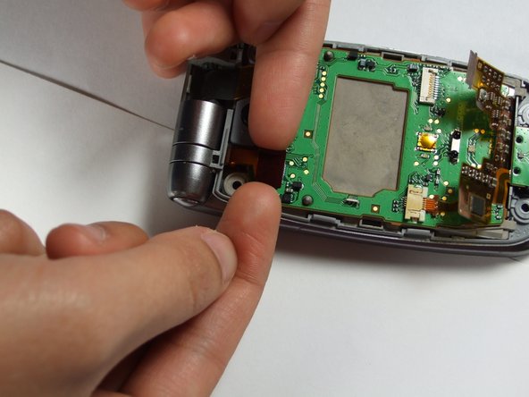

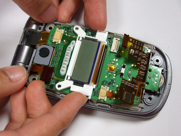

Add Note Edit Step 3 — Minor-LCD  ¶
  • Unlock the minor LCD connector by applying bilateral pressure with tweezers, as shown.
Image #1
Add Note Edit Step 4  ¶
  • Use fingernails to pry off minor LCD mount, as shown.
  • Remove the minor LCD

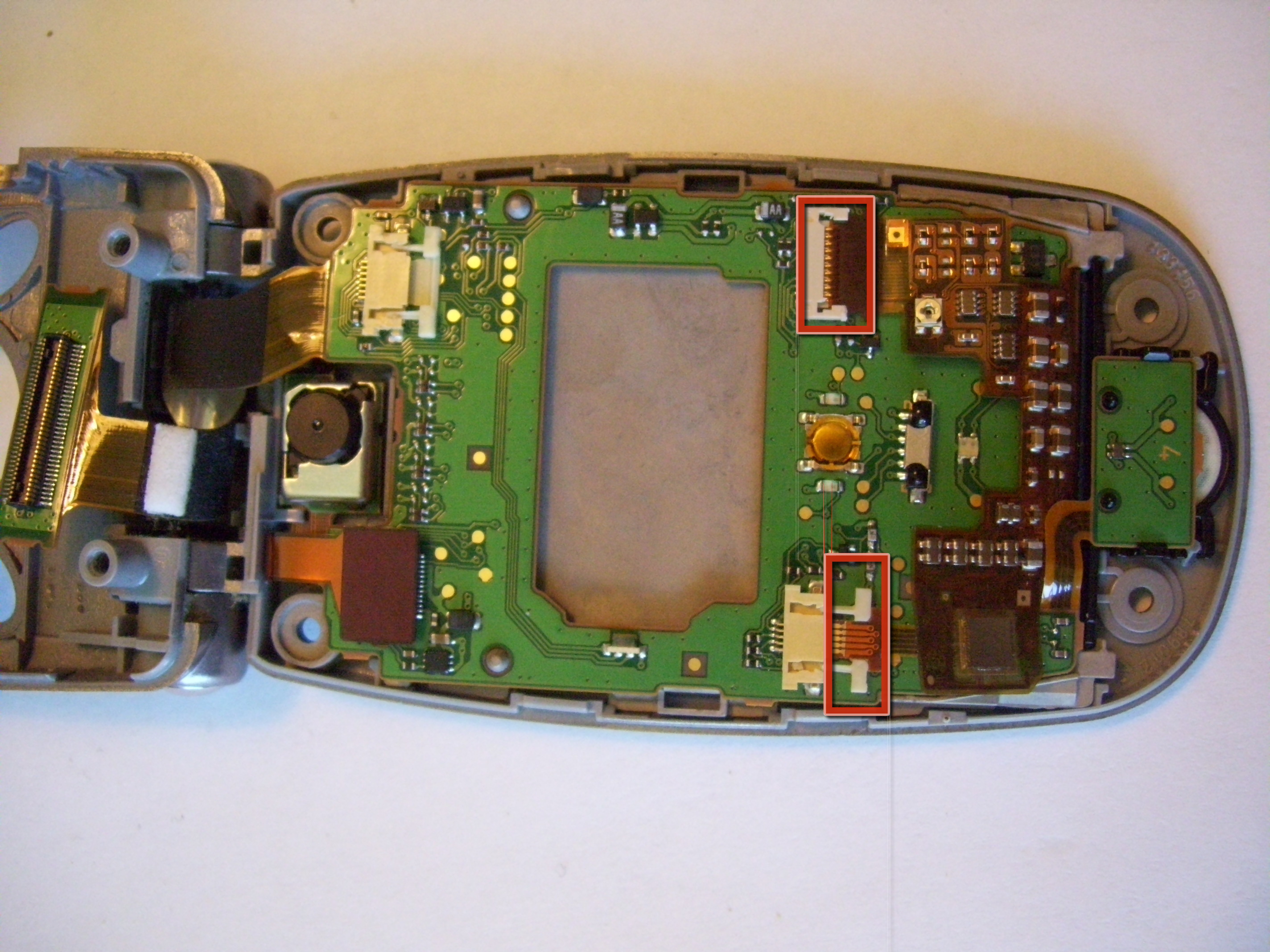

Add Note Edit Step 5 — LCD main board  ¶
  • Unlock the LCD main board connectors shown in red boxes on the picture .
  • Use tweezers as necessary.
Image #1
Add Note Edit Step 6  ¶
  • Place finger nails on the connector tab as shown.
  • Lift the connector tab up.
Image #1
Add Note Edit Step 7  ¶
  • Pull/pivot the LCD main board as shown in order to remove.
