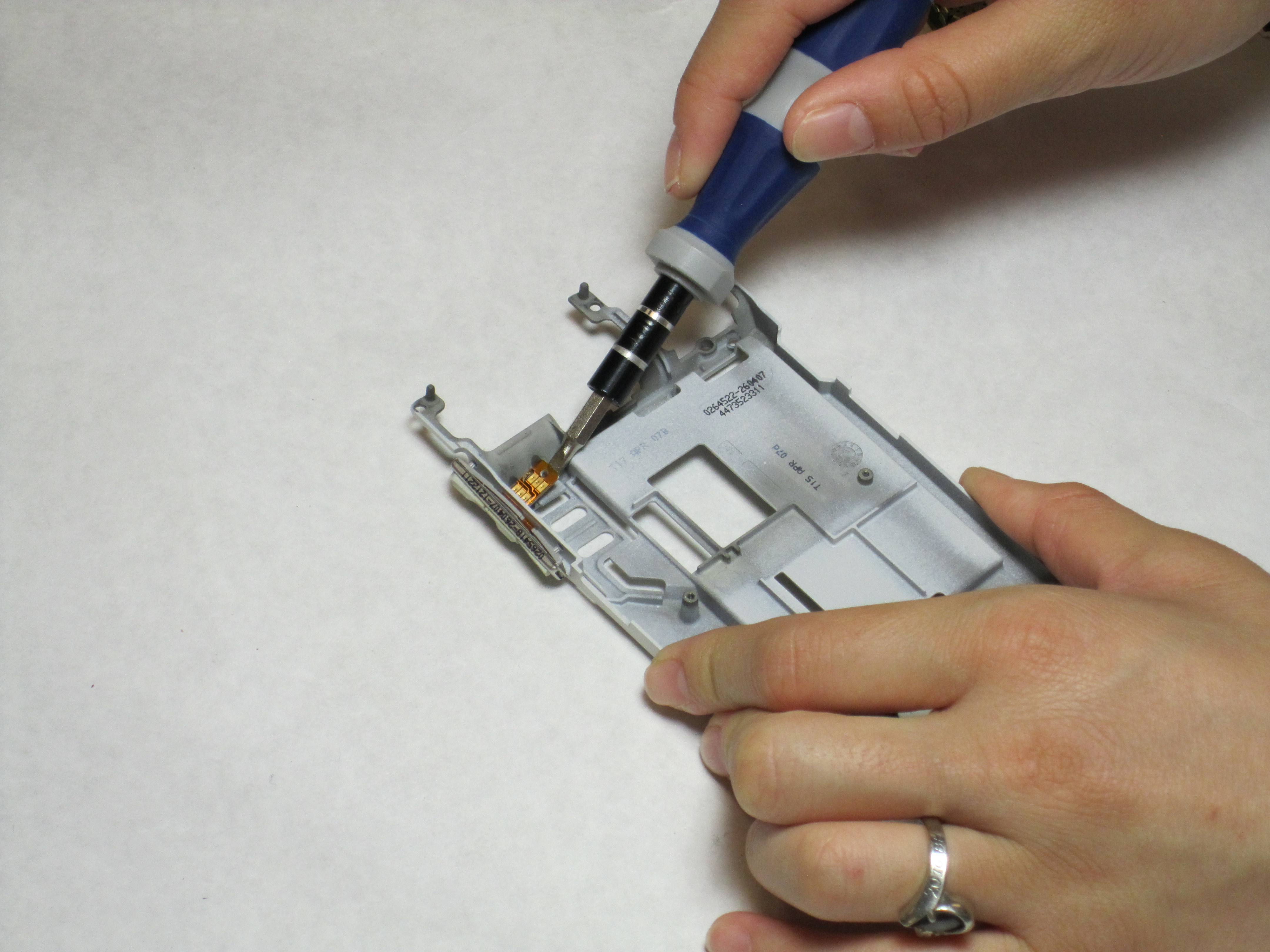

  • Remove the four screws securing the front cover to the rest of the phone using a T7 screwdriver.
Image #1
Add Note Edit Step 5  ¶
  • After the screws have been removed, there is nothing else securing the front cover to the rest of the phone. Simply remove the cover by pulling it up and off.
