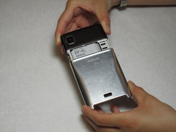

  • To access the battery you must remove the back cover. Press the tab on the bottom of the cover in so that the back cover plate can slide over it.
  • Now slide the back cover off of the phone.

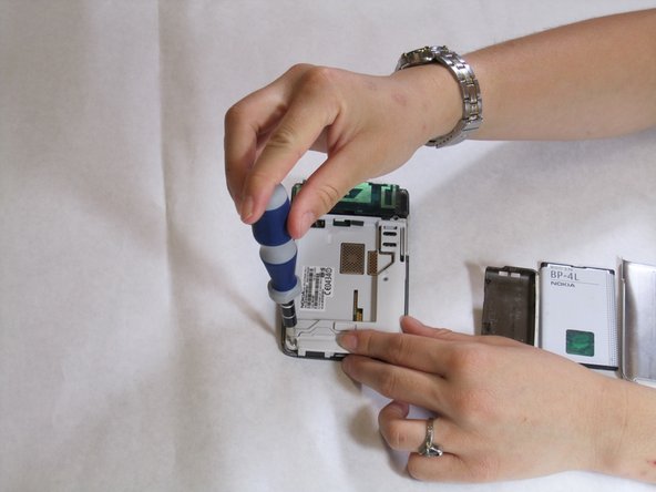

  • Remove the four screws securing the front cover to the rest of the phone using a T7 screwdriver.

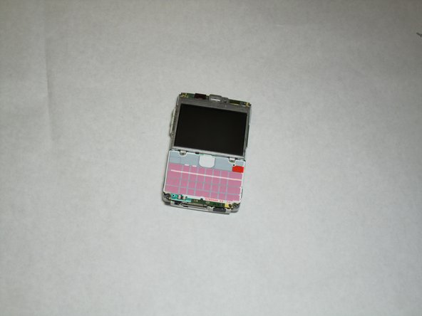

Add Note Edit Step 6 — Display  ¶
  • After casing and keyboard have been taken off, remove the screws holding the screen in place using a T-6 for the screws in the middle of the red circles and a T-5 for the screw in the middle of the red square.
  • Lift ribbon off of the contact with the logic board
  • *When reassembling, make sure to firmly press contacts into place to ensure a connection is made between ribbon and logic board

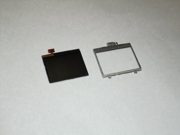

  • Once the screws are out, gently pull the screen off of the phone. *NOTICE* The sticker that attaches the display (in the middle of the blue square again) and the logic board is to be removed safely and be sure not to rip this apart.
  • Finally, pull the silver case off to completely free the cracked or damaged screen.
