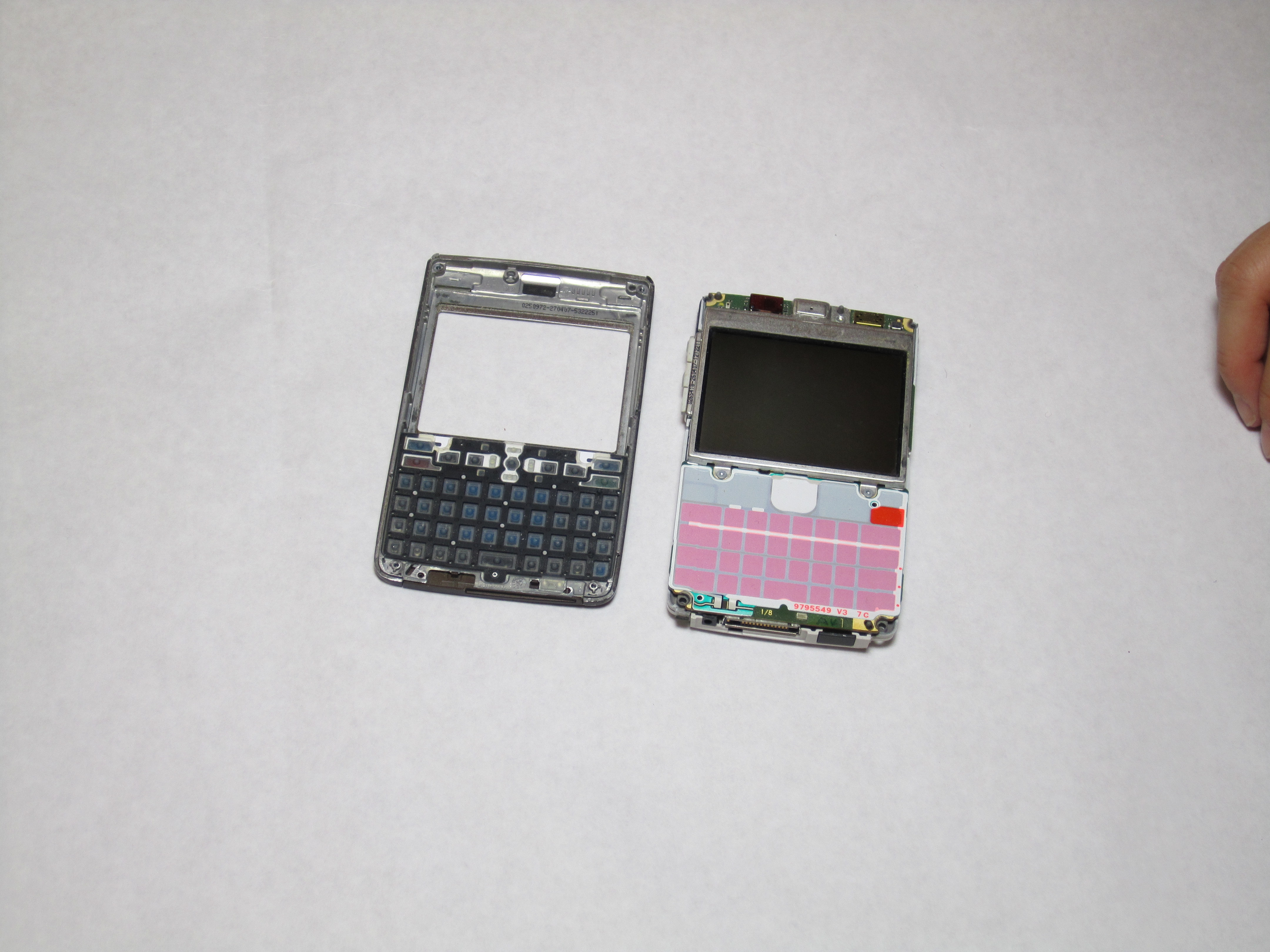

  • Remove the four screws securing the front cover to the rest of the phone using a T7 screwdriver.
Image #1
Add Note Edit Step 5  ¶
  • After the screws have been removed, there is nothing else securing the front cover to the rest of the phone. Simply remove the cover by pulling it up and off.
Image #1

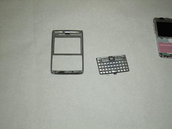

Add Note Edit Step 6 — Keyboard  ¶
  • Once the front cover has been removed, there is nothing holding the keyboard to the rest of the phone. Simply remove the keyboard from the cover by lifting the keyboard from its interior side.
