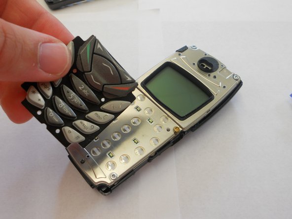

Add Note Edit Step 2  ¶
  • Once the face plate is off, you will have exposed the keypad.
Image #1
Add Note Edit Step 3  ¶
  • Simply remove the keypad from on top of the phone, and place it off to the side, leaving just the phone itself remaining

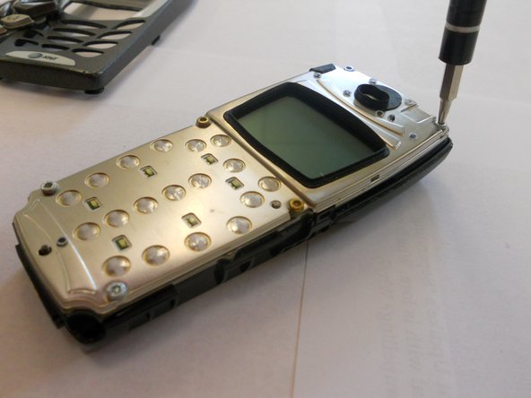

Add Note Edit Step 4  ¶
  • Taking a very small screwdriver, carefully unscrew the six screws attaching the top layer of the screen from the body of the phone.
  • Make sure to remember what screw goes where.

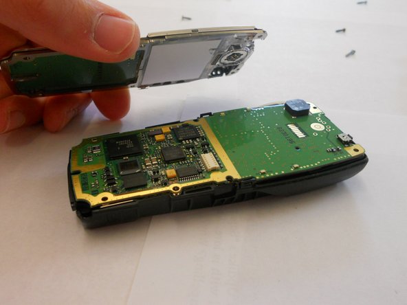

Add Note Edit Step 5  ¶
  • Once the six screws are removed, you may take off the screen section of the phone, exposing the inner workings of the cell phone.

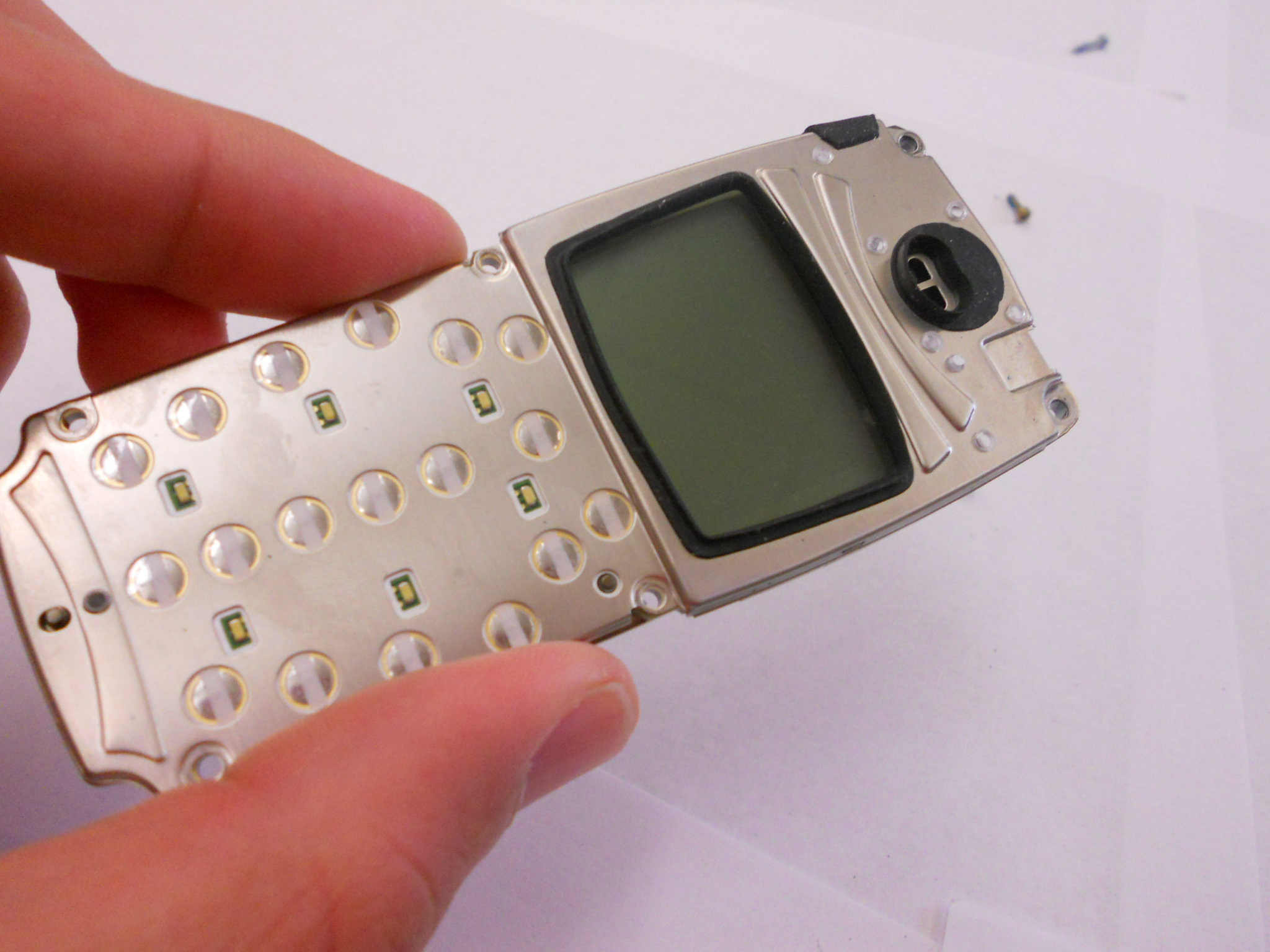

Add Note Edit Step 6  ¶
  • Now you have successfully removed the display screen and keyboard.
