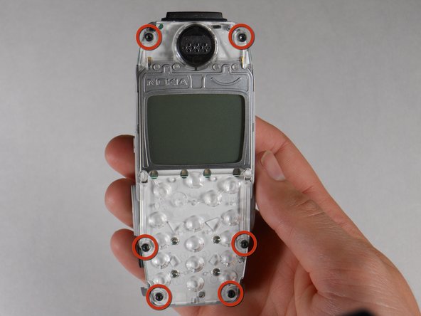

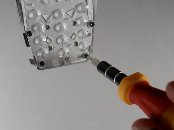

Add Note Edit Step 4 — Screen  ¶
  • Remove six T6 screws.
Image #1 Image #2

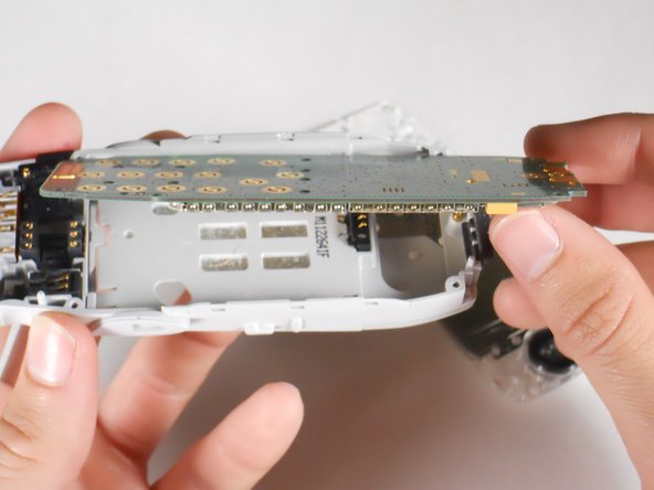

Add Note Edit Step 5  ¶
  • Insert spudger between screen assembly and phone body.
  • Spread apart as shown. Avoid damaging the screen assembly by removing the screen slowly.
Image #1 Image #2
Add Note Edit Step 6 — Logic Board  ¶
  • Remove logic board as shown.
Image #1

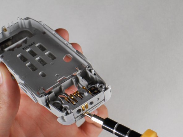

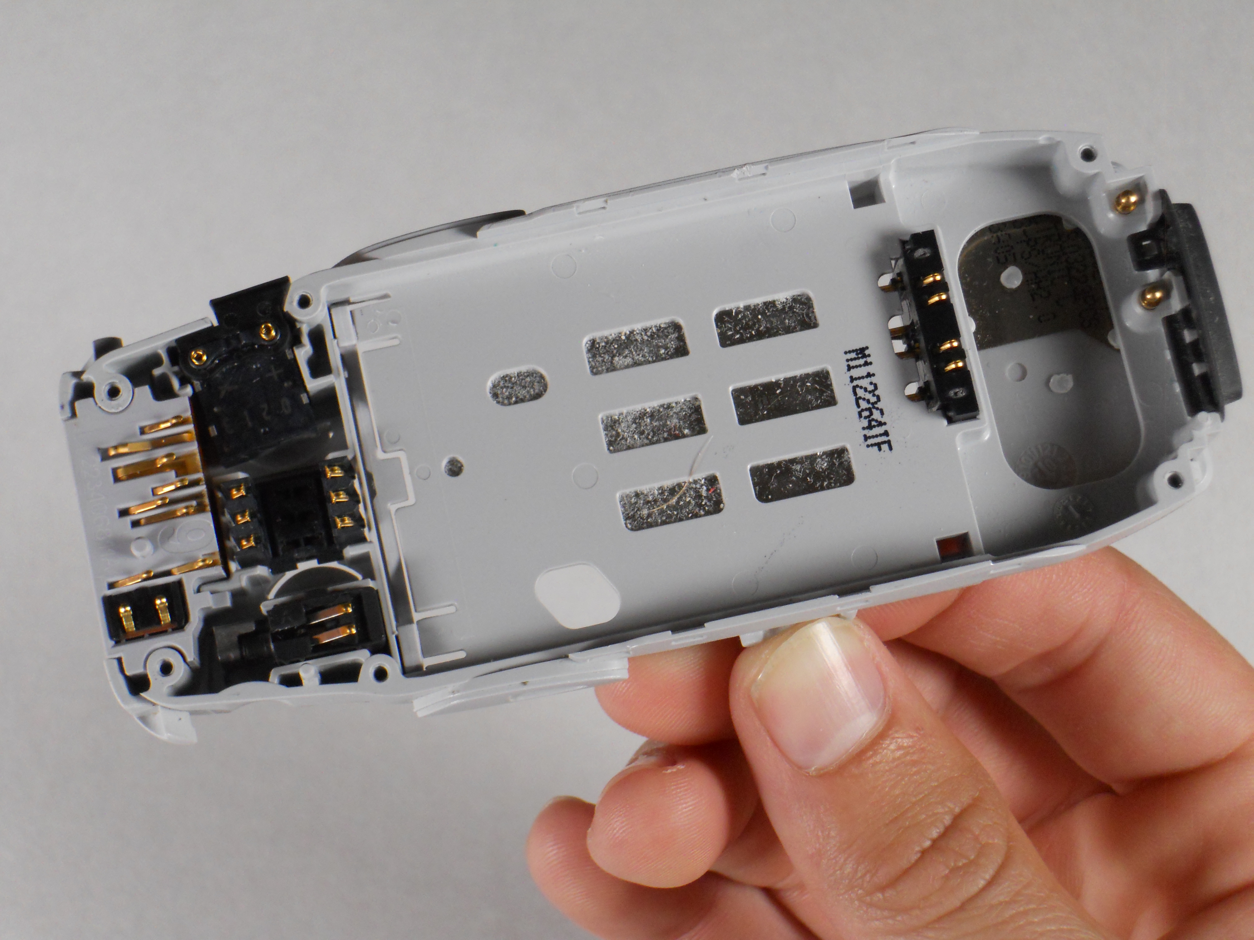

Add Note Edit Step 7 — Inner Components  ¶
    • Use the following legend to locate each component:
      • Microphone/power assembly.
      • Vibrating unit.
      • SIM card reader.
      • Audio speaker.
      • Power toggle button.
      • Battery connector.
Image #1 Image #2

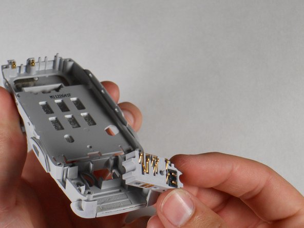

Add Note Edit Step 8  ¶
  • Insert spudger between power assembly/micro-phone and phone body.
  • Pry as shown and remove the power assembly/microphone.
