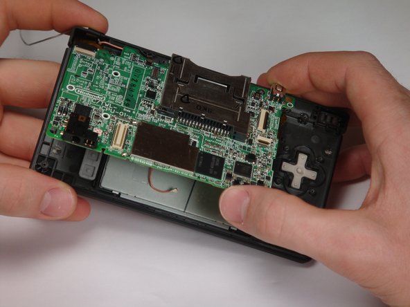

  • Remove 4 Phillips screws from the board.
  • Lift the main board from the bottom end and flip it over to reveal the last connector.
  • Keep the main board fairly close to the case, making sure not to damage the last ribbon cable holding it in place.

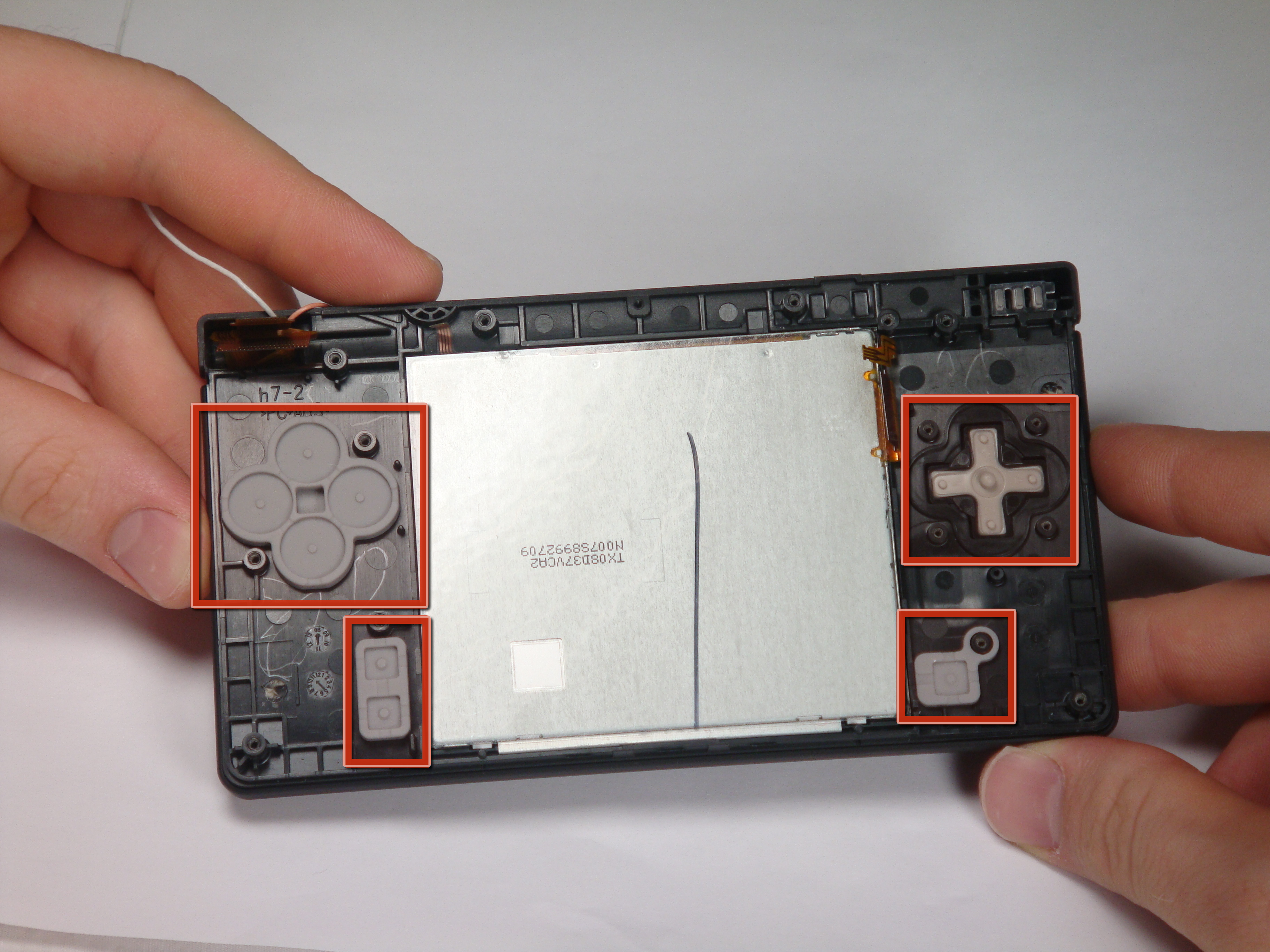

  • Remove the rubber front-panel button membranes from the device. Pay careful attention to where the buttons go, so you can replace them correctly.
    • A/B/X/Y button assembly
    • Select/Start button assembly
    • D-pad
    • Power button
Image #1 Image #2

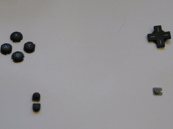

  • Remove the plastic buttons and keep them in a safe place.
  • All of the buttons have "key" notches to prevent them from being inserted incorrectly (backwards or in the wrong place), but it can take a while to figure out where everything goes if they get shuffled around.

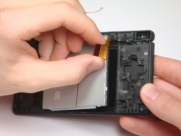

  • Flip the case open, and push the lower screen assembly out of the frame.
