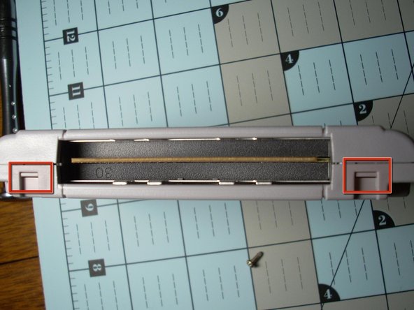

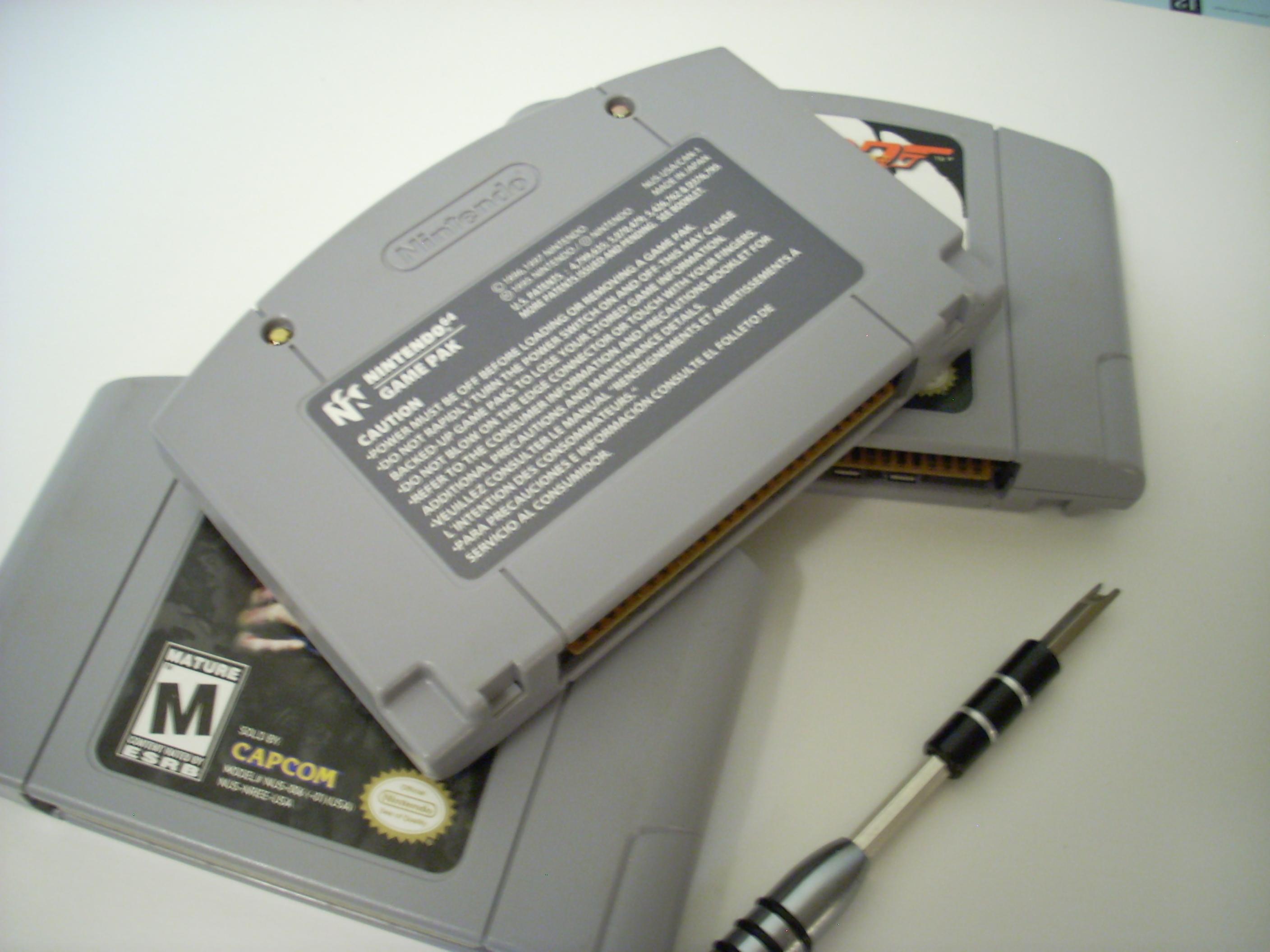

First flip your game over and you'll see two screws using the 3.8mm "Gamebit" screwdriver bit. A 3.0U Spanner bit can also get them out.
Take the screws out and peel the case off starting from the top taking care not to force it due to the tabs at the bottom of the cartridge. Outlined in Red
The two halves of the case should come apart easily.

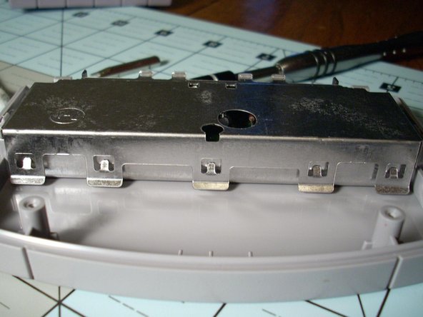

On the inside of the front plastic casing the game board and metal shielding are attached with two Phillips head screws. Unscrew them to remove the shielding and access the game board.
The top of the metal shielding held on with pressure tabs. Be sure to press down firmly when reassembling.

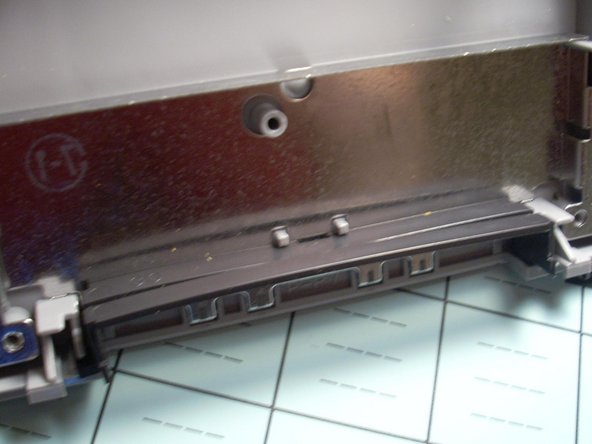

While reassembling the cartridge, remember to put the lower plastic shielding underneath the two pins on the outer casing. There are two like this on both sides.
