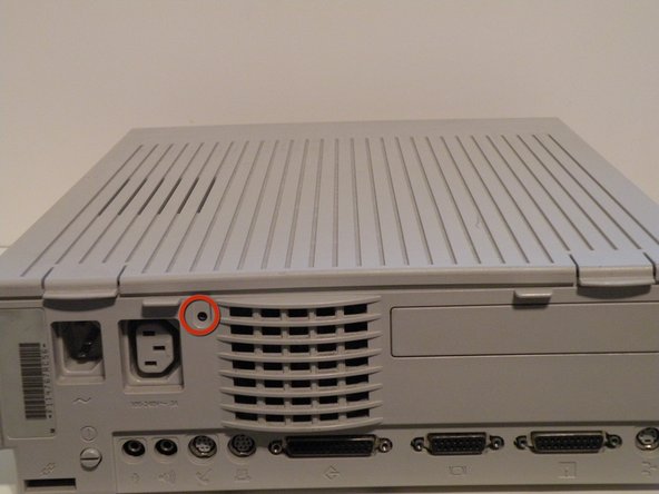

  • Start by turning the computer around, and removing this screw:
  • There may or may not be a Phillips #0 screw here depending on whether or not the computer has ever been serviced.

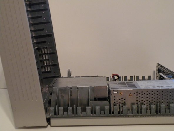

Add Note Edit Step 2  ¶
  • Now lift these two clips, and slowly pivot the case up.
  • You can now seperate the top of the computer from the rest of the machine.

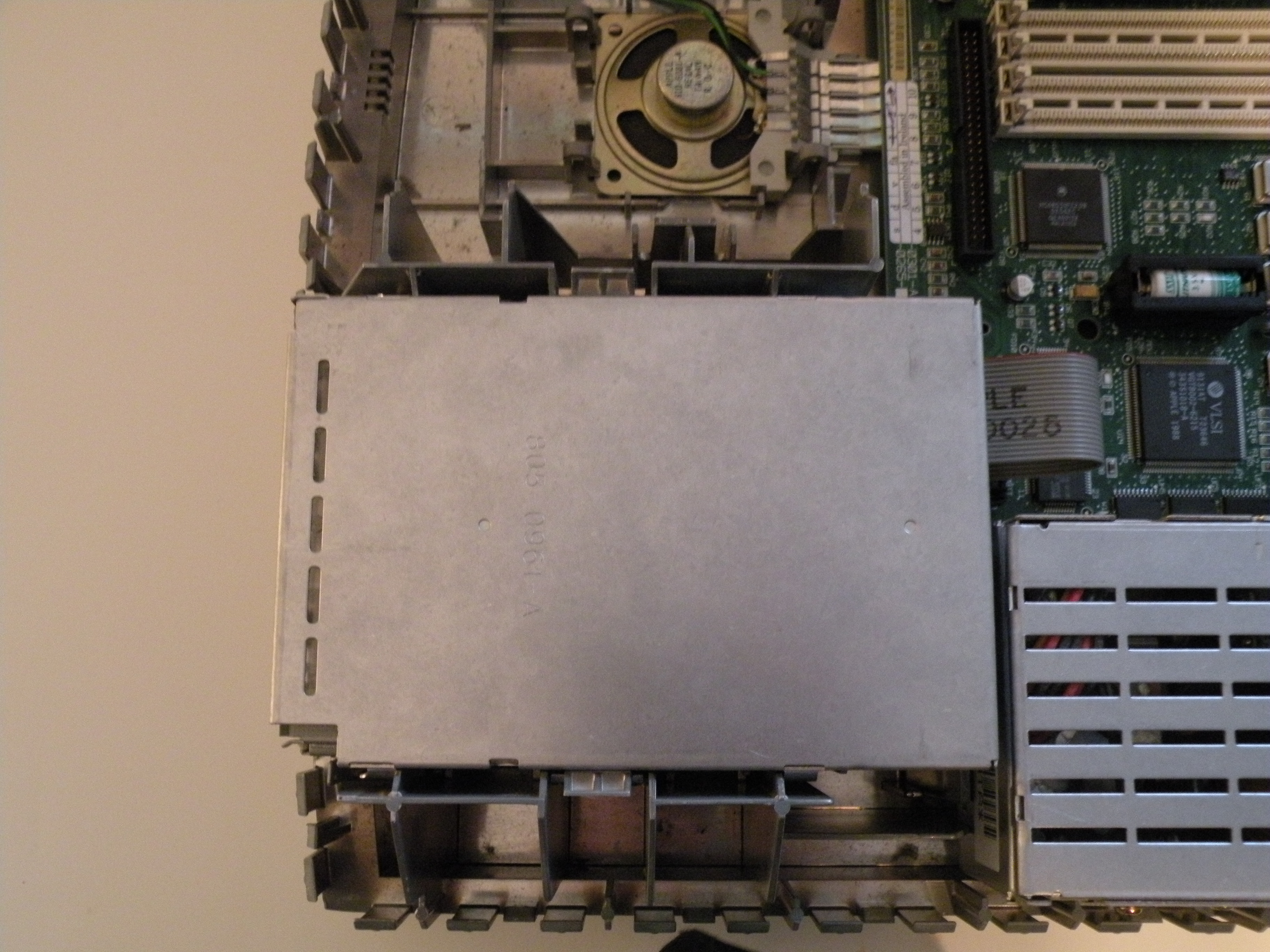

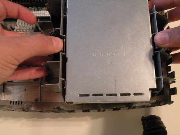

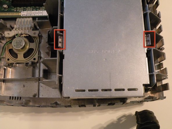

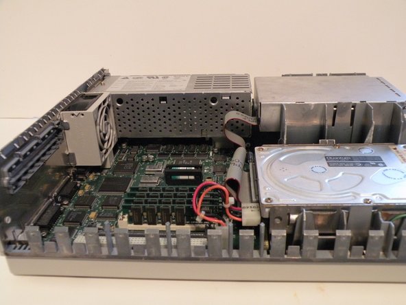

Add Note Edit Step 3 — Floppy Drive  ¶
  • The "SuperDrive" is mounted similarly to the hard drive, and positioned right next to it.
  • Push these two tabs out, and lift the drive up.
first image
thumb image 1
thumb image 2
thumb image 3
Add Note Edit Step 4  ¶

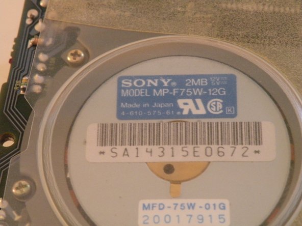

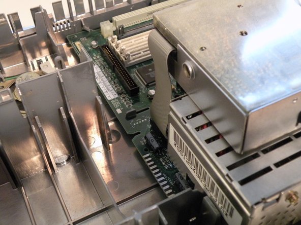

  • Flip the drive so it is on top of the power supply, and remove the "Red-Ribbon" cable.
  • 1.44MB floppy drives need a ribbon cable with a red stripe on one side. 400KB floppy drives use a ribbon cable with a yellow stripe on one side. 800KB floppy drives can use a red, or yellow striped cable.
  • This drive was manufactured by Sony in 1990.
