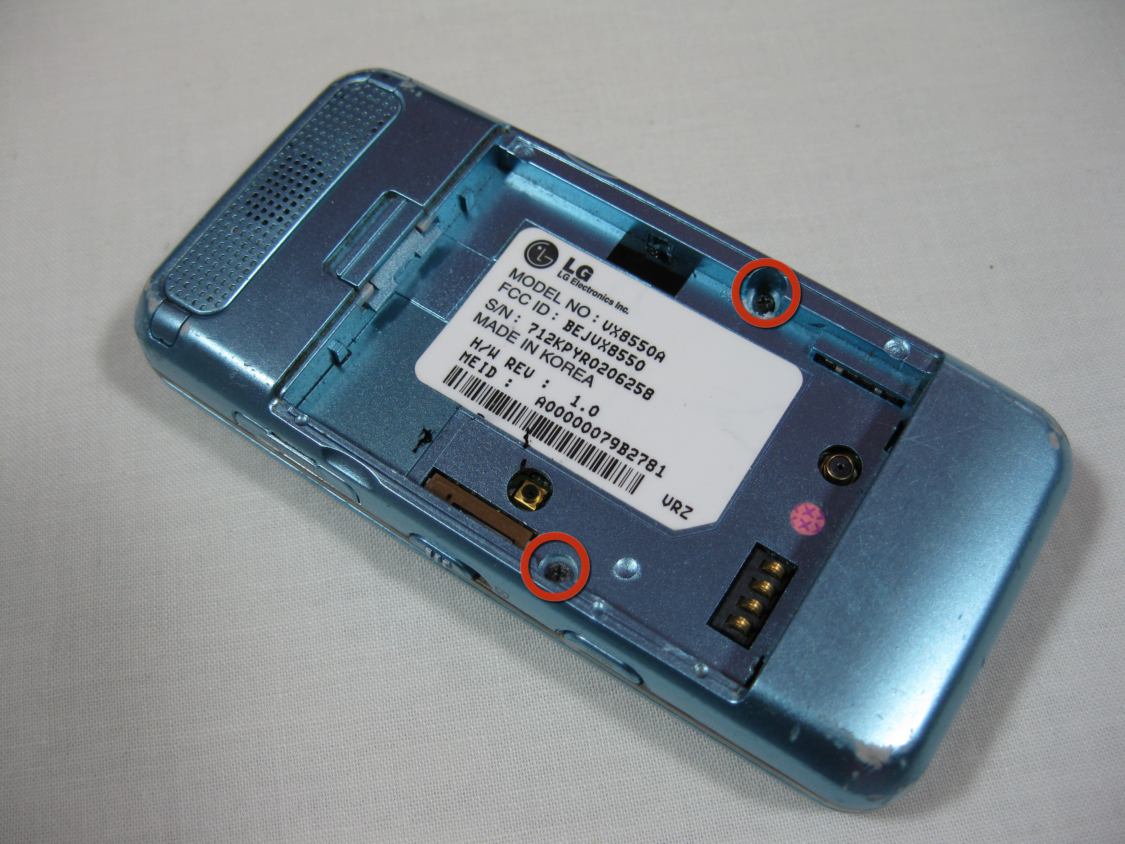

  • Remove the 2 screw covers next to the rear speaker with a Push Pin.
Image #1
Add Note Edit Step 4  ¶
  • Remove the 4 cover screws with a Philips #00 screwdriver.
