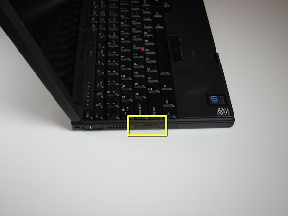

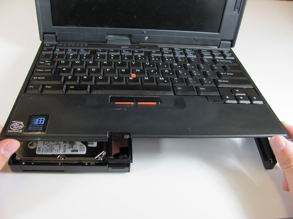

Image #1

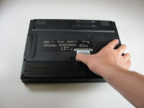

  • Slide the button to the right and hold.
Image #1 Image #2
Add Note Edit Step 2  ¶

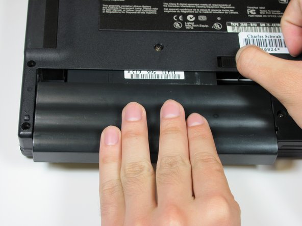

  • Slide the battery out.
Image #1

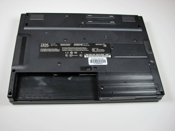

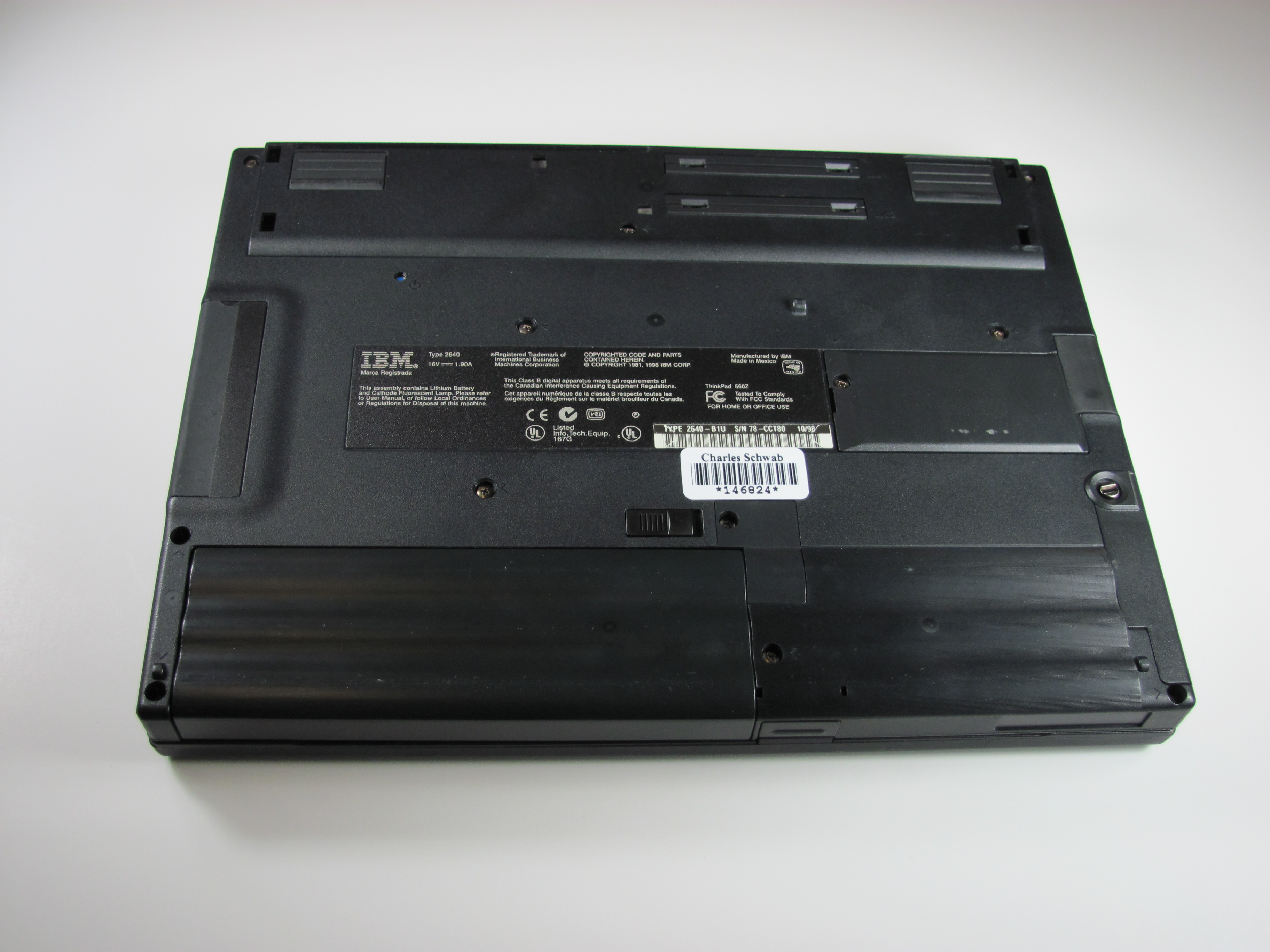

Add Note Edit Step 3 — Upper Case  ¶

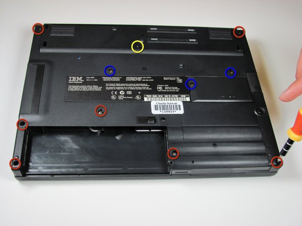

  • Remove the 7 mm Philip screws.
  • Remove the 10 mm Philip screws.
  • Remove the 14 mm Philip screw.
Image #1 Image #2

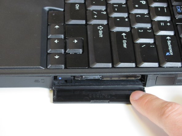

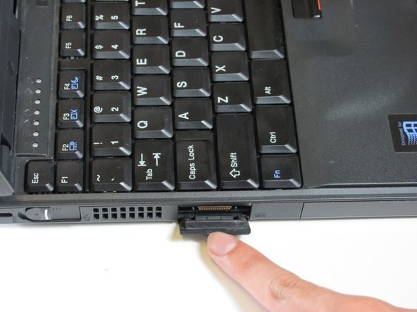

  • Open the flap on the left hand side.
Image #1 Image #2

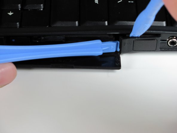

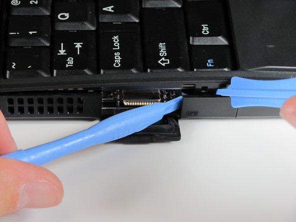

  • Insert the iPod opening tools between the right and left sides of the latch to pry open and release the clips.
Image #1 Image #2

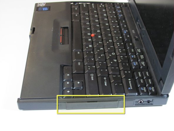

  • Open the flap on the right side.
Image #1

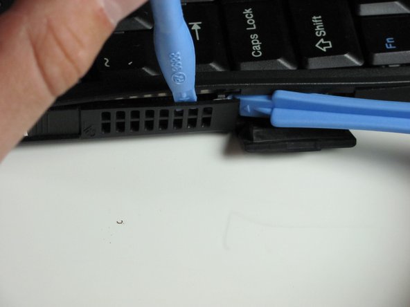

  • Use the iPod opening tools to pry open the latch and release the clips.
Image #1 Image #2

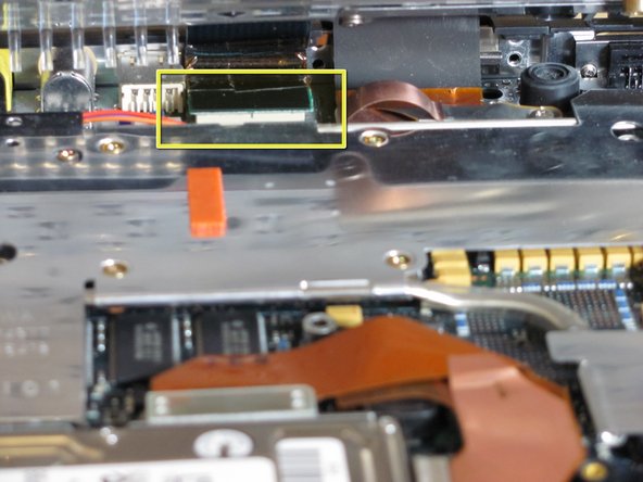

  • Lift the keyboard slowly.
  • The keyboard is attached to the computer via a cable which can be damaged if not careful.
