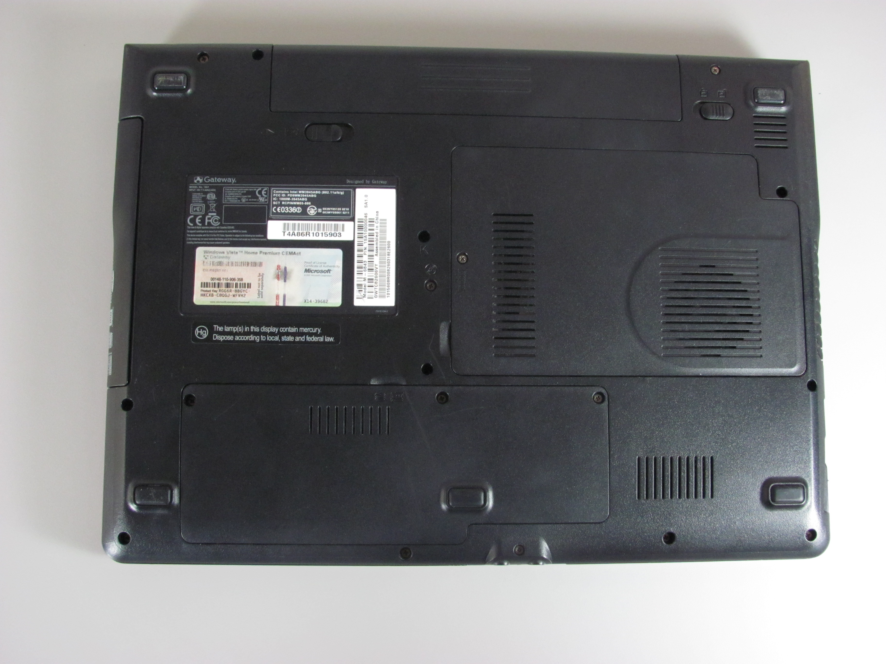

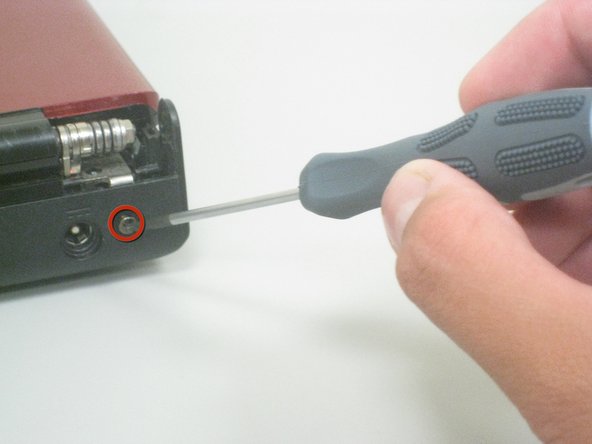

Add Note Edit Step 6 — Outer Casing  ¶
  • Remove twelve 5.9 mm Philips screws from back cover.
  • Remove one 8.8 mm Philips screw.

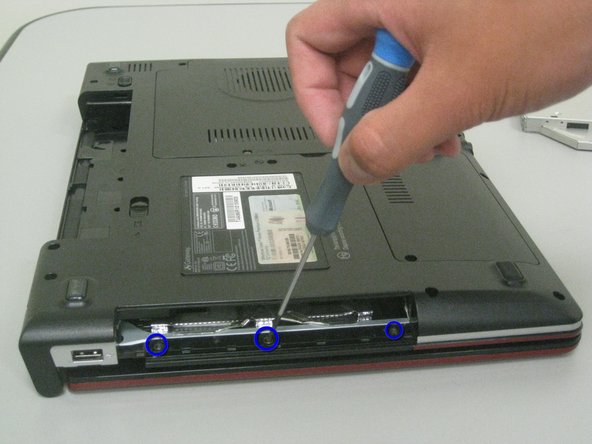

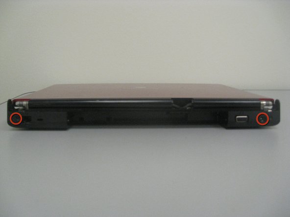

Add Note Edit Step 7  ¶
  • Unscrew two 5.9 mm Philips screws located on the the side closest to the battery.
  • Unscrew three 3.6 mm Philips screws that are within the Disk drive port.

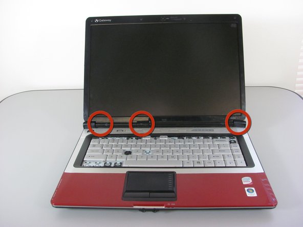

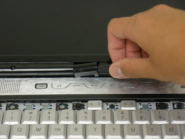

Add Note Edit Step 8  ¶
  • Remove the hinge covers by lifting each with the sharp point of the spudger.
    • Notice that the middle cover has a different shape and is more difficult to remove.
