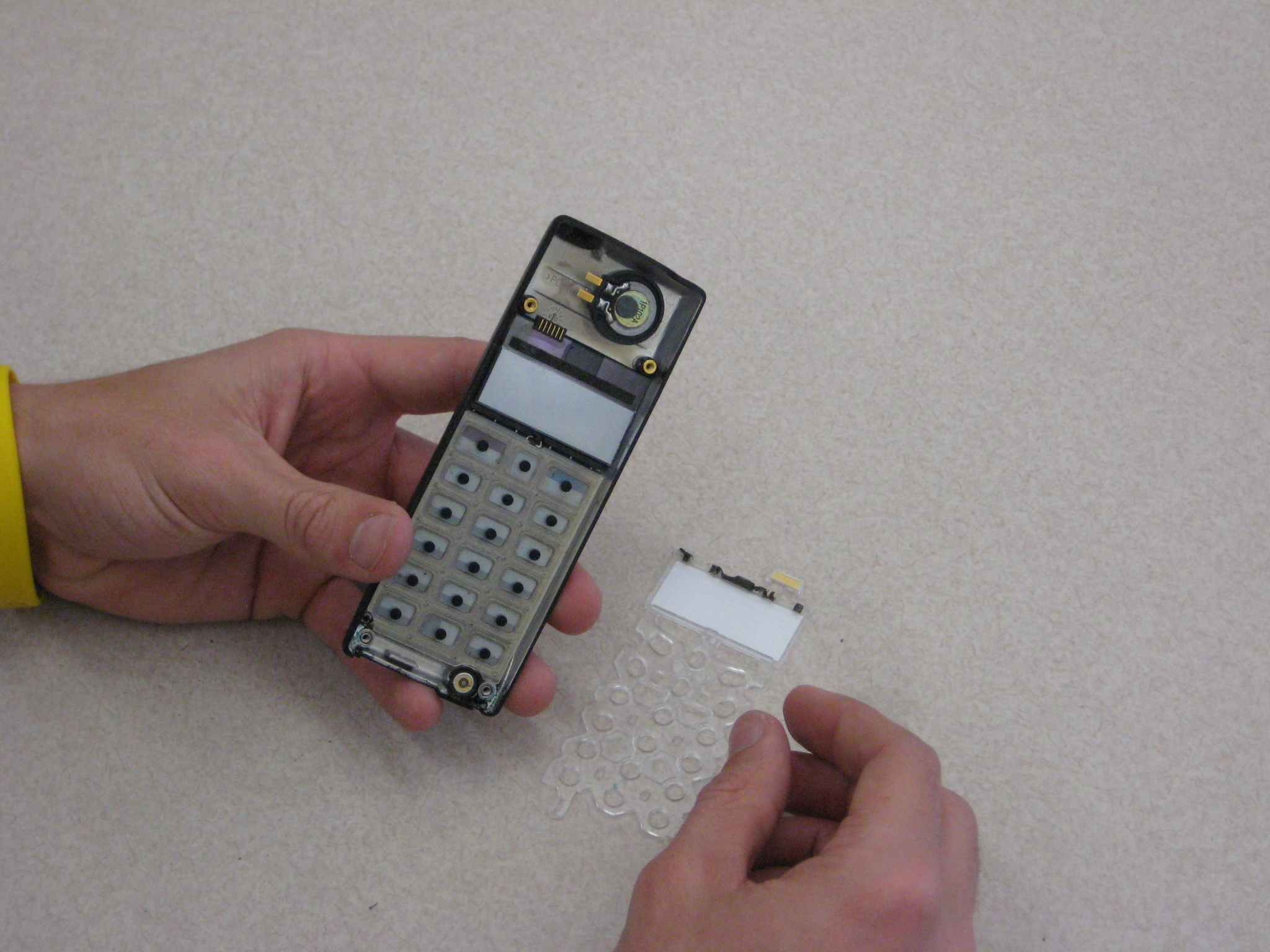

Add Note Edit Step 7 — Speaker  ¶
  • Although it is not completely necessary, removing the plastic keypad skeleton structure helps with the ease of removing the speaker.
  • Locate the speaker at the top of the phone, above the LCD display screen, as shown by the red circle.
Image #1 Image #2
Add Note Edit Step 8  ¶
  • To remove the speaker, gently place a plastic pryer tool underneath the speaker.
  • Carefully, lift up the pryer tool to remove the speaker from the adhesive glue connecting to the phone casing.
  • Note: it is preferred to slowly remove the speaker so the speaker is not flung or damaged. Easy does it.
