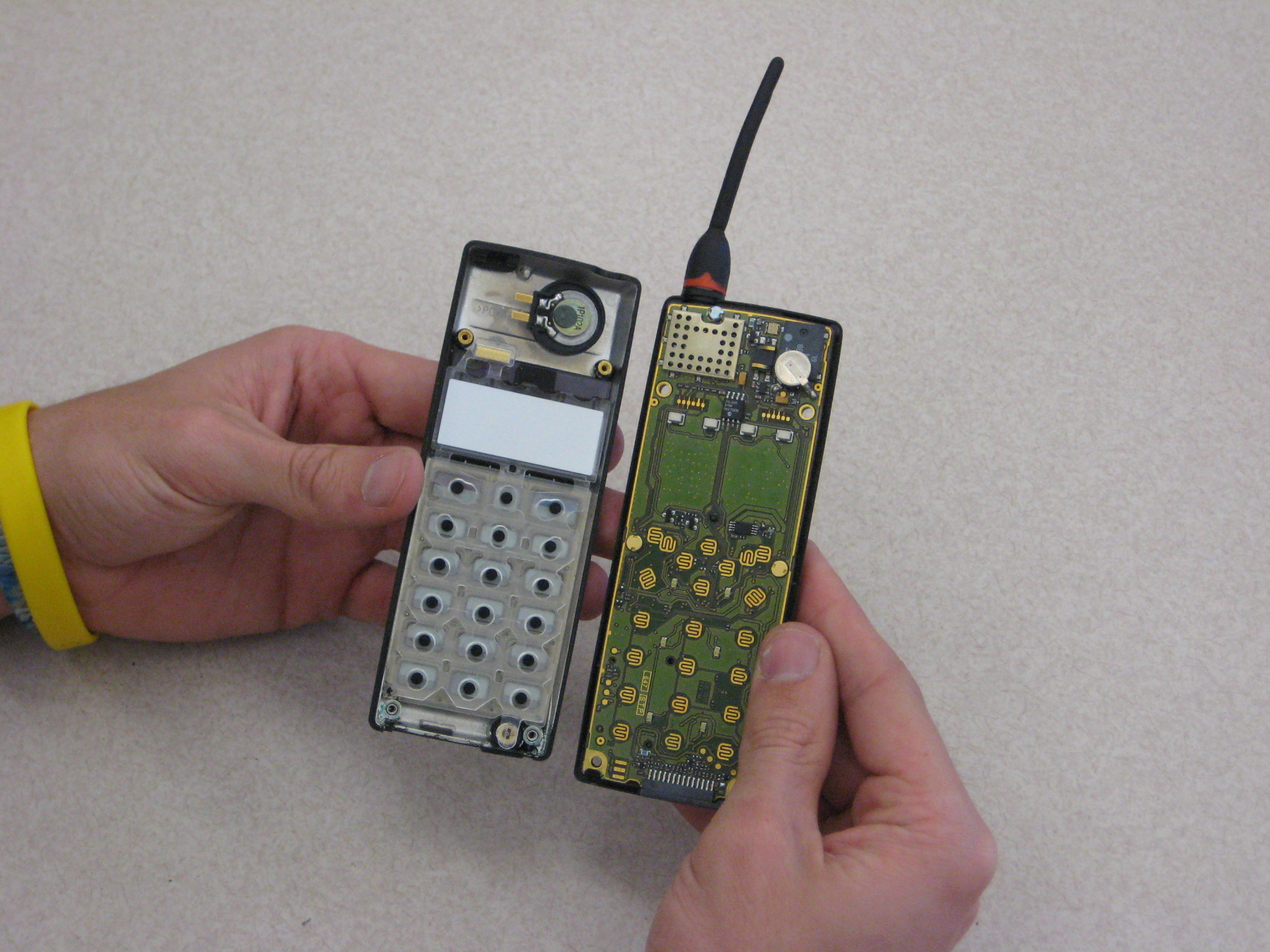

  • Grab opposite panels of the phone casing and carefully open and pull apart the phone, as shown in the image.
  • Note: Be careful not to damage the circuit board and components as you as open the casing.
