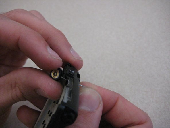

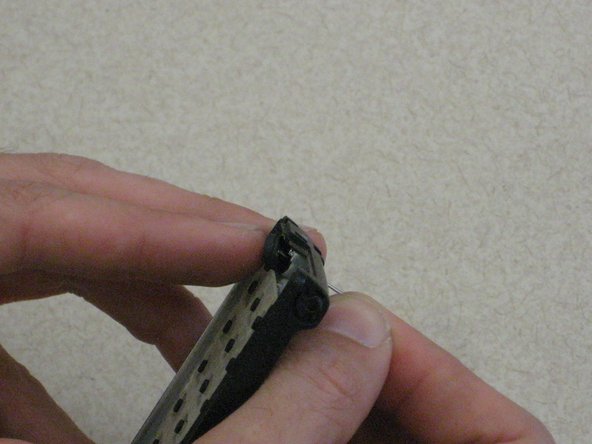

  • To remove the battery from the casing, grab the front panel and back panel with opposite hands (as shown). The back panel is the same as the battery.
  • With your index finger, push in the button on the bottom of the battery to release it.
  • Pull the battery away from the phone.

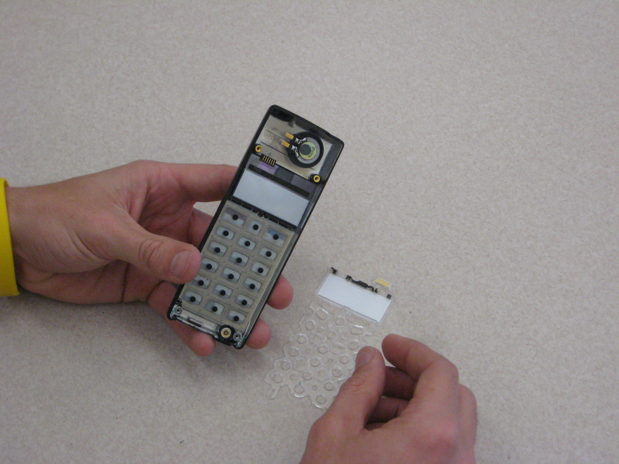

Add Note Edit Step 5 — Keypad Support Skeleton  ¶
  • After removing the battery casing and taking apart the phone casing, the keypad is held in with a plastic skeleton structure as shown.
Image #1 Image #2 Image #3
Add Note Edit Step 6  ¶
  • To remove the plastic skeleton structure, locate the tab at the top of the phone near the LCD display screen.
  • Carefully remove the skeleton by holding on the front phone casing with one hand and pull tab with your index finger while having your thumb at the bottom of the phone as shown.

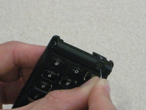

Add Note Edit Step 8  ¶
  • To remove the microphone, carefully poke out the microphone through the front hole with a paper clip.
  • Slowly and carefully, push the microphone out.
  • Note: Do not push too hard as it could damage or fling the microphone. You don't want to lose it!
