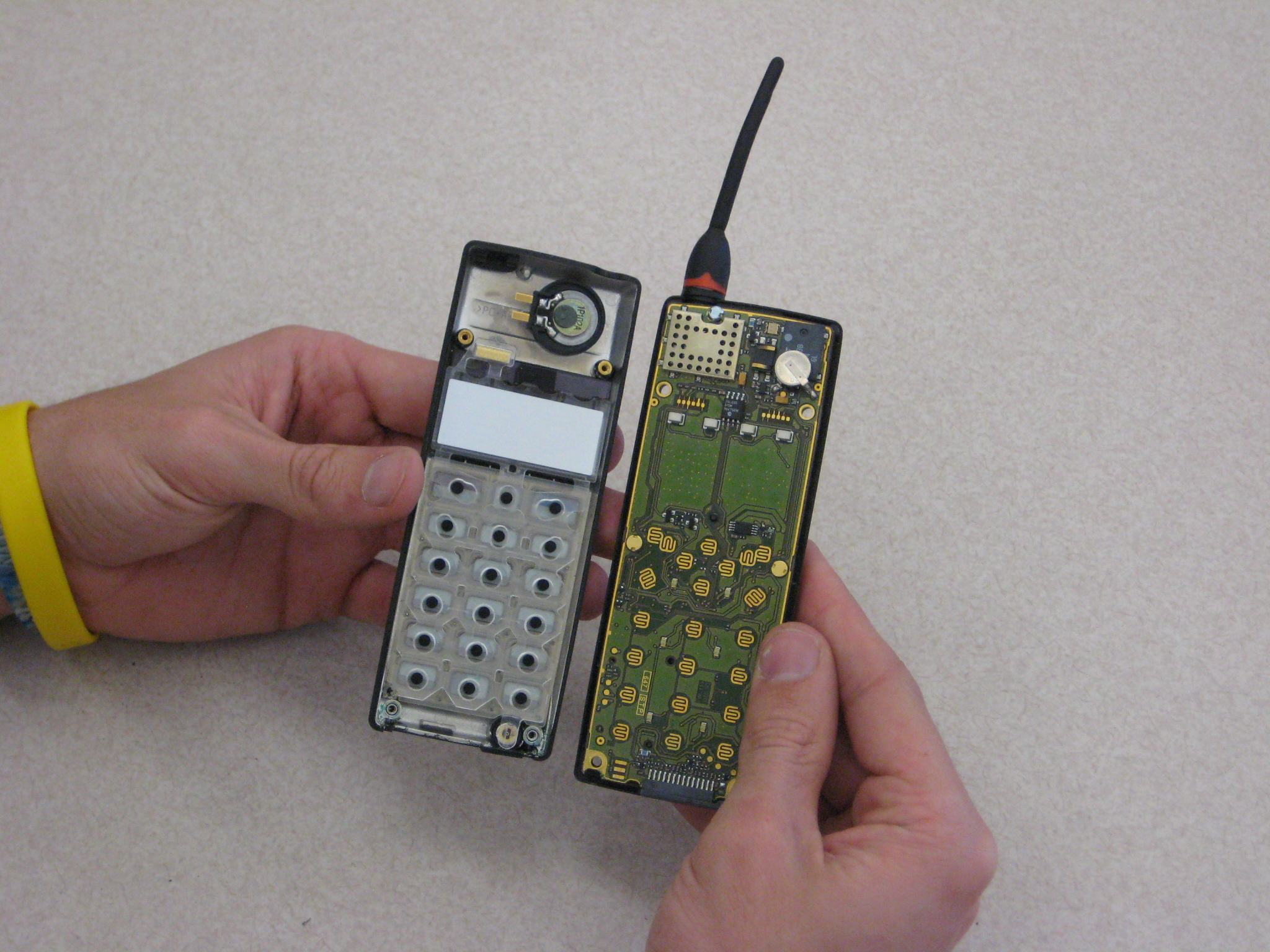

  • Grab opposite panels of the phone casing and carefully open and pull apart the phone, as shown in the image.
  • Note: Be careful not to damage the circuit board and components as you as open the casing.
Image #1 Image #2
Add Note Edit Step 5 — Keypad Support Skeleton  ¶
  • After removing the battery casing and taking apart the phone casing, the keypad is held in with a plastic skeleton structure as shown.
Image #1 Image #2 Image #3
Add Note Edit Step 6  ¶
  • To remove the plastic skeleton structure, locate the tab at the top of the phone near the LCD display screen.
  • Carefully remove the skeleton by holding on the front phone casing with one hand and pull tab with your index finger while having your thumb at the bottom of the phone as shown.
