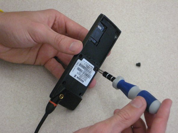

  • After removing the battery, the front phone casing becomes accessible.
  • Locate the two star-shaped T6 screws on the bottom end of the rear of the phone, underneath the battery, as indicated by the red circles.
  • Remove these two screws using the Torx T6 Screwdriver.

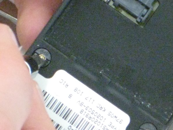

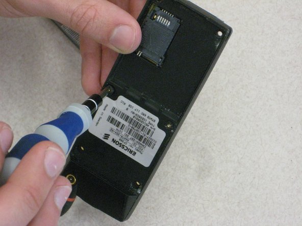

  • Locate the top two U-shaped screws on the back of the phone, as shown by the red circles.
  • Remove these two screws with a SP 2.6 screw driver.
  • Note: Remove gray plastic grommets with screws.

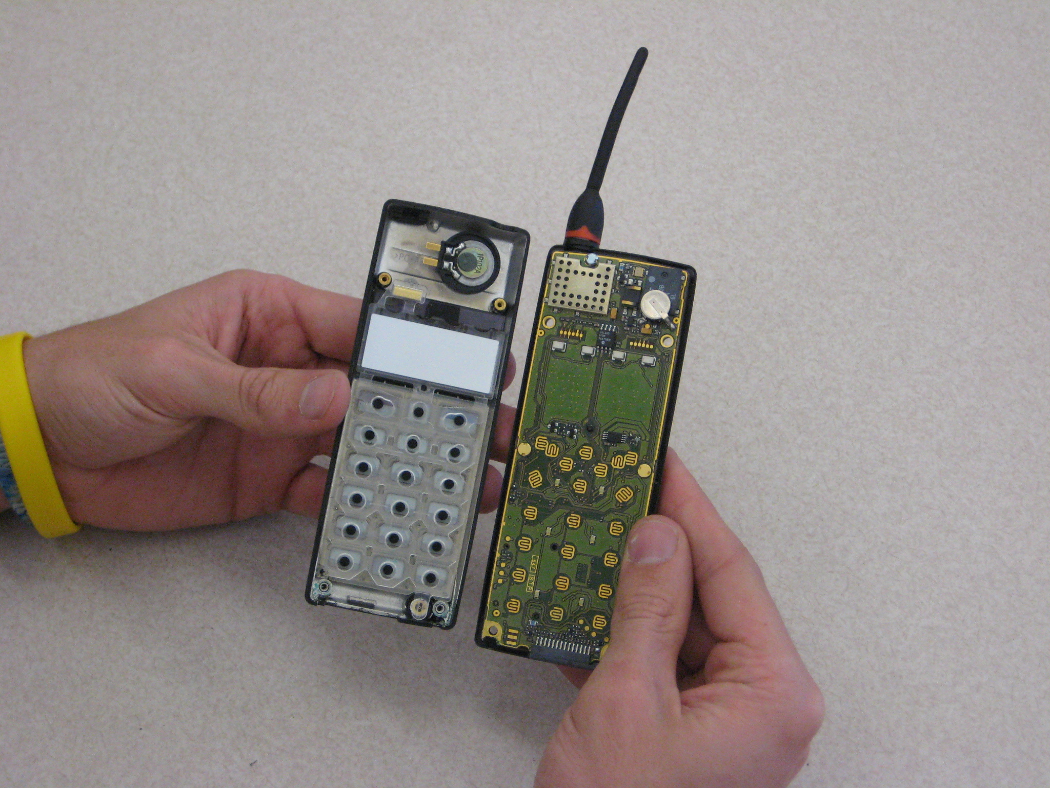

  • Grab opposite panels of the phone casing and carefully open and pull apart the phone, as shown in the image.
  • Note: Be careful not to damage the circuit board and components as you as open the casing.
Image #1

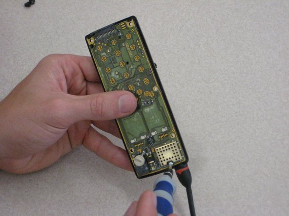

Add Note Edit Step 5 — Circuit Board  ¶
  • Locate the circuit board on the rear side of the front phone casing (right side of image).
  • Locate the mounting screws (indicated by red circles), which attach the board to the rear side of the front phone casing.
Image #1 Image #2 Image #3

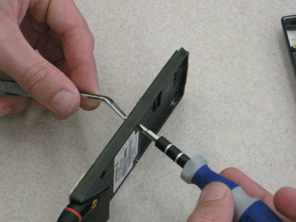

Add Note Edit Step 6  ¶

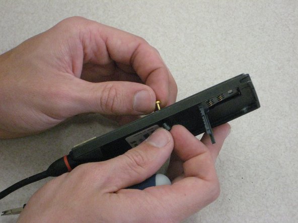

  • Using the SP2.6 u-shaped screw driver in one hand, loosen and remove both center screws. Hold the back part of the screw with the metal tweezers.
Image #1 Image #2
Add Note Edit Step 7  ¶
  • Completely remove the two center screw as shown.
  • Note: the hand not holding the screw driver is holding the back part of the screw and the panel in place.

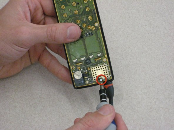

Add Note Edit Step 8  ¶
  • Locate the final screw at the top of the phone near the antenna, as shown by the red circle.
  • Using the U-shaped screw driver, remove the top screw.
