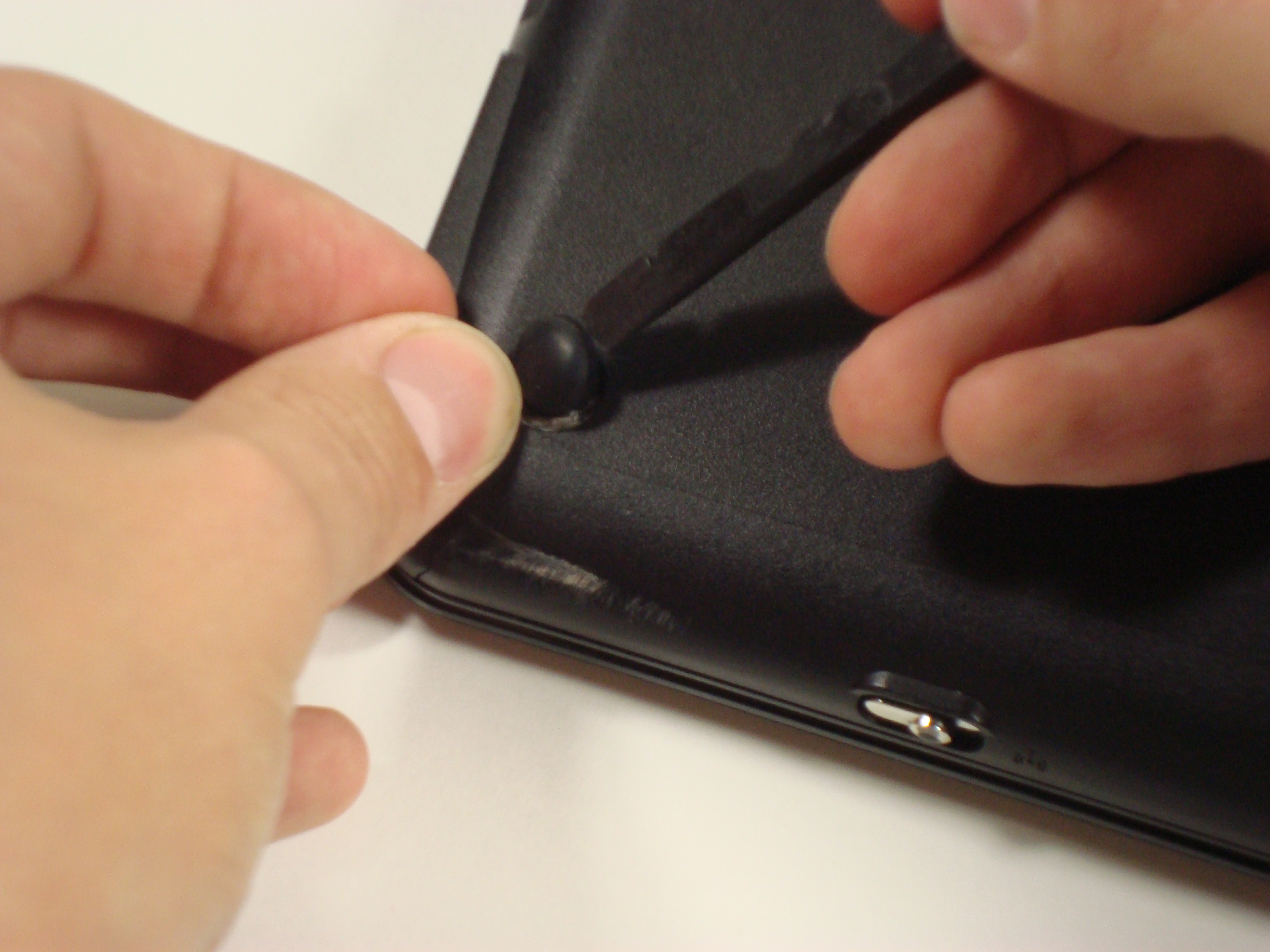

Add Note Edit Step 5 — Keyboard  ¶
  • Remove the rubber pads located on the corners of your Compaq Mini.
  • There may be junk underneath it. This is residue left from the glue that held on the rubber pad. Just scrape it away to find the screw.
first image
thumb image 1
thumb image 2
