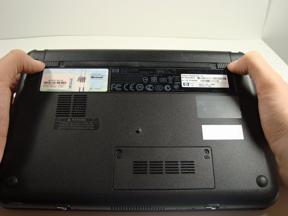

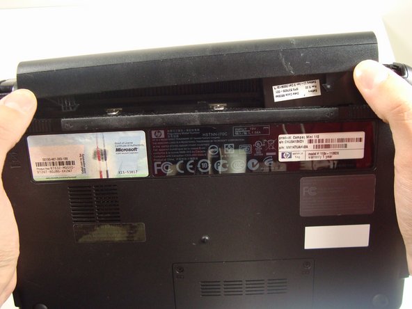

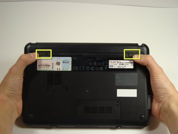

  • Find the battery and the battery tabs located on the bottom of the Compaq Mini.
first image
thumb image 1
thumb image 2
thumb image 3
Add Note Edit Step 2  ¶

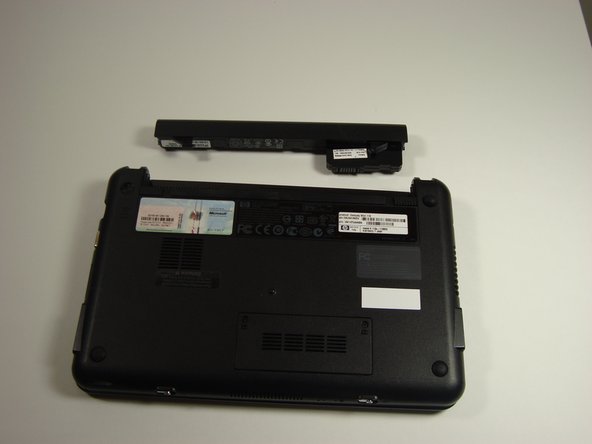

  • Push the tabs inward and slide the battery out.

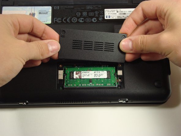

  • Find and remove the two screws on the bottom of your Compaq Mini covering the memory compartment.
    • Note that the screws are attached to the panel.
first image

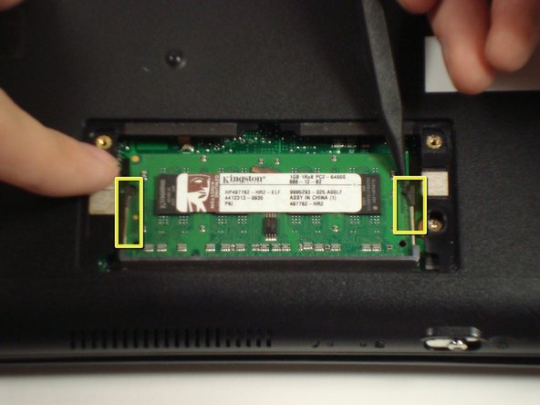

Add Note Edit Step 4  ¶
  • Push out side tabs.

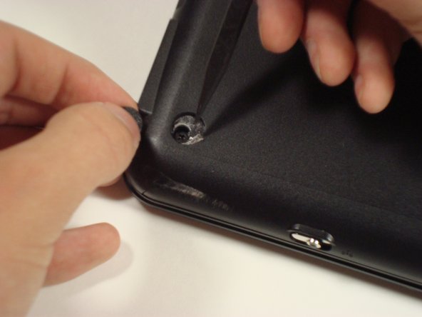

Add Note Edit Step 5 — Keyboard  ¶
  • Remove the rubber pads located on the corners of your Compaq Mini.
  • There may be junk underneath it. This is residue left from the glue that held on the rubber pad. Just scrape it away to find the screw.
first image
thumb image 1
thumb image 2

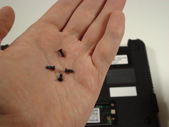

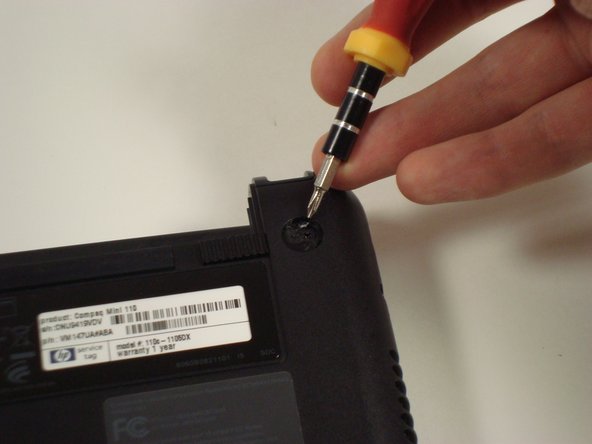

Add Note Edit Step 6  ¶
  • Unscrew all the corner screws. There are four total, one under each rubber pad.

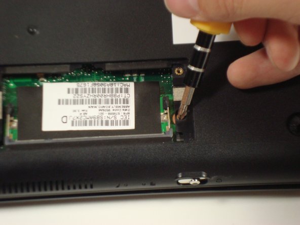

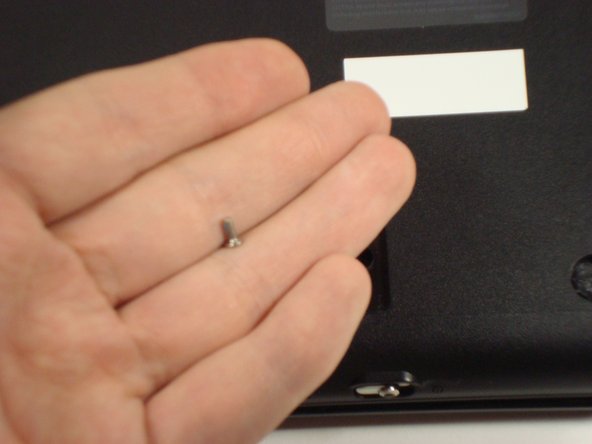

Add Note Edit Step 7  ¶
  • Unscrew the screw for the bottom case located in the RAM compartment.
first image

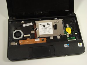

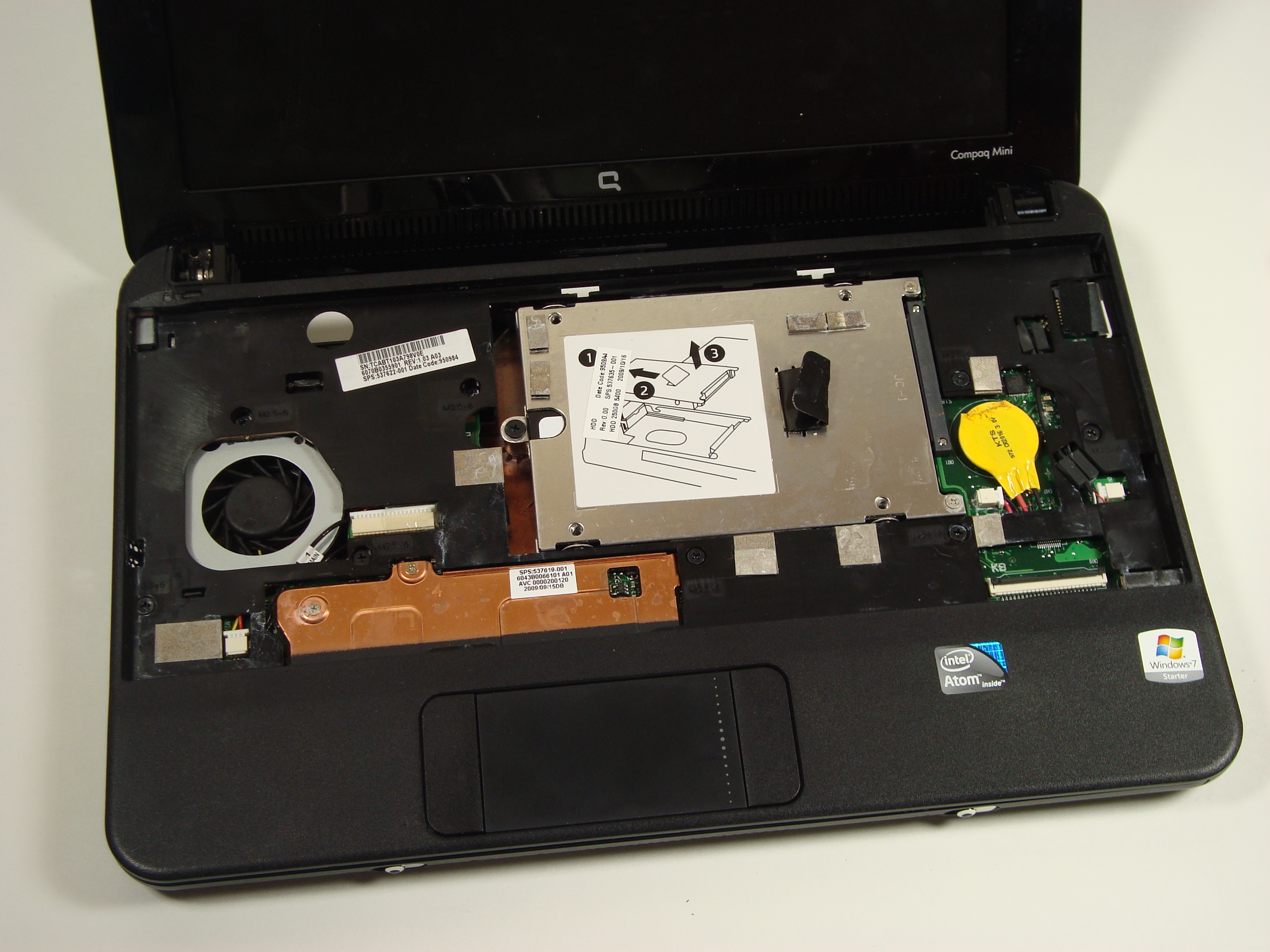

Add Note Edit Step 9 — Hard Drive  ¶
  • Remove the three screws.
first image
thumb image 1
thumb image 2
Add Note Edit Step 10  ¶
  • Pull up on the tab.
