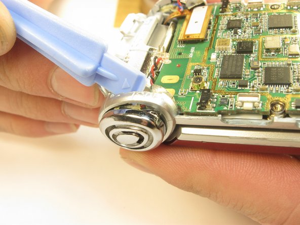

  • Push the speaker out of the phone using the spudger.
Image #1
Add Note Edit Step 10  ¶
  • Remove the speaker from the decorative housing by pulling on the wires.
  • The speaker can be replaced if needed.

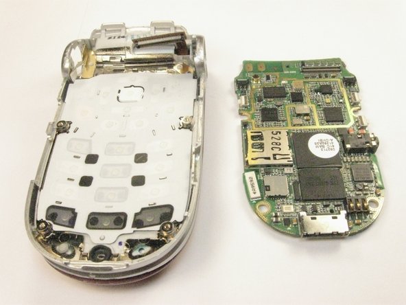

Add Note Edit Step 11 — Removing the Logic Board  ¶
  • Using the spudger or your fingers, unplug the connection that connects the display screen to the logic board.
Image #1
Add Note Edit Step 12  ¶
  • Use a spudger to pry the logic board away from phone housing at the tabs on both sides of the phone at the pictured location. Some force may be required.
Image #1
Add Note Edit Step 13  ¶
  • The logic board will pop out.
  • The logic board can be replaced if needed.
