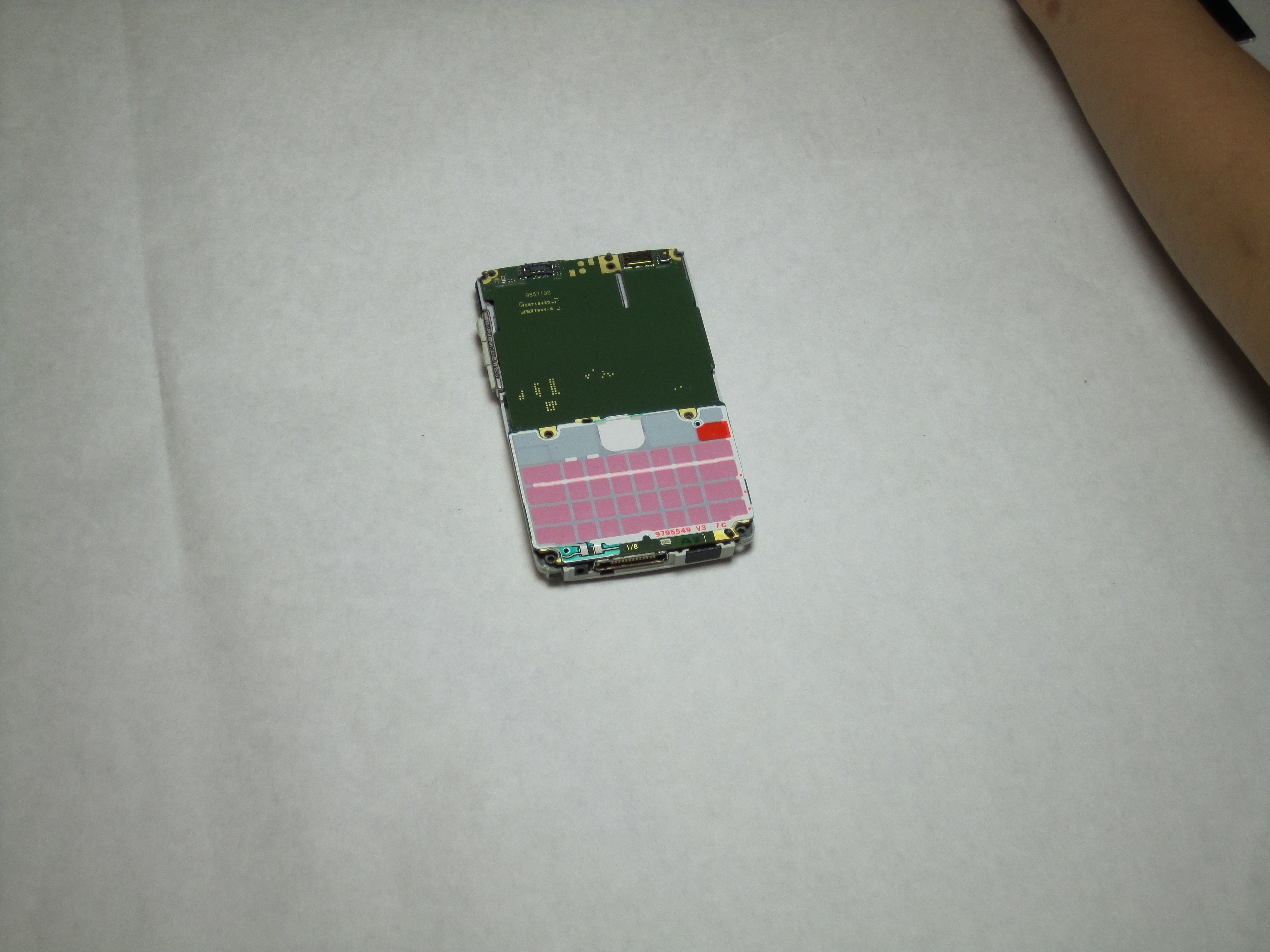

Add Note Edit Step 8 — Logic Board  ¶
  • Finally, after the screen and keyboard have been taken off, there is nothing securing the logic board to the rest of the phone. Simply pull the green logic board from the back casing.
  • Once free from the back of the phone, the logic board can be replaced by a new one.
