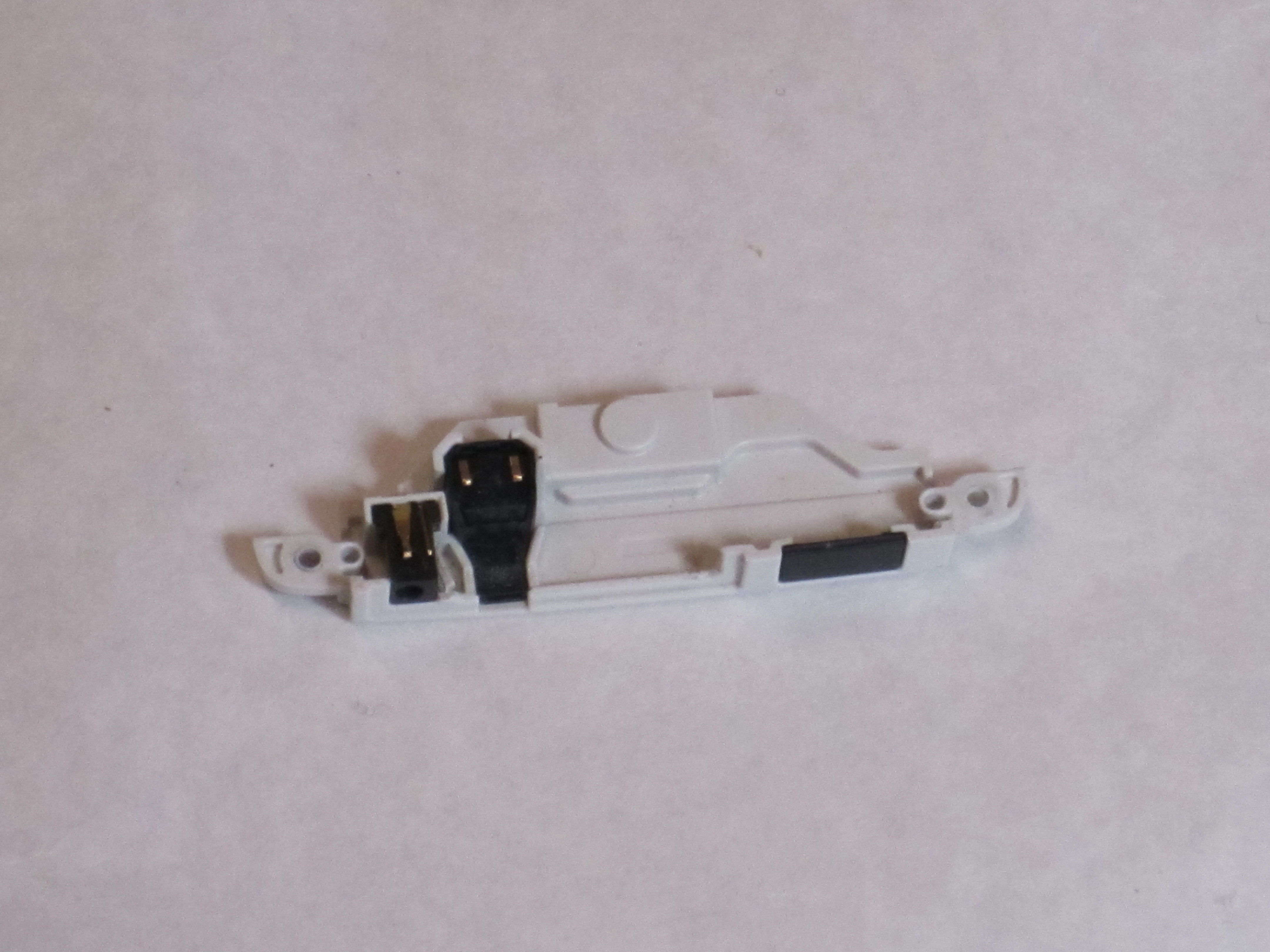

Image #1
Add Note Edit Step 9 — Connector Housing  ¶
  • With the back panel, you will slowly take the Connector Housing by first pushing and sliding it off the back panel.
  • *Notice* Be very careful not to lose the small loose spring from behind the button or the small buttton itself. So do this step slowly.
Image #1
Add Note Edit Step 10 — Headset Jack  ¶
  • After the Connector Housing has been removed, there is nothing else holding the Headset Jack in place. Simply remove if from the housing by pulling up.
  • EDIT: The connection socket shown in the red square is actually the POWER IN socket.
