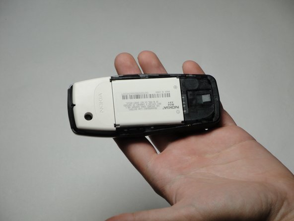

Add Note Edit Step 1 — Back Cover  ¶
  • Press down on the release latch on the bottom of the cover.
  • Once the latch is released, lift the cover from the phone.

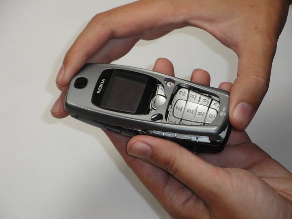

Add Note Edit Step 2 — Keypad  ¶
  • Lift the front case off of the phone body.

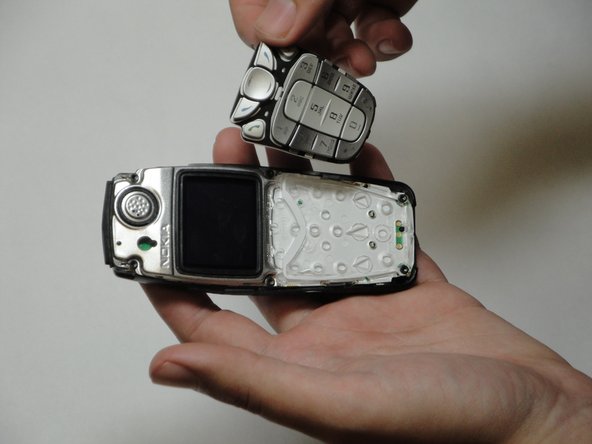

Add Note Edit Step 3  ¶
  • Lift the keypad off of the phone.

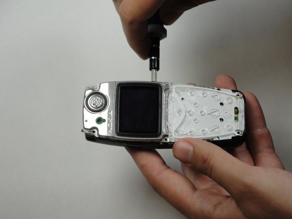

Add Note Edit Step 4 — LCD Display  ¶

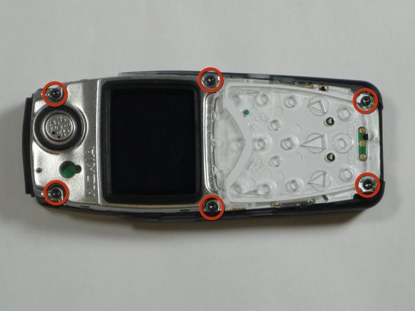

  • The screen is held to the body by six screws.
Image #1

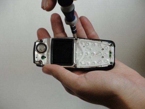

Add Note Edit Step 5  ¶
  • Unscrew the six screws with a Torx screwdriver (six-pointed star shaped bit).
Image #1 Image #2

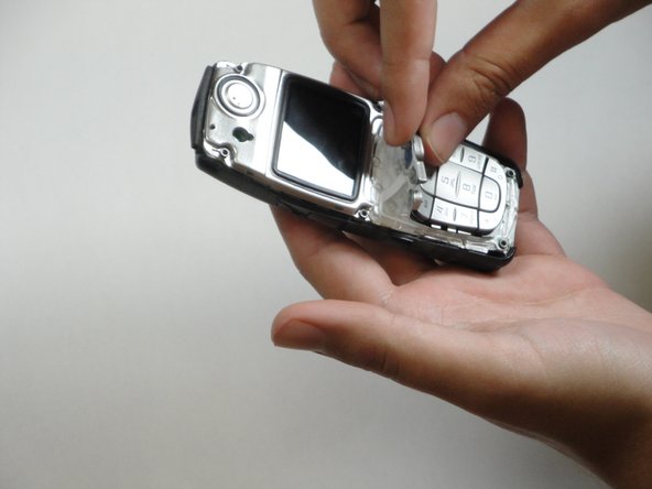

Add Note Edit Step 6  ¶

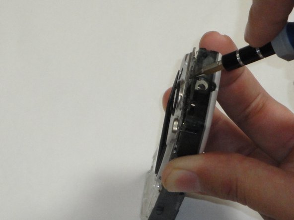

  • Insert a flat screwdriver between the black body and plastic layer.
Image #1
Add Note Edit Step 7  ¶
  • Pry the layers apart. The LCD and plastic layer will lift out as one piece.

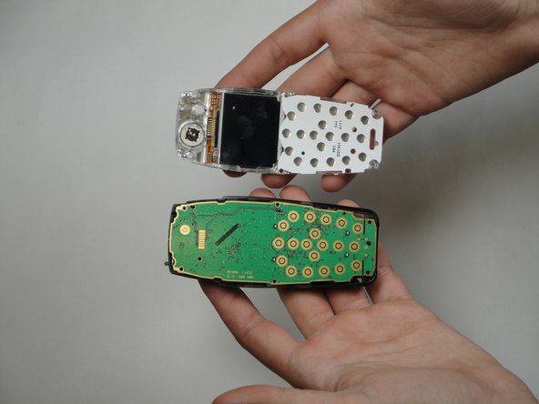

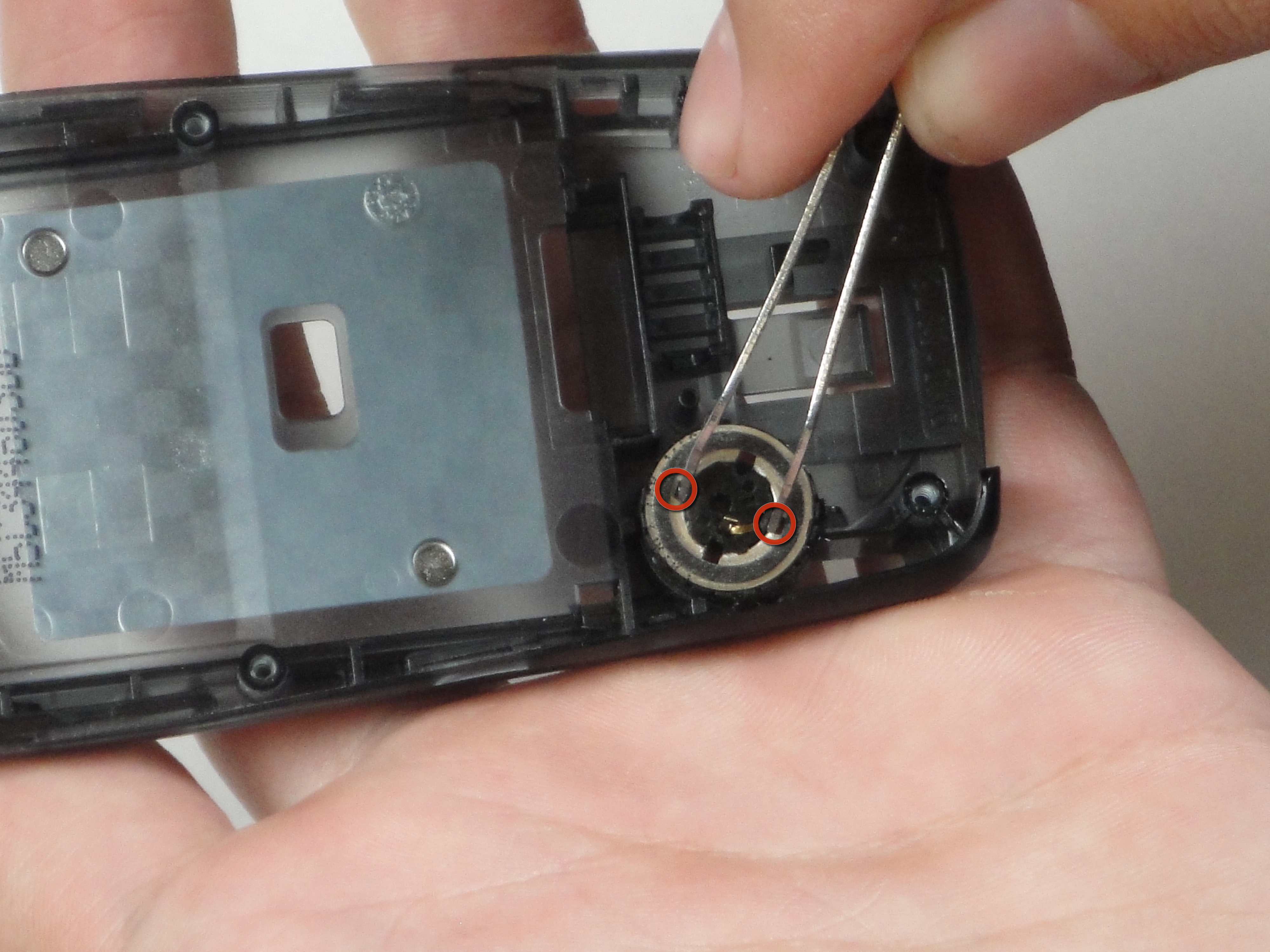

Add Note Edit Step 8 — Logic Board  ¶
  • With the screws removed, the logic board can then be lifted out of the body by hand.
