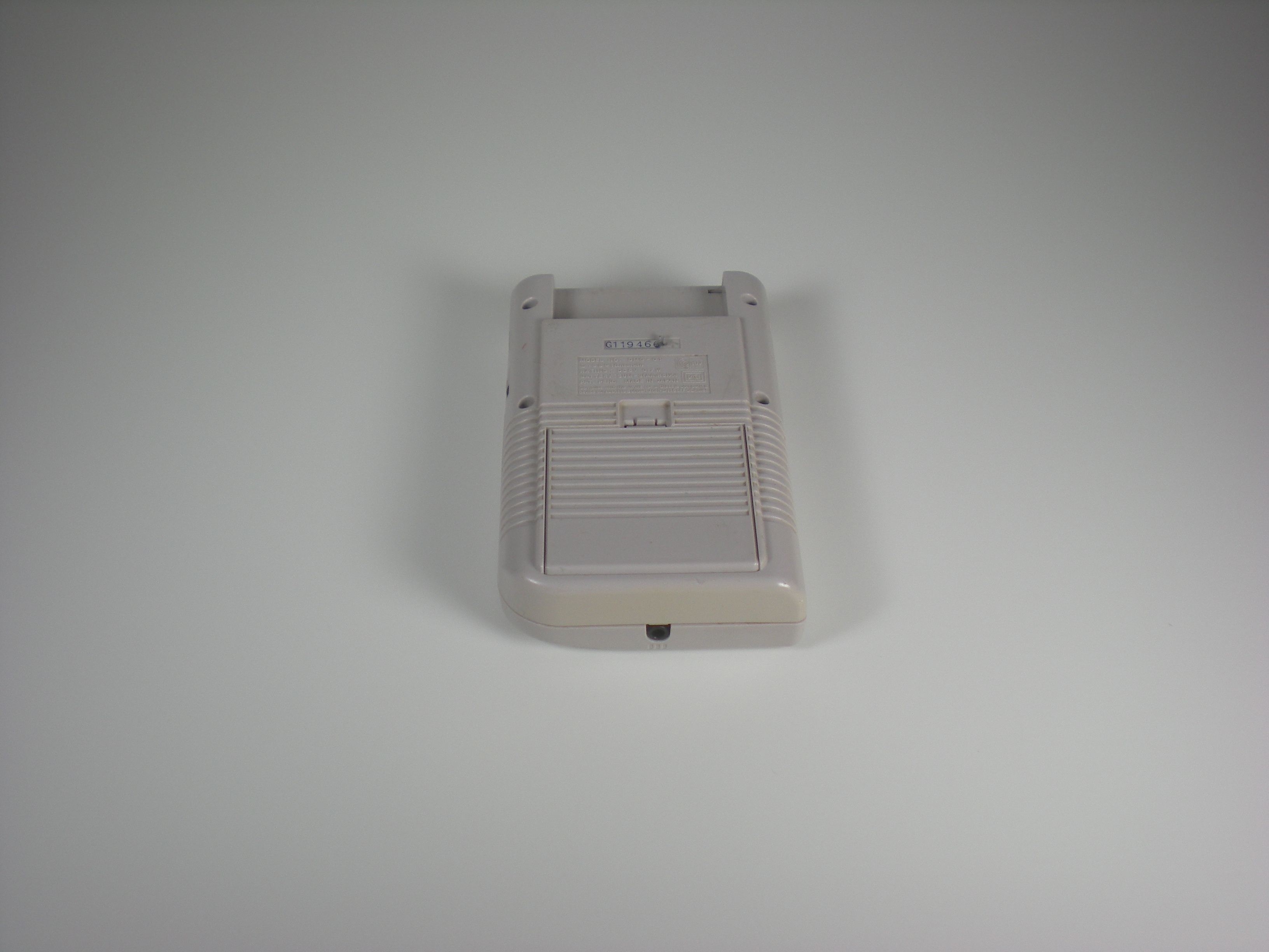

  • The Gameboy system uses four (4) AA batteries.
  • Turn over the Game Boy system and note the closed battery compartment.
