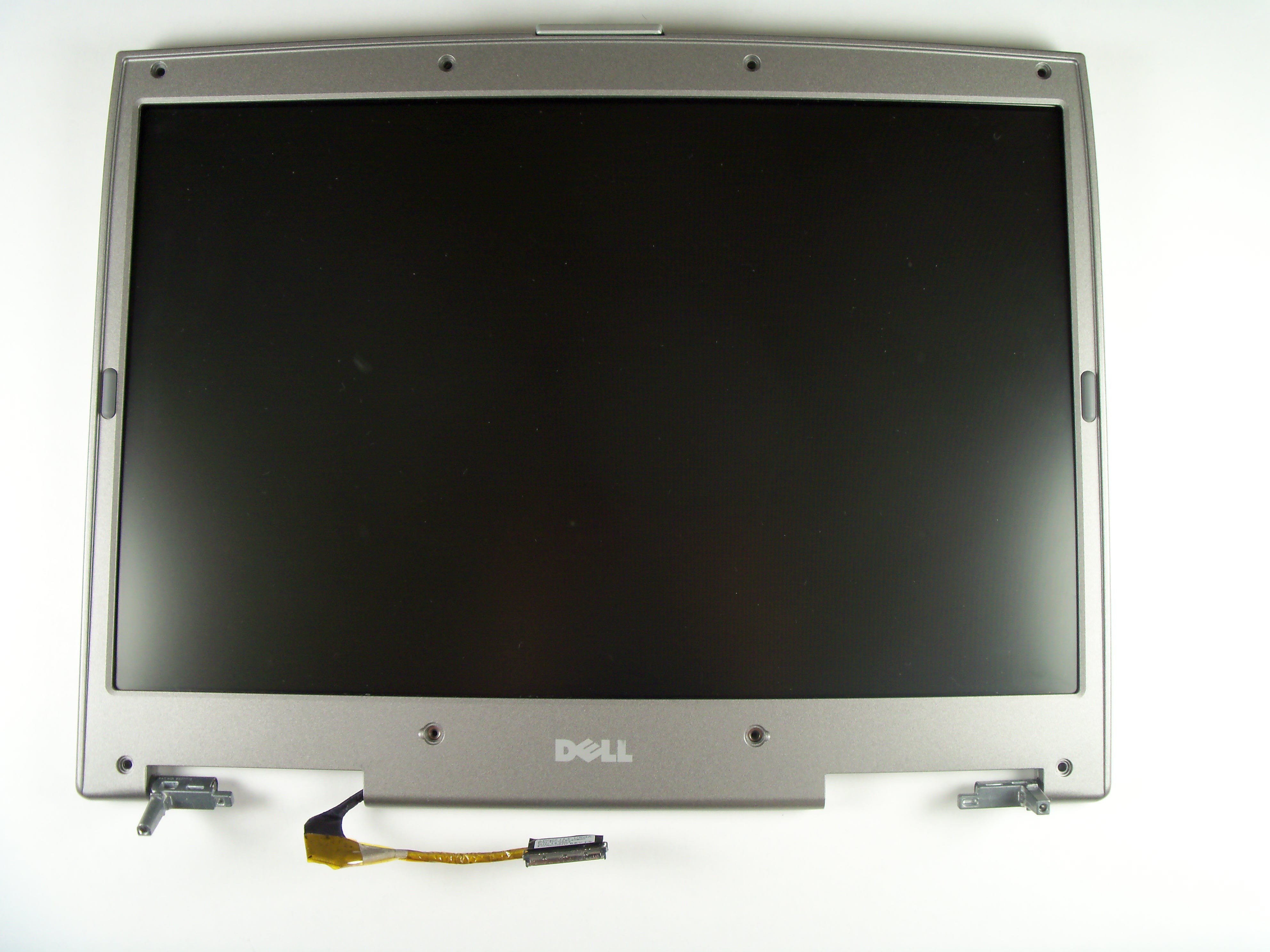

Add Note Edit Step 7  ¶
  • The display module has been removed.
