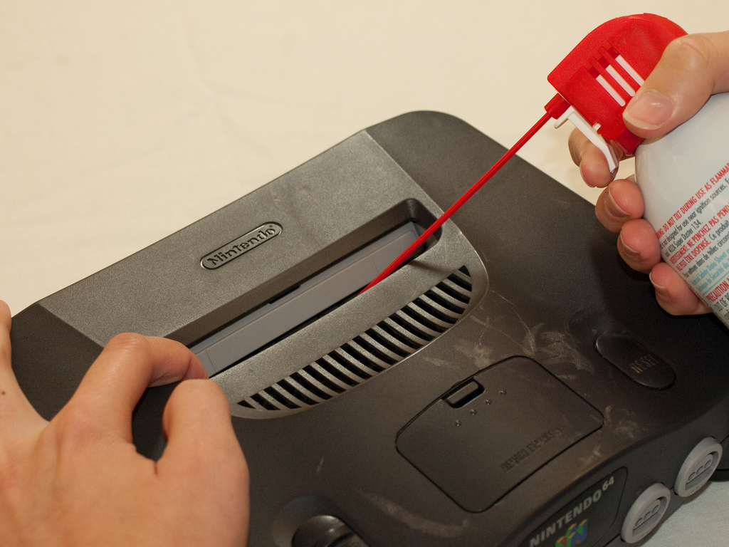

Cleaning the cartridge slot will fix most of the problems with the Nintendo 64.
Image #1
Add Note Edit Step 1 — Cleaning the Cartridge Slot  ¶
  • Open the slot with your finger. Blow along the length of the cartridge slot with the air duster.
Image #1
Add Note Edit Step 2  ¶
  • Moist the q-tip with rubbing alcohol. Rub it along the length of the cartridge slot.
