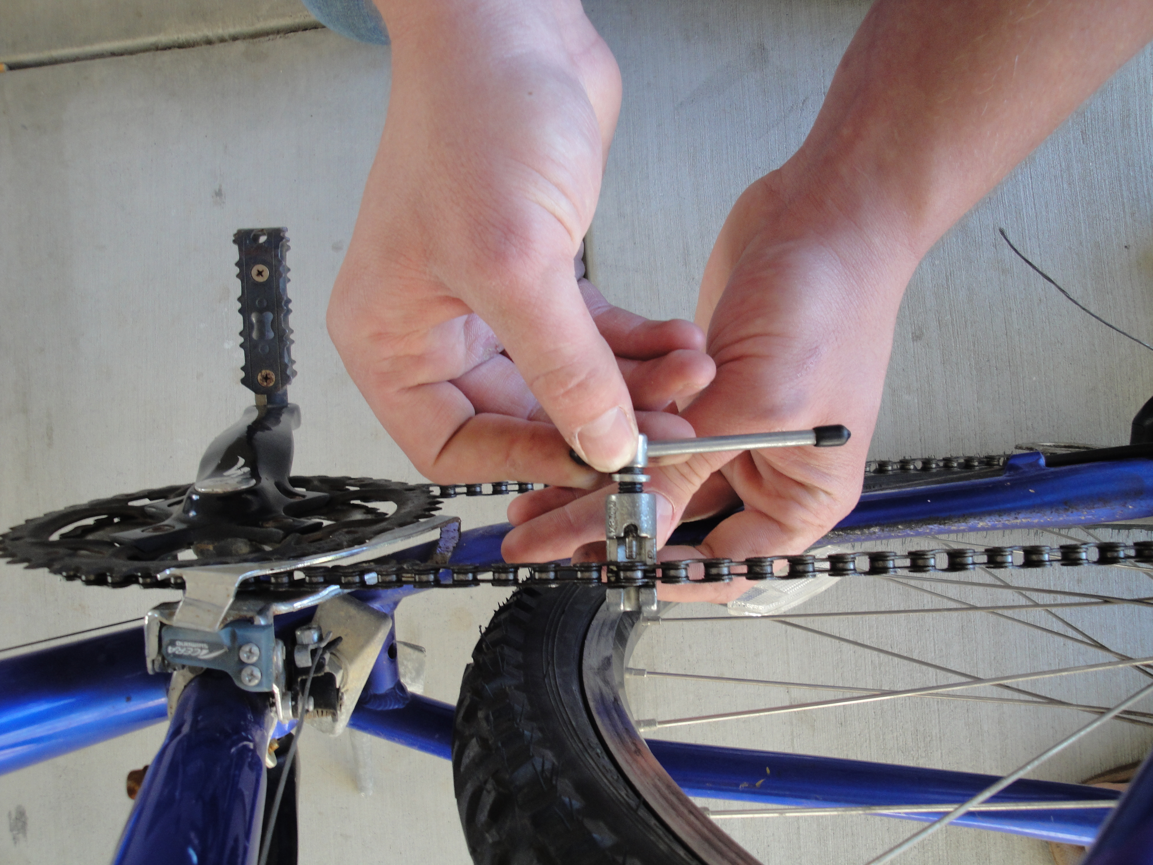

Be careful to not force the pin in or out incorrectly. If it is difficult to press the pin through the chain, the tool is most likely not aligned up properly. Greasing the threads of the chain cutting tool will make it easier to press in or out the pin.

Add Note Edit Step 1 — Chain Breaking  ¶
  • Slide the chain cutting tool onto the desired link.
  • Align the push pin of the tool with the pin on the chain, and tighten the tool until the pin protrudes out the other side without falling all the way out.
Image #1
Add Note Edit Step 2  ¶
  • Stop pushing the pin out when it is just held in by the outer link, so it doesn't fall all the way out. You will still be able to separate the links.
  • If necessary, repeat the previous step to take off sections of links.

Add Note Edit Step 4  ¶
  • Use the chain cutter tool to press the chain pin back through the chain link. If it is difficult to push it back in, the links are not aligned properly. Realign and try again if this is the case.
  • Reusing pins in chains can cause the chain to fail. This is because the pins are press fit into link. Using a new pin when assembling a chain is recommend for long term use.
