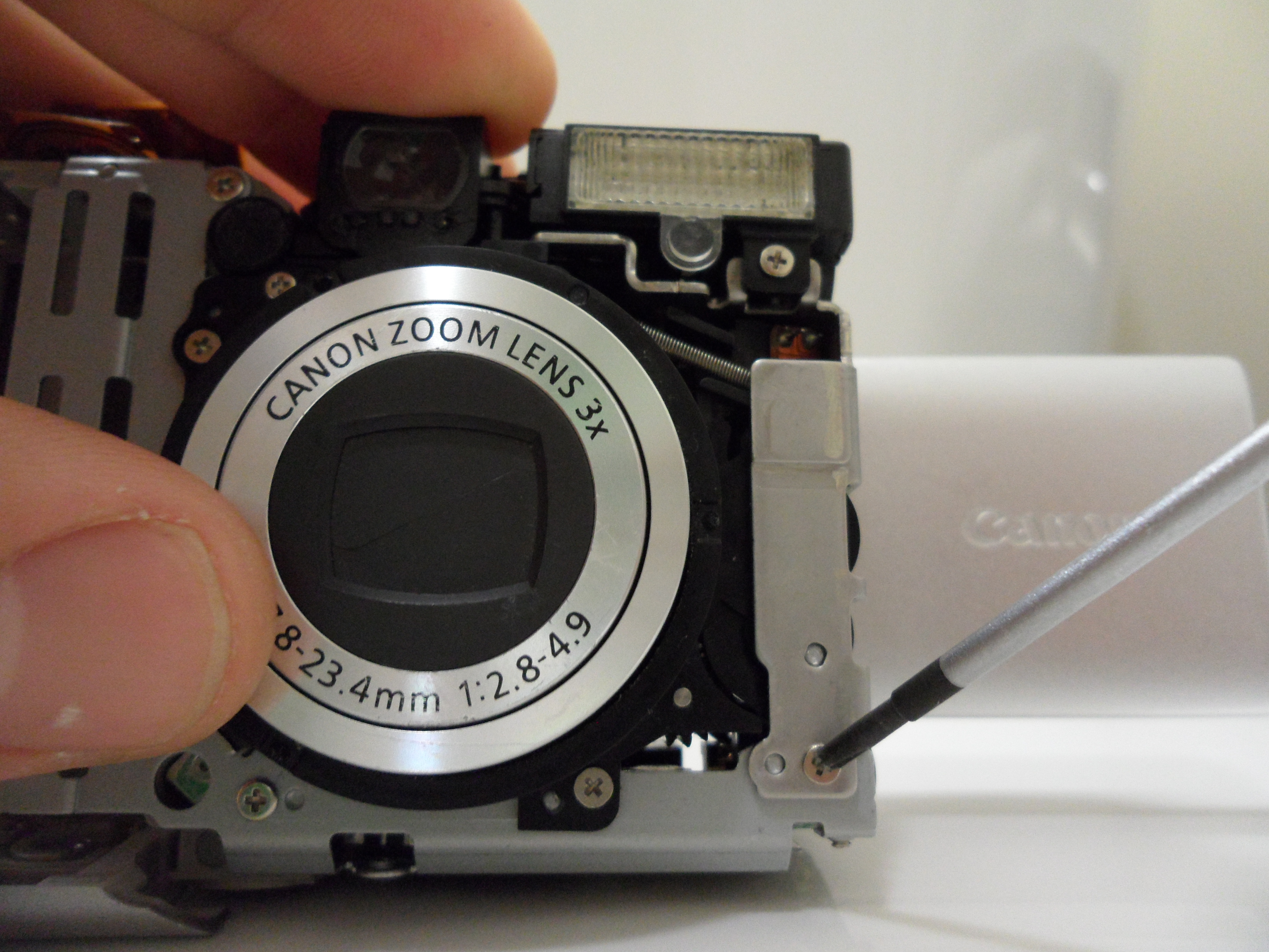

Add Note Edit Step 8 — Front Cover  ¶
  • Now remove the top screw 3.3 mm long on the side of the camera that hold the side panels and the front cover using the #00 screwdriver.
  • Gently remove the side panel of the camera by pulling it away form the camera.
  • The side panel may get stuck on the internal wires, so gently wiggle this panel loose.
