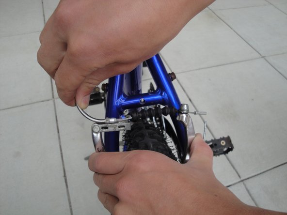

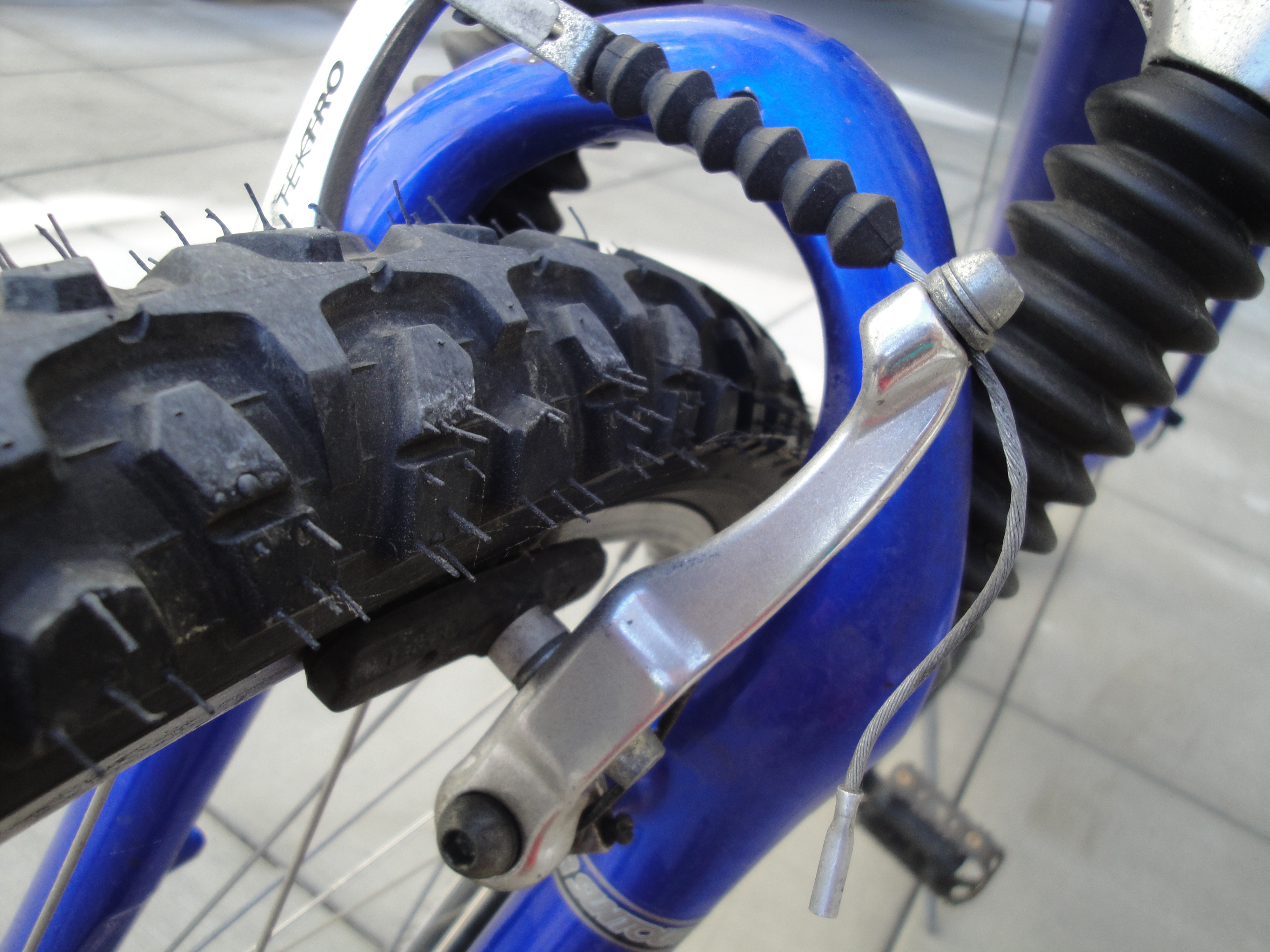

  • Squeeze the calipers together, and remove the brake cable.

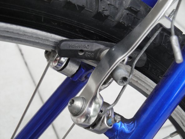

  • Loosen the break caliper bolt, and remove the brake caliper.
Image #1 Image #2
Add Note Edit Step 3  ¶
  • Inspect the brake pad. If the pad has worn down past the “wear line”, then it needs to be replaced.

  • reattach the break cable to the calipers

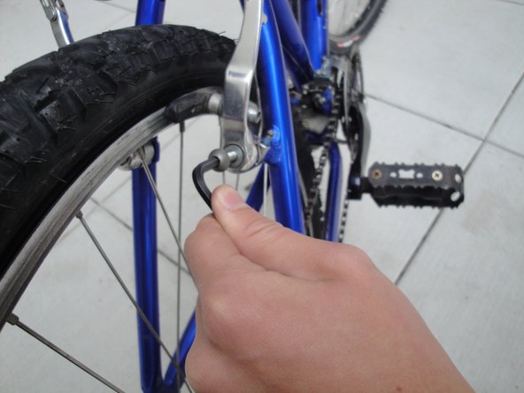

  • Loosen the brake pad bolt.

  • Align the brake pad so that it is flush with the rim, with no part touching the rubber of the tire.

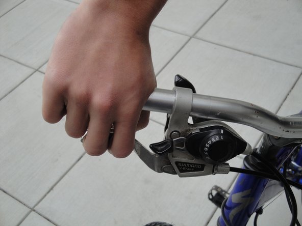

  • Have somebody clamp down very tightly on the brakes.
  • Tighten the brake pad bolt in place.
